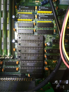

I have this 486 board by PCPartner(part of a VTech Laser 486SX/3). It has four 32-pin cache sockets and two 28-pin TAG/dirty sockets(I am speculating here). I lost the documentation for this machine years ago(and lament it every day), but I have tried various configurations of cache.
Unfortunately I am having trouble getting it working; sometimes when I install cache chips it will hang when loading DOS(specifically, when it tries to load HIMEM). Other times I get corruption on the screen. No matter what configuration I try, the BIOS always shows "256K Cache Enabled"(if it POSTs without error) even though the chips I install aren't always 256K. Other times the POST screen will complain that the cache memory is bad and that I shouldn't enable cache. I installed a set of rare 32-pin sram chips and one of them let out magic smoke and could cook an egg with how hot it got!

megatog615 wrote on 2023-07-06, 15:07:
The board seems hard-wired for a 256K jumper setting possibly, given how other PCPartner boards of the same era were laid out.
The photos on the retro web show jumpers JP21-JP24 which are exactly at the position on the board where I expect cache size jumpers to be.
I genuinely cannot math out the correct chips to order because of how confusing the actual amount of memory they are advertised to handle(256K = 32Kx8??? Okay, so do I need 512K chips rated at 64Kx8 to fill 4 sockets for 256K? What about TAG? Are both the sockets TAG? Or is it a TAG and a dirty socket? What math do I have to do to figure out what to put in those?)
Most likely both sockets are for tag. A 256K configuration on that board would use 4 chips of 64K x 8 for the data memory, and one or two chips at 32K x 8 for tag. Maybe you can leave a socket unpopulated resulting in a smaller cacheable area.

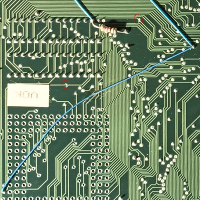

Checking out this board at the workshop we found
U42 (possible tag RAM) assume 62256 pinout -- 80486 address lines

We tried an 8Kx8 in U42 and 32Kx8 in U43 and the system locks up during POST. Various other combinations cause either a hang during POST or a false detection of 256K cache.
Two traces going to the tag write enable pins looked scratched through (the blue wires are from the factory); we asked for advice at the workshop and they thought this was an intentional cut at the factory.
If this image https://theretroweb.com/motherboard/image/35- … b5211517599.jpg is a working configuration, it appears U42, U43, and the data SRAMs are of various types, but it is too blurry to read. It does not appear that it could be integrated comparator tag RAM because MATCH would be hardwired to Vcc. And it doesn't look like relevant x1 SRAM would be 28-pin.
The manual says that using x9 DRAM and x8 SRAM, it is possible to have "Parity checked; must be in WT. Lower performance but better data checking." <-- this suggests there is a way to borrow data bit(s) for use as a cache parity bit instead. If both U42 & U43 are tag RAM, the tag seems unreasonably large (16 bits), looked briefly and did not look like either had obviously unused inputs.
We confirmed based on how the jumpers work that the 32-pin sockets are to support 32Kx9, not 64Kx8 nor 128Kx8. Pin 31 always goes to A16 on the 486; the associated jumpers switch pin 12 between a parity bit vs. A16 to support 28-pin SRAM.
We're giving up on it for now unless something jumps out as super interesting here.

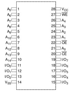

I don't think there is an universal agreed numbering of the address pins of the 62256, but going with a common scheme, this would be pin 6 to Vcc and pin 5 not connected. Strapping pin 6 to Vcc makes sense if you want to reduce a 32K x 8 SRAM to 16K x 8, which is the usual requirement for a tag RAM at 256K cache. On the other hand, having pin 5 open makes no sense at all!. If, OTOH, you mean pin 26 is tied to Vcc and pin 1 is open, this is a correct wiring for an 8K x 8 SRAM. In that case, to make that socket compatible with 32K x 8 SRAM, apply a pull-up or pull-down (resistor or direct connection) to the unconnected pin 1.
Assuming pin 5 is open, this indicates an fault. The fault might be a missing jumper or a broken trace. Having pin 5 open causes random (likely possibly unstable) levels at that pin, that might slowly drift towards a constant 0 or 1 while the system is operating, so this is a possible cause for "works after warm-up" effects. If the open pin is pin 5, the most likely issue would be a missing jumper that toggles pin 8 between Vcc (for 8K x 8 at 128K cache) and A17 (for 256K cache).

Assuming you used the "common" layout of 62256 pins, which has A13 and A14 on pins 1 and 26, plugging an 8K x 8 chip there would not use A4 and A5 for addressing that part of the tag, which would be bad and explain why the system doesn't work at all.
Yes, I agree. They bodged a "new" write-enable circuit and for that to work, they needed to disable the old write-enable circuit. Whoever installed the blue wires also cut the traces.
Sorry about that; I printed a cheat sheet before the workshop and can't remember which 62256 datasheet I pulled a pinout from as a reference, but it is attached. It's indeed pin 26 Vcc and pin 1 open on U42. We put a 8kx8 chip in that socket so we wouldn't have to worry about the non-connected pin. And then U43 does use pin 1 (meaning an 8Kx8 does not belong there, so we tried a 32Kx8), but still has 26 wired to Vcc. Winbond 16Kx8 pinout has pin 1 disconnected, so we know that U43 doesn't take that either (and you've pointed out to us before that 16Kx8 was late to the game, and this is a 1991/1992 era board).

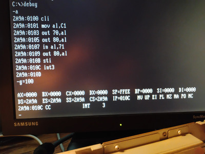

I also had a look at the BIOS cache detection in the BIOS some more. The cache size is detected by reading a 512K block to flush the cache, then reading 32K beyond that (a guaranteed miss) and measuring the number of 8254 ticks elapsed. Then the code proceeds go downward in memory to read additional 32KB blocks, measuring the number of 8254 ticks elapsed. If the absolute value of the difference between those ticks and the reference "guaranteed value" is more than 511 ticks (428 microseconds by my calculation), the current 32KB block was now a miss instead of a hit, and the cache size has been determined. The code then proceeds to do another check to confirm that the data RAM is working. If the data RAM check fails, there is no option to shrink the detected size of the cache to match that, the cache is declared faulty. In addition, the cache size is stored in a CMOS register only and doesn't affect the chipset registers, nor is there a way to reallocate address lines between tag data lines and address lines as in more sophisticated chipsets. I thought about whether the spurious detections of 256KB cache could have anything to do with having an internal clock multiplier faster than was anticipated when the BIOS was written, or the internal cache being 16KB, or increasing the bus from 25MHz to 33MHz (which the OP has done also), all of which would change this timing somewhat. He did temporarily take out the Am5x86 and restore the onboard 486SX but it still detected the spurious 256K.
    18.97 KiB
    469 views

As we've found pin 1 of one socket to go to A12, there must be a difference in how the boards are wired, as it seems impossible to put an 8Kx8 into U43 as it wouldn't see A12. Maybe the blurry picture I linked before also was a difference board version, or had different or additional bodge wires (given that the cache area is already suspect with bodges, anything goes).
The bodges you showed seem to send a modified /WE signal to the tag RAMs, while still sending the original /WE signal somewhere else. It shouldn't affect address routing. We have this strange extra connection into U43 on pin 10 (the one next to the data pin typically called D0), which may be another address bit (assuming 32K x 8 is the correct assumption), or another control signal. As all the other address bits match the location of the 62256 pinout, a x4 or x1 chip wouldn't make sense. But, what if there were 8Kx9 chips? I found a datasheet for 32Kx9 chips, the Motorola MCM6205D, which has a pinout matching what you observed on the data sockets, and would you look at this!, the Fujitsu MB81C79A is a perfect match to what you observe on U43, albeit this specific chip is quite slow. Further research showed a firmware update for the retro chip tester pro, which mentions these chip numbers for 8K x 9: P4C163, CY7C182, IMS1695, IDT7189, M5M5179, uPD4369, TMM2089. I randomly picked one of those numbers, and again got the same pinout. That's very likely the solution to the tag mystery.
In this picture: https://theretroweb.com/motherboard/image/35- … b5211517599.jpg U43 definitely could be MCM or M5M something, it's just super hard to read. Thanks for the catch, now those resistance values (it did say ohms) on pin 10 make sense if it's really a data pin, and that's why it goes to the chipset rather than the CPU.

EDIT: Oh yeah, jakethompson1 told me to run this in debug(cache memory bad message disables external cache):
I have a board with the same chipset with 128KB cache installed. According to the chipset documention that is the maximum. (See the documentation for for this board: https://theretroweb.com/motherboards/s/pcpart … 9b-c0044-1#docs)
Anyway here is a picture of the cache on my board:
    1.28 MiB
    295 views

Dorunkāku wrote on 2025-05-01, 21:53:
Nice.
We're 99% confident ruling out a 6164 chip in the upper tag socket on his board, because of the pinout going to it.
Given all the factory bodge wires on the back, I would not be surprised if there are various revisions and bodges within revisions to change the pinouts around.
