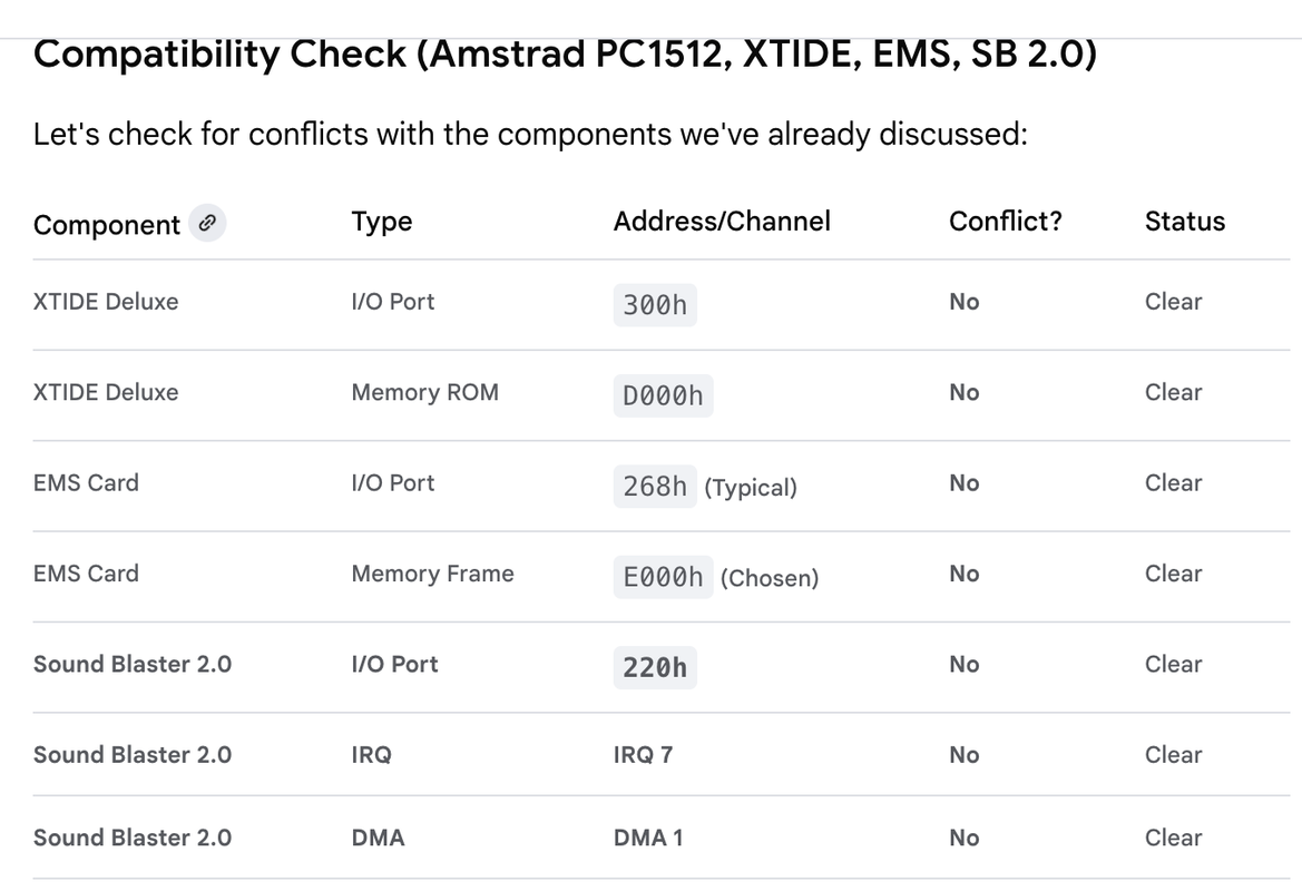

No. Upper memory is the memory available to DOS between 640k and 1024k. EMS memory is extra memory that is outside main memory but gets mapped into a piece of the first 1MB of memory. BTW, I don't like your setup's used memory. I ask you for your config files and can recommend you use the CTMOUSE driver available at https://dosprograms.info.tt/indexall.htm under the Utilities section. It is much smaller than the Microsoft mouse driver.
Hmm... I'm afraid I'm a bit out of my depth. So where is the EMS memory mapped? I actually don't have a mouse. I don't intend to use a mouse for the sequencing software, though I'm sure I will later. I've only been able to locate that mouse adapter from that guy in Greece. Here is my config file:
https://postimg.cc/f3fsrJ9y
Normally, EMS lives at D000-DFFF, or E000-EFFF.
On an XT, there is usually 'NOTHING AT ALL' attached to the memory bus at those addresses.
BECAUSE you have an XTIDE installed, the XUB will be living at one of them. Whichever is in use, the EMS card should be configured at the other.
D000 and E000 are both 'well above' the top of the base 640k, which ends at AFFF, iirc.

Gotcha. My XUB is @ D0000h. From reading just now, I think an EMS on my machine would be mapped @ E000h and ported at 286h
