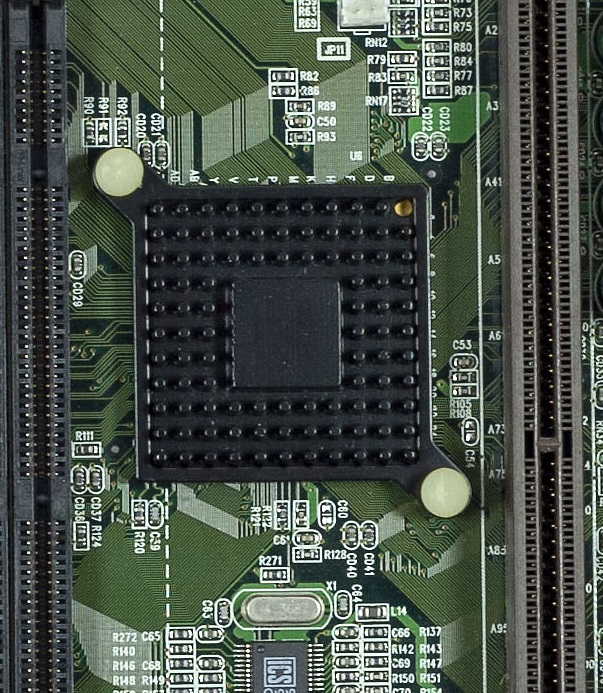

Due to the lack of information about this motherboard on a scale I have never encountered before, I want to create a thread that will collect information in one place. This copy was tested quite briefly due to lack of time. Moreover, this is the first mobo I have ever used for which I cannot find a manual.
I received it without heatsink on northbridge, I had to match it with some from my own scrap. The one that fit was the one with the fan, and the fan fit into the "JP11" connector next to the northbridge. When turned on, the fan did not rotate. Measurements with a multimeter showed that it is probably not the fan connector - the polarity is reversed and the voltage is 5V instead of 12.

2: What is the JP11 connector next to northbridge for?

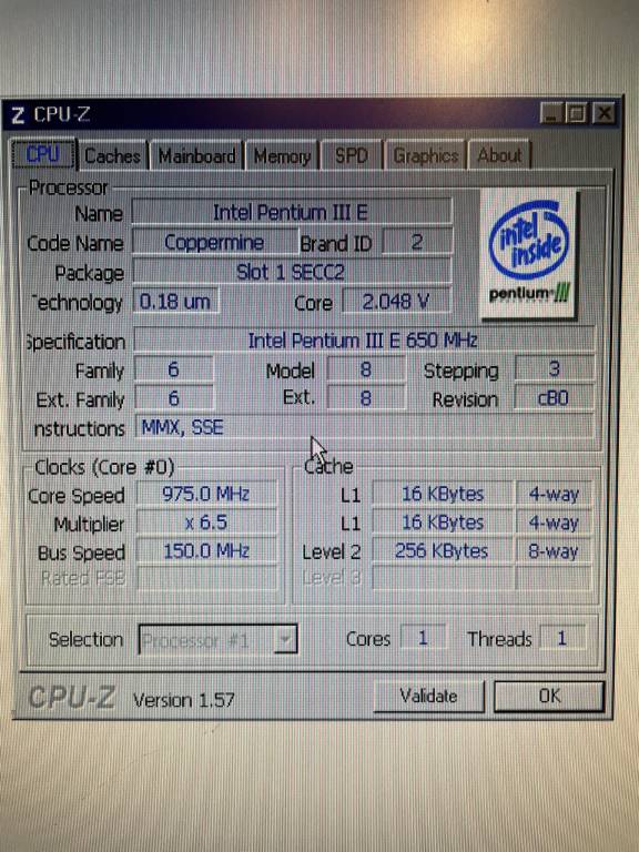

Apart from retroweb, I did not find any confirmation that the ATC-6400 is the same board. The manual does not say anything about the JP11 connector and says that the board only supports Pentium II.
The board correctly recognizes the Pentium III Katmai 550. The Coppermine on modded PPGA adapter also works, but it does not start after changing the FSB from 66 to 100.
That looks like a connector for a thermistor (for measuring cpu temp)

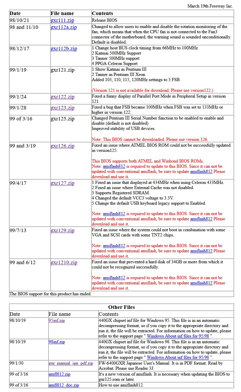

Someone could say this is obvious, but it wasn’t obvious to me. A certain Japanese website mentions two versions of this motherboard — FW6400GX and FW6400GXR — and they are not the same.
  • The FW6400GX has a green PCB, while the FW6400GXR has a red PCB (on red motherboard there is still 6400GX marking on silkscreen, which is misleading).
  • The FW6400GXR is identical to the ATC-6400, and the BIOS from the ATC6400 works on the FW6400GXR (by the way, has anyone ever actually seen an ATC-6400?).
  • All BIOS images on RetroWeb are for the green GX board, and flashing them onto a GXR will brick it.
  • The non-working USB keyboard is a BIOS issue — flashing the ATC BIOS ROM or the GXR 129 ROM makes the keyboard work in the BIOS. I am attaching the GXR 129 ROM here, because it is hard to find; it’s not even available on the Internet Archive. The ROM for the ATC6400 is easy to find, but the FREEWAY logo disappears during POST.
ROM 129 is the newest version my friend managed to find. Below is an changelog. As you can see, there is an even newer BIOS that adds support for newer hard drives. There is also a mention of a manual file in Japanese; it appears that an English-language manual never existed. This manual could explain what the JP11 header is used for. It is not a thermistor connector — that role is served by the RT1 header.

By the way - looks like FSB150 works
