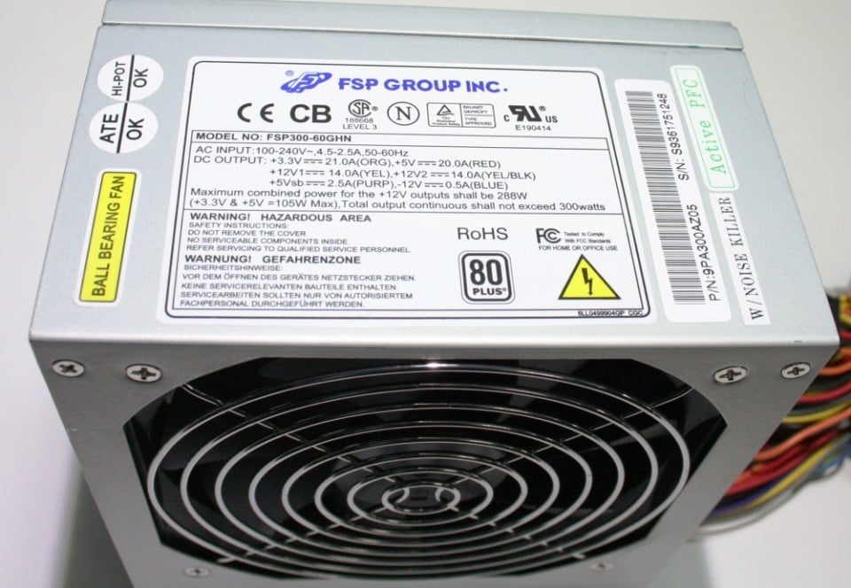

Reply 23 of 32, by douglar
Trying to think outside the box on this one. The fact that the drives don’t show as in compatibility mode suggests that windows doesn’t see any int13h, ATA, or geometry issues when your system boots. Those are the usual suspects.
Sounds like your system is stable when not doing disk IO, but acts up when copying large files between two drives and when working with large 7200rpm drives.
I’m going to assume you ran scandisk recently.
Do your file copy issues only show up in windows or do they happen in DOS? Boot in DOS mode and try copying the files if you can. If the file copy issues don’t happen in DOS, it could be borderline system memory that acts up on extended DMA transfers, since you are likely only using UDMA in Windows. edit, I guess I should ask if you enabled DMA in win98 or not. Usually that’s something you have to turn on after installing. https://www.philscomputerlab.com/windows-98-dma-mode.html
Maybe your power supply has a weak 5v rail and heavy disk load is too much for it to handle. What power supply are you using? Some newer ATX power supplies have weak 5v rails compared to what was common in the Pentium II days, since newer systems don’t require as much power on that line. You likely need 20amps on the 5v line for this system.
Reply 24 of 32, by DustyShinigami
douglar wrote on Yesterday, 20:02:
Trying to think outside the box on this one. The fact that the drives don’t show as in compatibility mode suggests that windows […]
I thought I had DMA enabled, but apparently not. However, for the E (and F) drive, there's no option for it. I'm guessing because it's hooked to the RAID controller...? And the F drive is connected to the HPT controller.
And yep, ScanDisks have been run. It found and fixed some errors at one point. Just ran them again, too.
Thanks for the suggestion about file transferring in DOS. I'll give that a go and see what happens.
Save having to disconnect and get it out of the case to see the label, I only know from the eBay purchase name that it's an FSP300-60GHN ATX 300W 80 PLUS BRONZE. So I think it's some cheap make...? I think it's this one:
I remember reading somewhere I'd need at least 20A for my setup.
