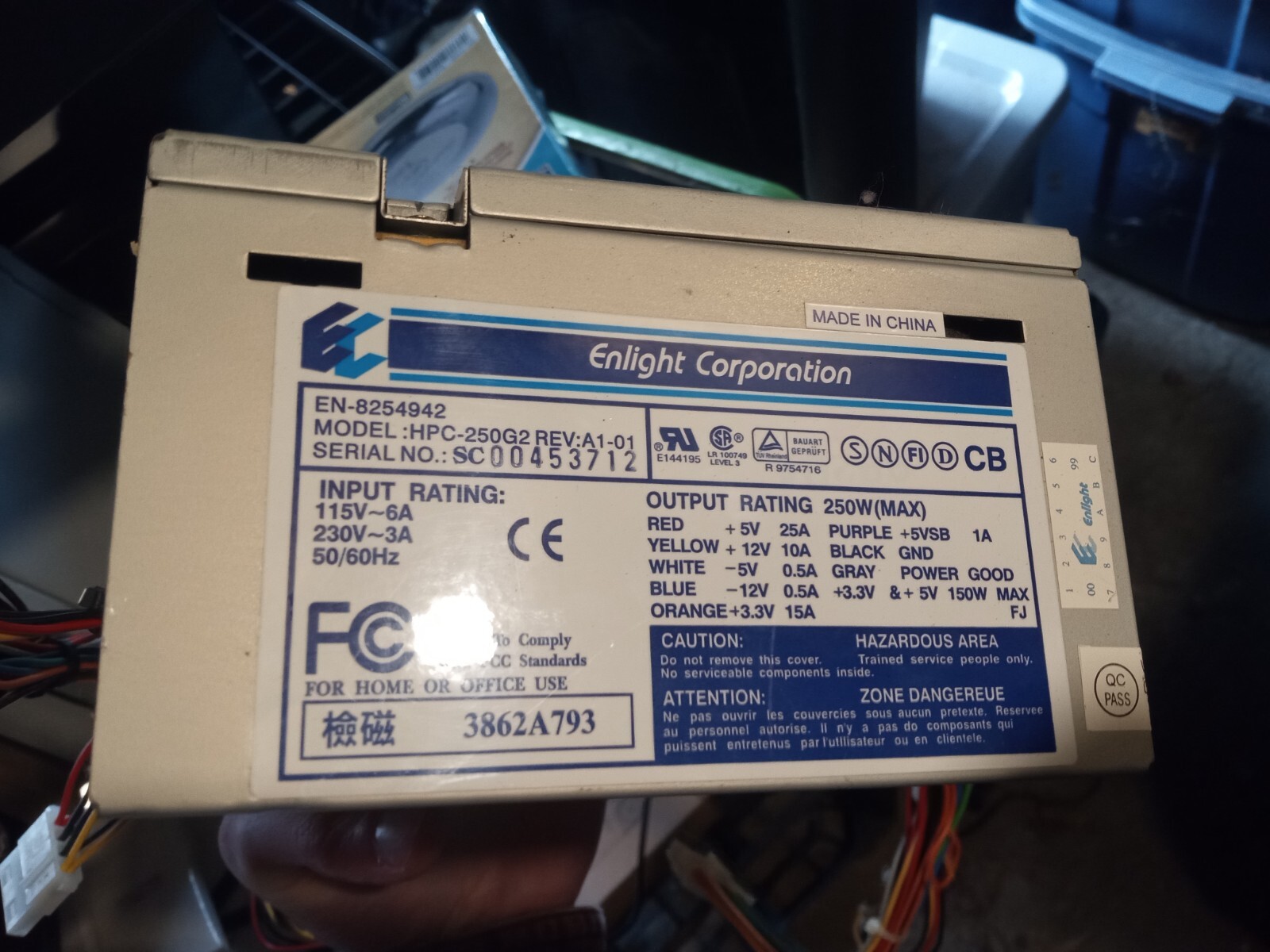

Reply 5 of 21, by shevalier
Mike_ wrote on 2026-04-22, 15:49:
I guess something like RM550x should be fine? RMx series apparently has 25A on 5V line.
It will most likely work.
It’s just a bit of a problem.
It’s specified as
5V 25A
3.3V 25A
5V + 3.3V – but a total of no more than 120 watts.
In other words, something like 5V/12A + 3.3V/18A
In those days, graphics cards and RAM were mainly powered by the 3.3V rail.
In other words, it is inferior to the decent quality 250-watt models of that era.
Photo from eBay
Photo from eBay
It would take a long time and be rather tedious to explain, but if the power supply unit’s specifications mention an ‘A(ctive) PFC’, there’s a 99% chance it won’t be very suitable.
It was at that very moment that the topology and power distribution across the rails changed radically.
Aopen MX3S, PIII-S Tualatin 1133, Radeon 9800Pro@XT BIOS, Audigy 4 SB0610
JetWay K8T8AS, Athlon DH-E6 3000+, Radeon HD2600Pro AGP, Audigy 2 Value SB0400
Gigabyte Ga-k8n51gmf, Turion64 ML-30@2.2GHz , Radeon X800GTO PL16, Diamond monster sound MX300

A brief history of power supply units.
- Initially, there were AT units, which contained a lot of copper and diodes on the +5V rail
- With the introduction of ATX standart, some of the copper was diverted from 5V to the +3.3V rail and diodes were added for this rail
- With the introduction of the 4-pin connector for the Pentium 4, further copper was diverted to the +12V rail
- With the advent of the 6-pin (later 8-pin) connector for graphics cards, some of the diodes were removed from the 3.3V and 5V rails and used to install additional diodes on the +12V rail
___________ This is where the APFC comes in (because modern PSUs with a power rating of over 500W are not manufactured without an APFC
- Modern PSU. A single +12V bus, with the +3.3V and 5V lines derived from it via separate converters. These may be located in rather unusual places, as modern systems have low power consumption on these lines and do not require special cooling.
And the temperature sensor monitors the 12V line.
Under a load of 150 W, the main power rail (+12 V) won’t even break a sweat, and the fan won’t kick in. Yet the converters are already overloaded.
The question is which of today’s power supplies can operate in this mode for an extended period — it is precisely these non-standard tests that need to be carried out.
That is why no one can guarantee anything.
Chinese OEMs from local brands for $20.
No one knows anything about them at all. The only thing that can be said for certain is that they are available for purchase.
Given that they lack an APFC, they are probably from the ‘Pentium 4’ era or the ‘early 6-pin graphics card’ era, i.e. more promising for retro setups.
But nobody knows where they cut corners or what they left out.
