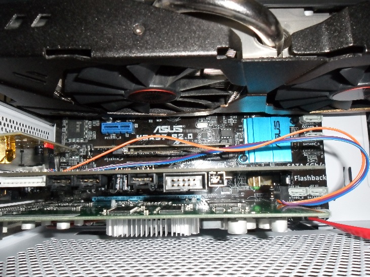

Arrived and working in DOS 6.22 with VSBHDA, Windows 98 and XP.
As expected, the wires aren't long enough to route it behind the Audigy card, I've had to remove my PCI GPU for now. What are these wires called so I can get some longer ones?

AaronS wrote on 2026-05-06, 15:57:
Arrived and working in DOS 6.22 with VSBHDA, Windows 98 and XP. […]
bls dupont Female to Female cable
https://www.amazon.com.au/uxcell-30CM-Length- … r/dp/B007Q84AUU
https://www.amazon.com.au/uxcell-Jumper-Femal … /dp/B08MZPJFMR/
https://www.amazon.com.au/RLECS-Dupont-7-9inc … r/dp/B0DGGCM12Z
https://www.amazon.com.au/ZYAMY-Dupont-Connec … d/dp/B0789F523N

Reply 10 of 13, by ott
I'm not sure if I can provide Amazon links, but the best solution is probably to get 10-Pin (2x5) IDC ribbon cable, the extension version.
FC-10P connector has low height (unlike Dupont) and doesn't block the installation of long cards, which can be important.
The attachment 51olVkCHsPL._SL1082_.jpg is no longer available
If you have soldering experience, you can make your own cable from the motherboard COM port cable, following the pinout of both devices.
The attachment fc-10p.jpg is no longer available

Reply 13 of 13, by AaronS
Yep all good, 5x2 to 1x4. No longer putting any pressure on those pins.
