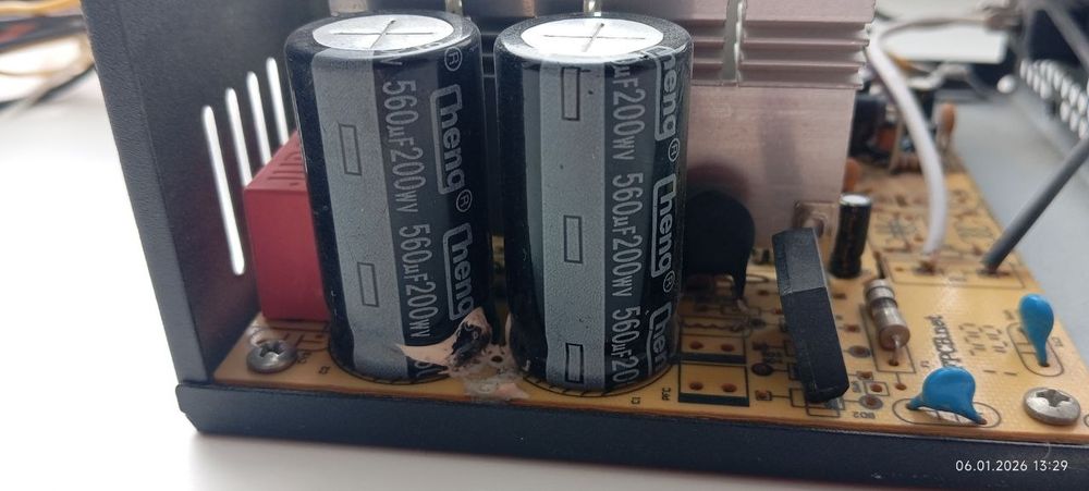

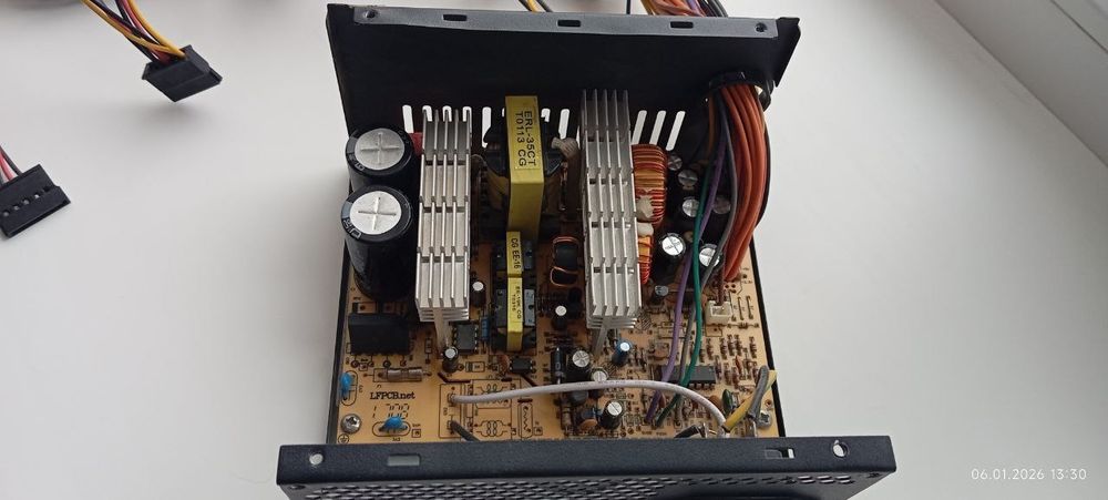

To be honest, I don’t know where you can even find a ‘proper’ PSU in good working order these days.
From my collection at home
- Enlight 250W - 25 years old
- FSP 400-pnr + Chieftec 350Watt - 20 years old
- Hipro HP-D5201aw - 15 years old.
The capacitors in the secondary circuits have all failed, and in the case of the Hipro 520W – the very first one, whilst it was still in active use with the Phenom 2 X6.
