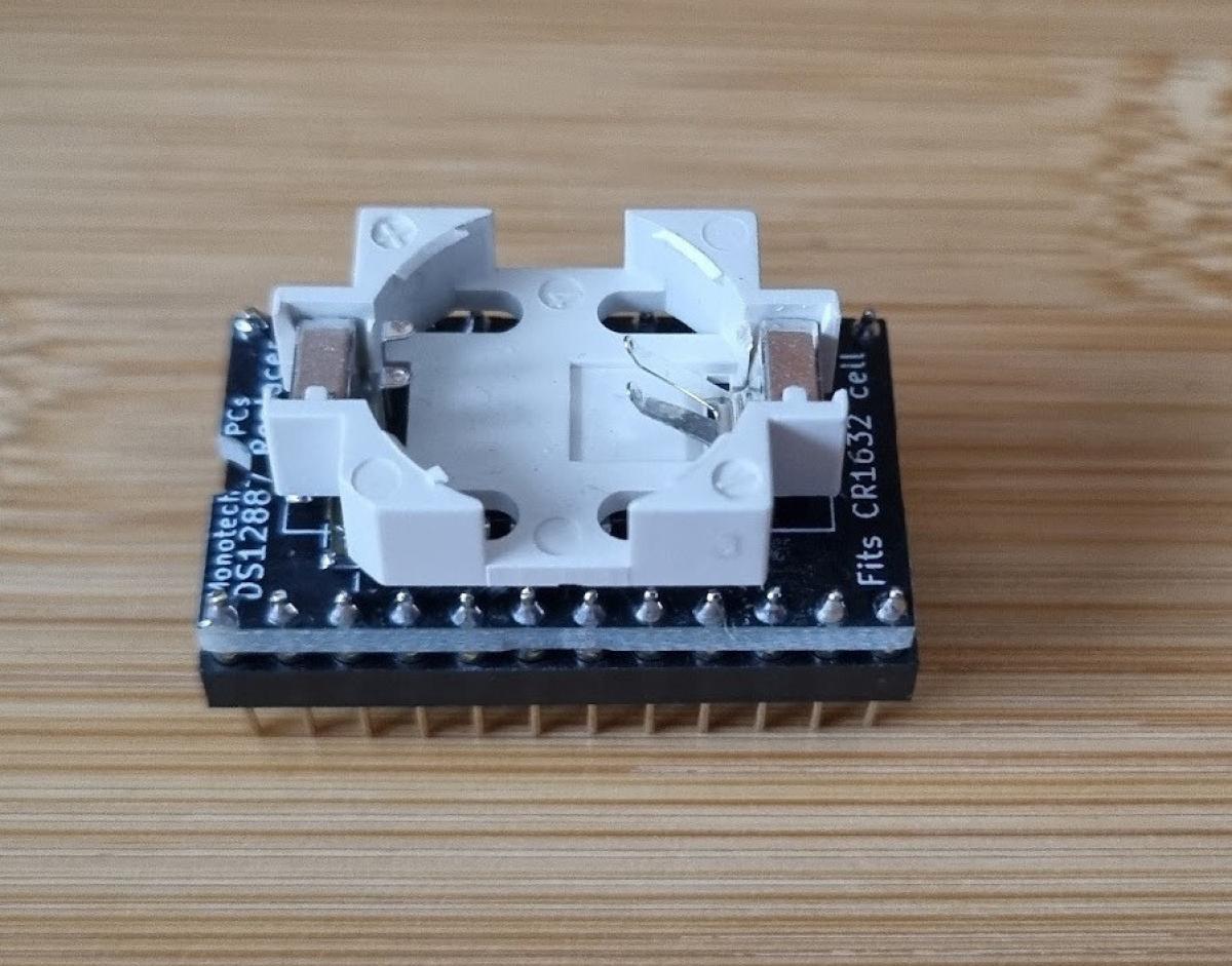

The DALLAS chip has already been drilled, so I can easily fit a coin cell holder to it. Its current battery voltage is sitting at 2.9v, which could be part of the problem! (I just need to get the part.)

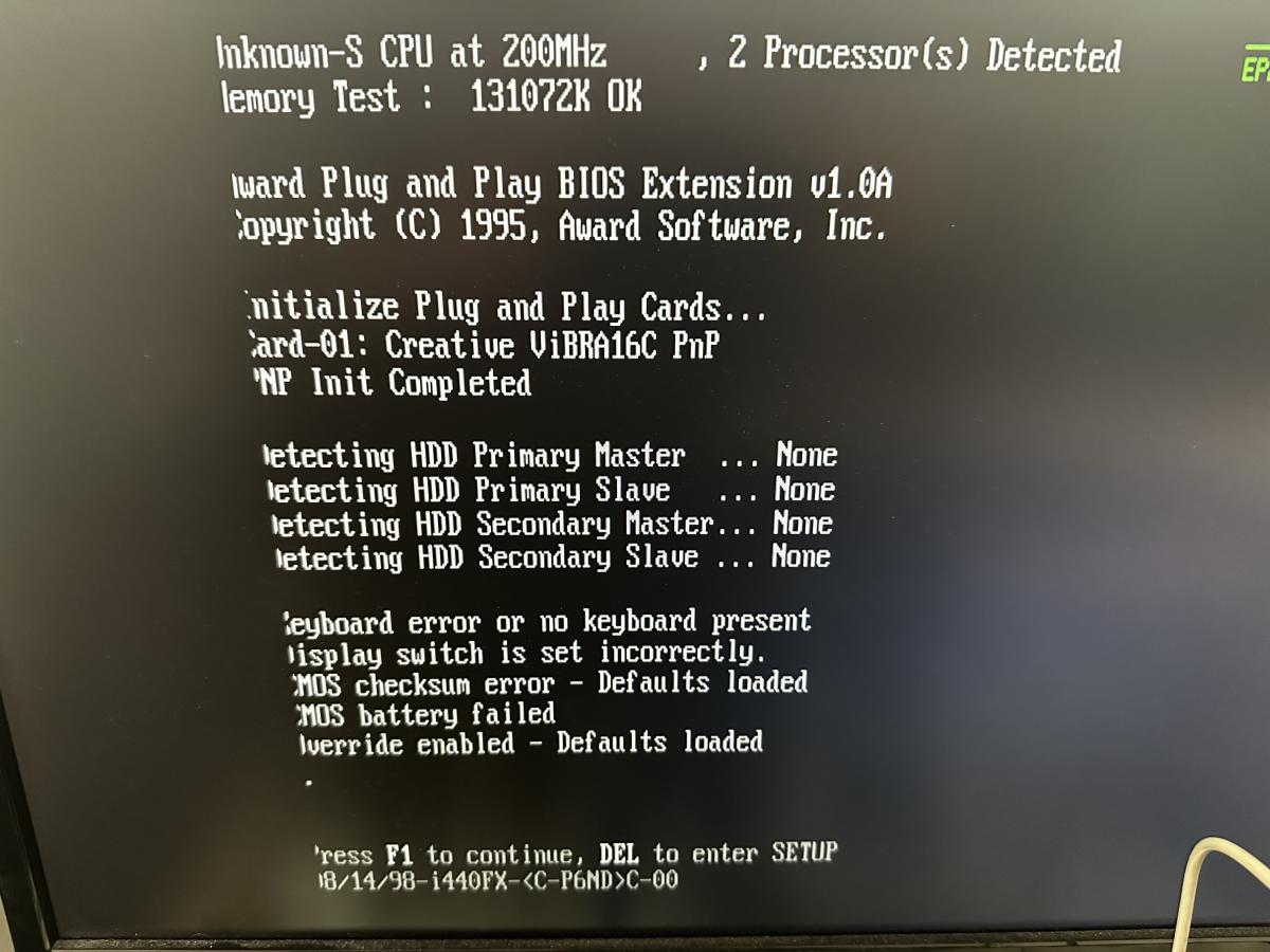

Reply 222 of 225, by maxtherabbit
What exactly is the post problem again? Does it only post "sometimes"?

Reply 224 of 225, by maxtherabbit

Is it basically random, like it would work one minute and then not the next without you even touching anything inside the case?
That's correct!
I think that the DALLAS Chip may be part of the problem, as the CMOS is not resetting with the CMOS reset jumper and I've had issues saving settings to the CMOS.
On one of the Boot Cycles I got this message:
Even with this message concerning the keyboard, the keyboard was connected and working correctly. (The next successful boot did not show this message.)
This kind of points to the DALLAS Chip
On Monday I'm going to purchase one of these replacement chips from a seller in New Zealand:
This should eliminate the DALLAS Chip as a possibility.
I'm going to get this thing DHL Express'd to me! (The Shipping's going to cost twice as much as the item, but I don't have the stomach for the snail mail at this time!)
