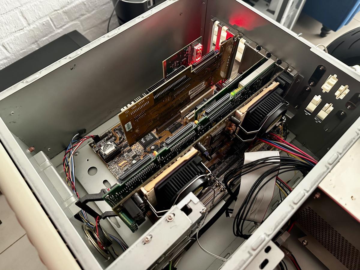

I’ve made some headway on my Dual Pentium Pro. I now have the Matrox Millennium G450 (2000) as well as the ICP SCSI card running in the system without any IRQ conflicts.
The Matrox Millennium G450 (2000) will at least enable me to get XP onto this thing with driver support!
I still need to sort out the POST problem.
The DALLAS chip has already been drilled, so I can easily fit a coin cell holder to it. Its current battery voltage is sitting at 2.9v, which could be part of the problem! (I just need to get the part.)

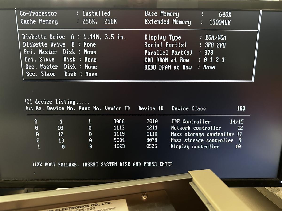

I think that the DALLAS Chip may be part of the problem, as the CMOS is not resetting with the CMOS reset jumper and I've had issues saving settings to the CMOS.
On one of the Boot Cycles I got this message:
Even with this message concerning the keyboard, the keyboard was connected and working correctly. (The next successful boot did not show this message.)
This kind of points to the DALLAS Chip

Yes if the RTC chip is making intermittent contact in the socket it would do exactly what you are experiencing. In fact I've had the same thing happen to me, on a pentium pro board no less.
The clear CMOS jumper could be a red herring though, as some models of dallas chips and clones don't connect that pin at all
