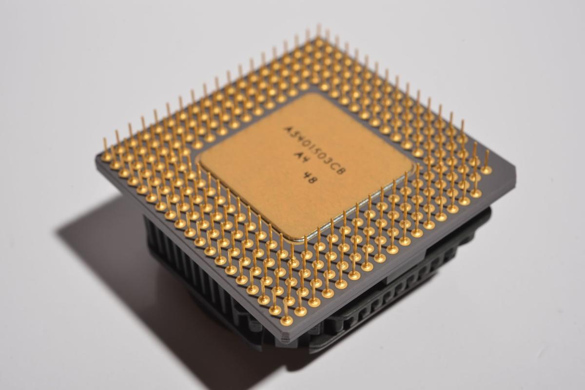

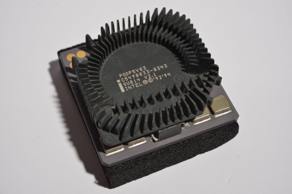

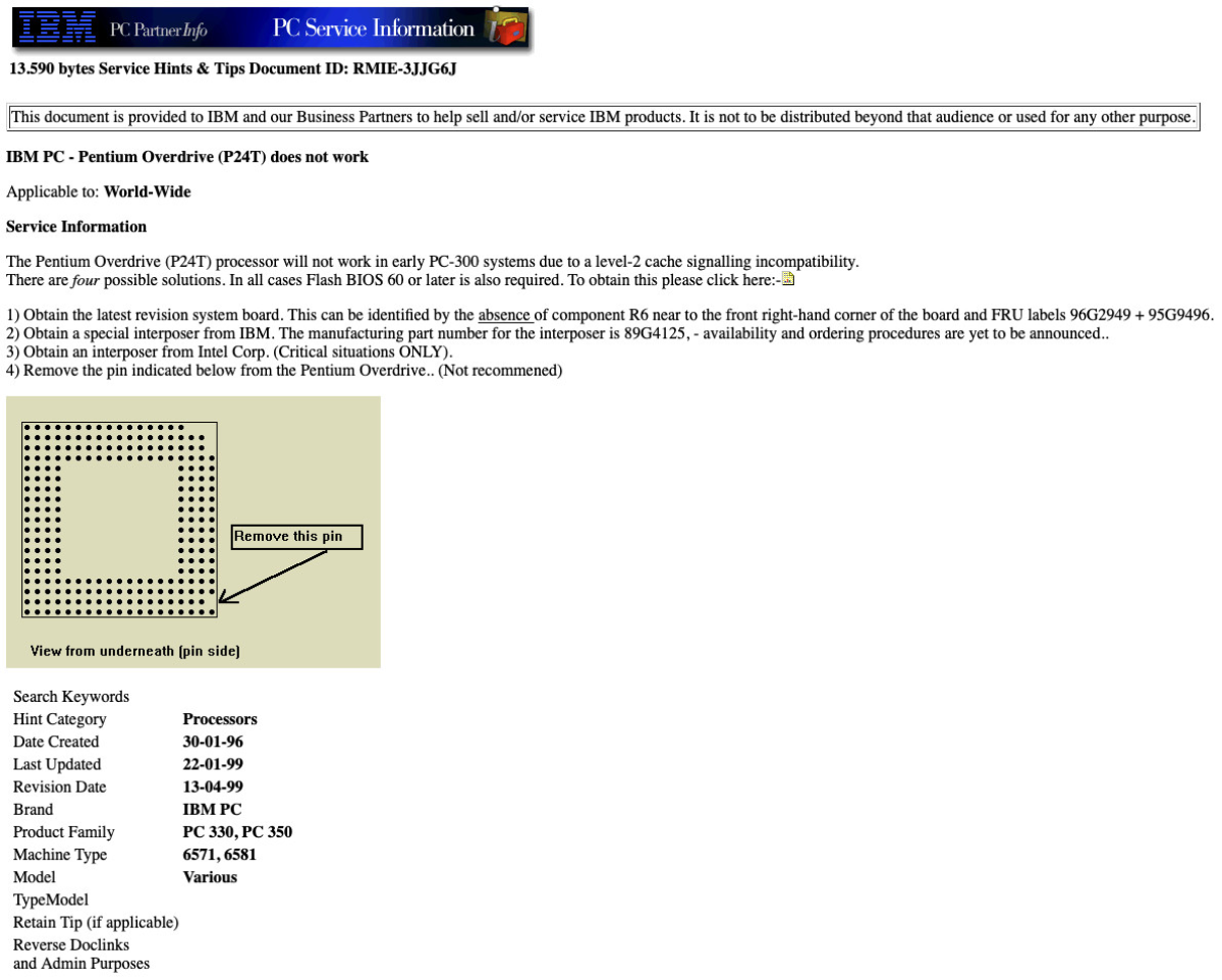

Reply 77 of 77, by Irinikus

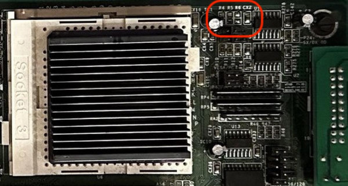

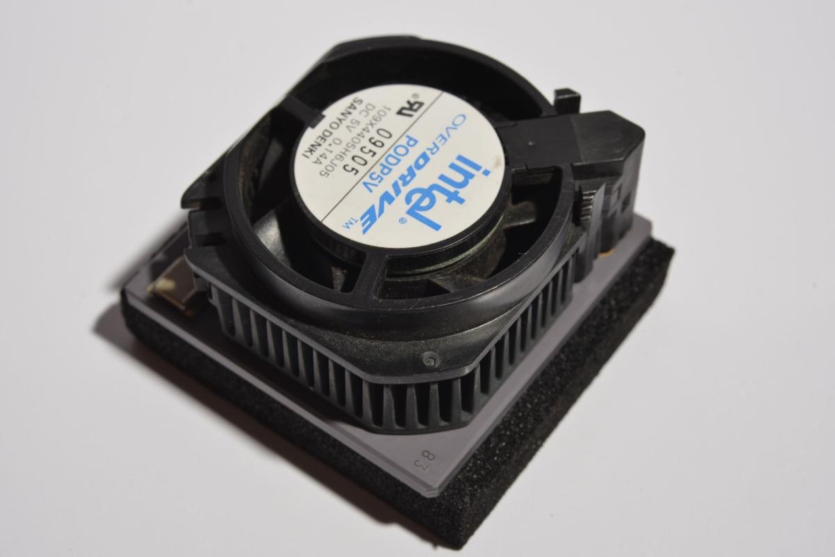

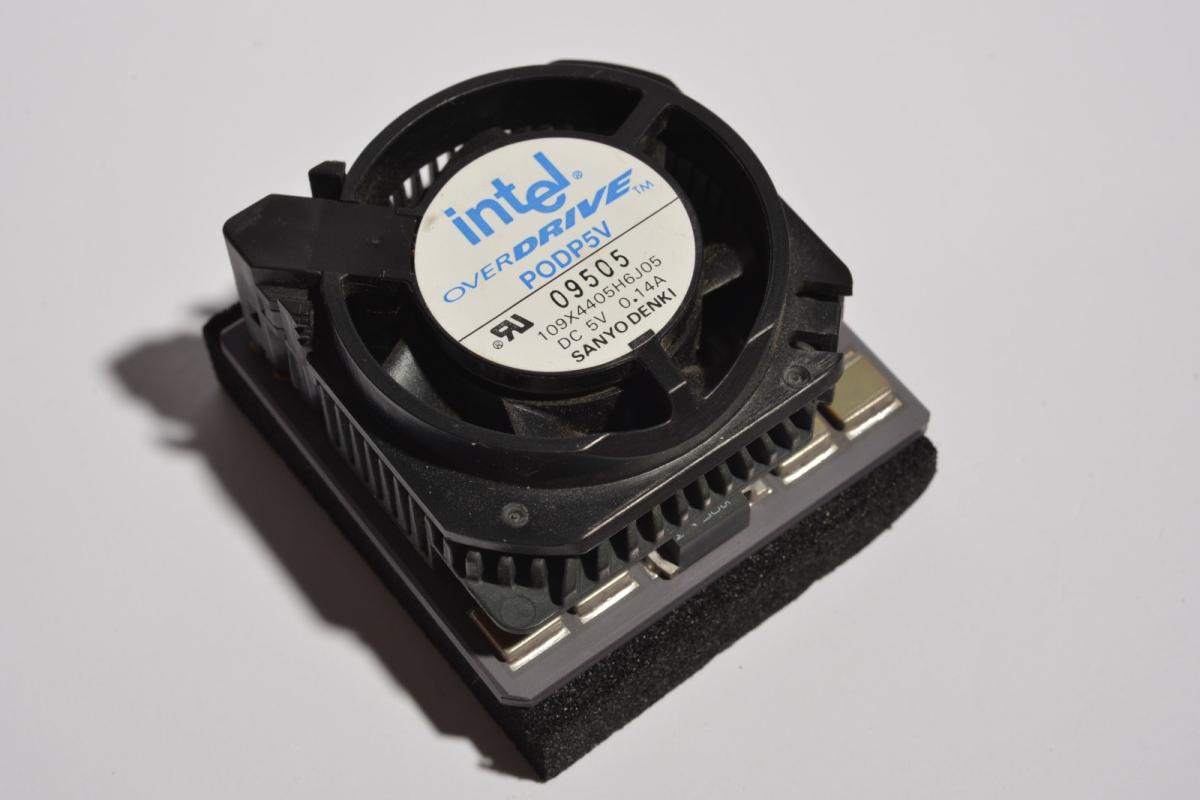

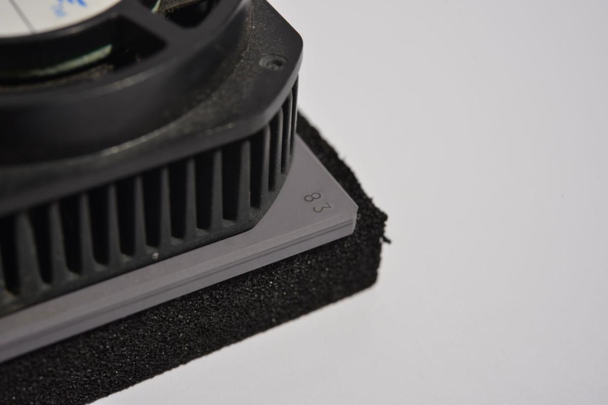

I just purchased this Pentium Overdrive for my 486:
There was an issue with earlier versions of my motherboard which made a connection to one of the reserved pins on the Pentium Overdrive, requiring an interposer to make it work.
My MotherBoard appears to be one of the more modern ones (Missing R6), so the Overdrive should just slot in! (I will need to remove the VRM from the MotherBoard of course and place a set of jumpers in its place.)

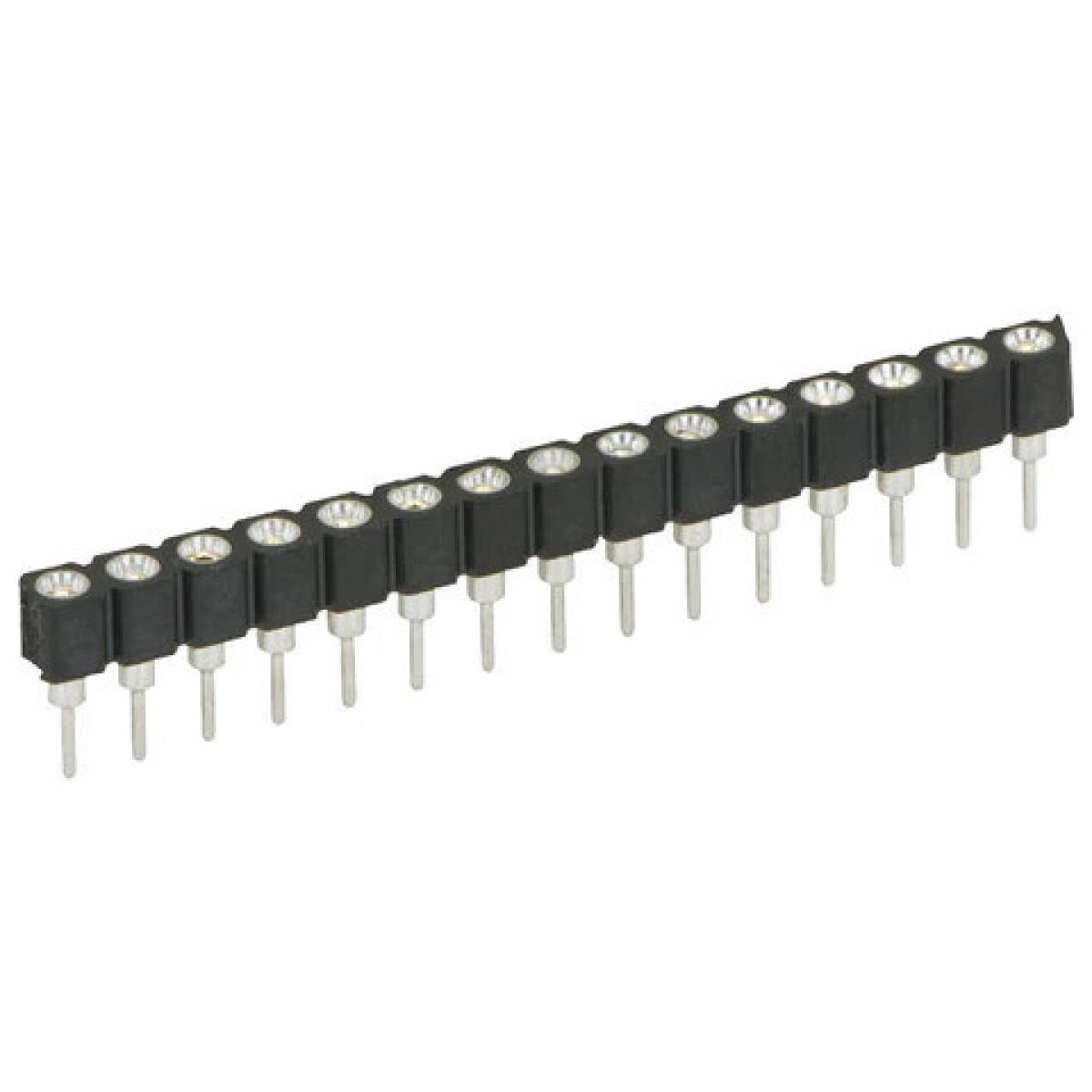

If worst comes to worst, I'll just make use of tulip connectors to make up my own interposer to elevate the chip in the ZIF socket and effectively disconnect the affected pin shown in the graphic. (Without having to remove it)

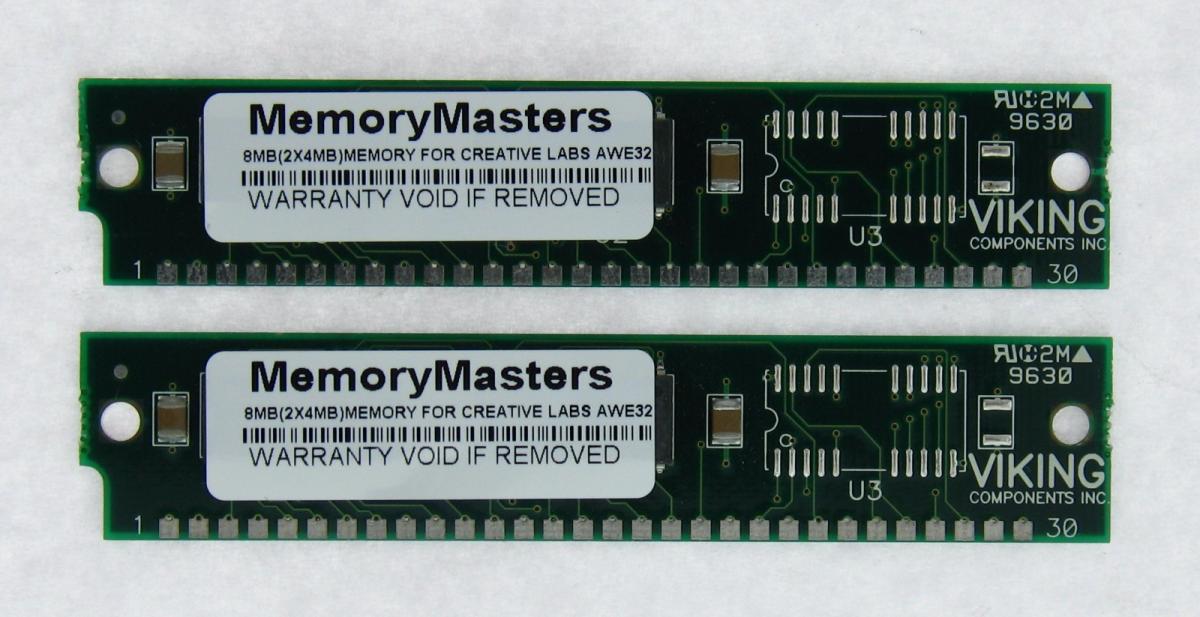

Ive also just purchased the following memory modules for the system:
2x4MB 8MB 30pin SIMMs RAM MEMORY non-parity 4x8 for Creative Labs AWE32 (Which is compatible with the Gravis Ultrasound PnP)
4x 32MB FPM 8Mx36 Parity 72-pin RAM SIMM 128MB 60ns Fast Page Memory
