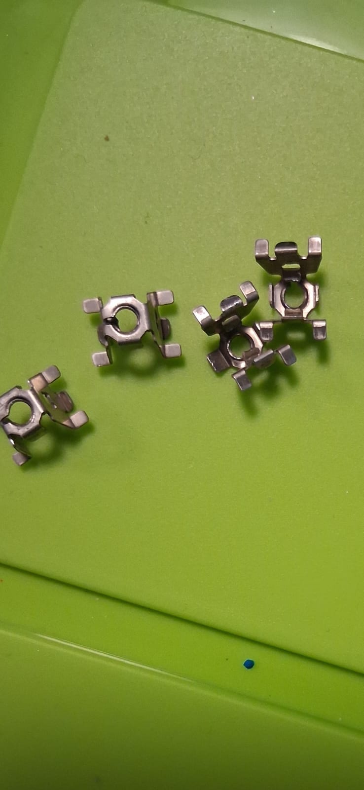

Targa Gehäuse/Case
Looking for these Mountings!
Any Help appriciated. There is no way to put anything different inside as far as i know
Would love to use my old targa case as rebuild it!
Thank you!

It's these small, insignificant parts that always stop you dead in your tracks. Those standoffs doesn't look too hard to replicate, you may try first making a flat stencil on a thin sheet of metal, fold it by the original shape and if everything fits, transfer it to a thicker spring steel sheet.
Reply 2 of 3, by Repo Man11
Those were popular with case manufacturers for a few years, then they were gone. Lian Li used them, the Elan Vital case I had used them. You might end up buying/scrounging another case from that period to find some, I know that past searches for those haven't turned up any easy replacements.

Repo Man11 wrote on Today, 16:56:
I think the ones you're referring to fit in a square hole, these seem to be made for a rectangular hole.
I was also at first thinking about the square ones, and looking at the example and the rectangular punchouts in the case, realized these are different.
