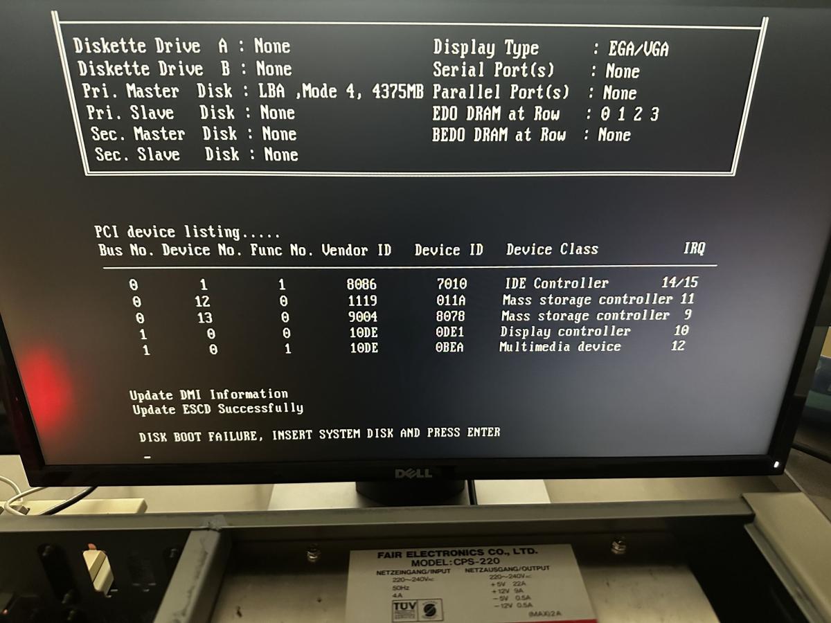

Reply 252 of 255, by Irinikus
It detects it!!! 😀
Well, now I’m going to need to get my hands on another identical drive!

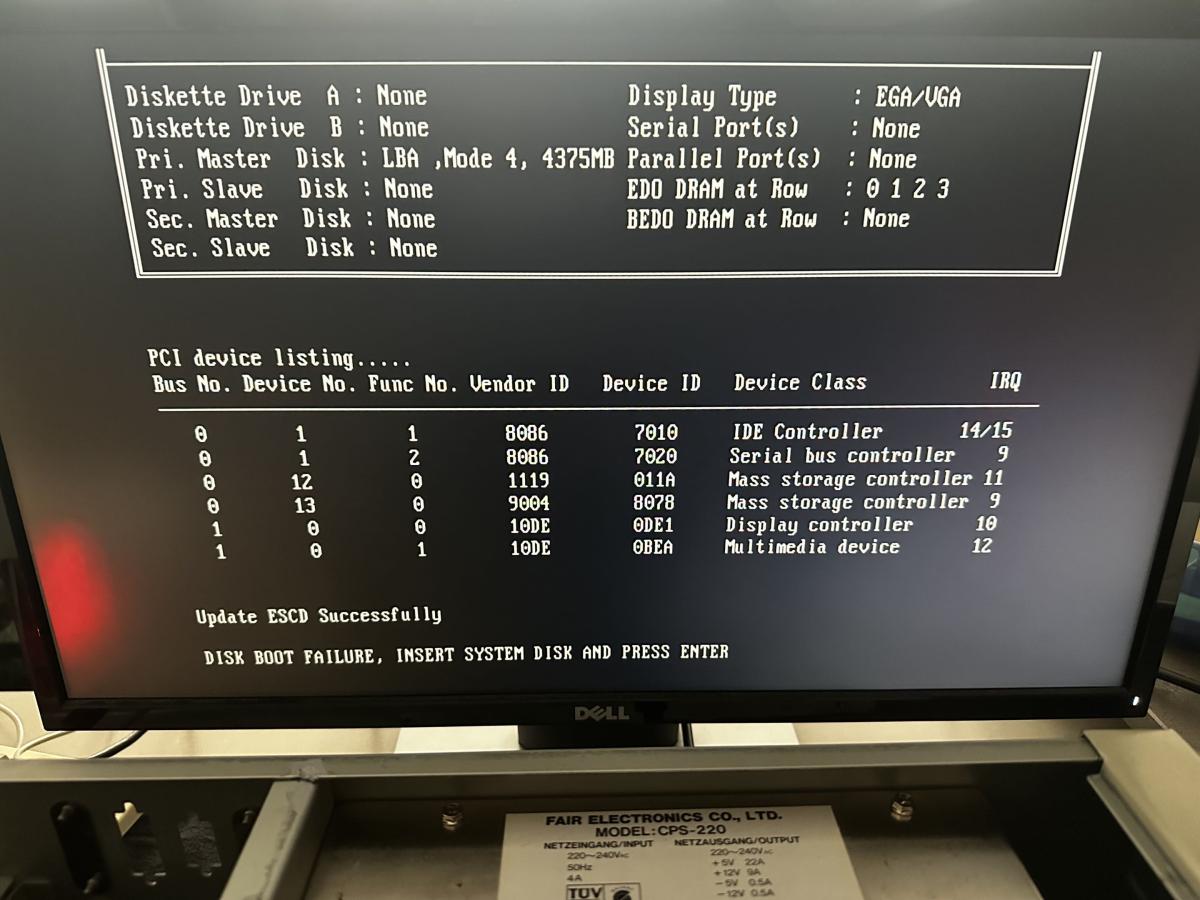

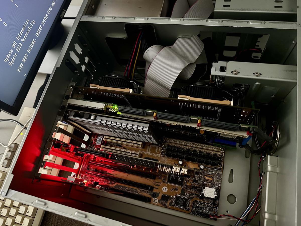

Since I now have the latest BIOS installed on this motherboard, I’ve successfully been able to slot the ZOTAC GT 430 PCI (The most powerful PCI graphics card in existence.)
It looks like Ive used up all of the available IRQ's for the PCI slots, as the GT 430 takes up two IRQ's. I therefore won't be able to slot the USB 2 card in the adjacent slot. The ISA network card should work, as there are a set of IRQ's reserved for the ISA slots. So I'll have to use the onboard USB!
So out with the Matrox G450!
This machine now has no excuse but to perform as well as possible!

Reply 254 of 255, by Irinikus
The Onboard USB conflicts with the Adaptec SCSI controller on the Media Bus card, which I'm going to use to run the SCSI DVD and CD-ROM's.
Will IRQ sharing work in this case?

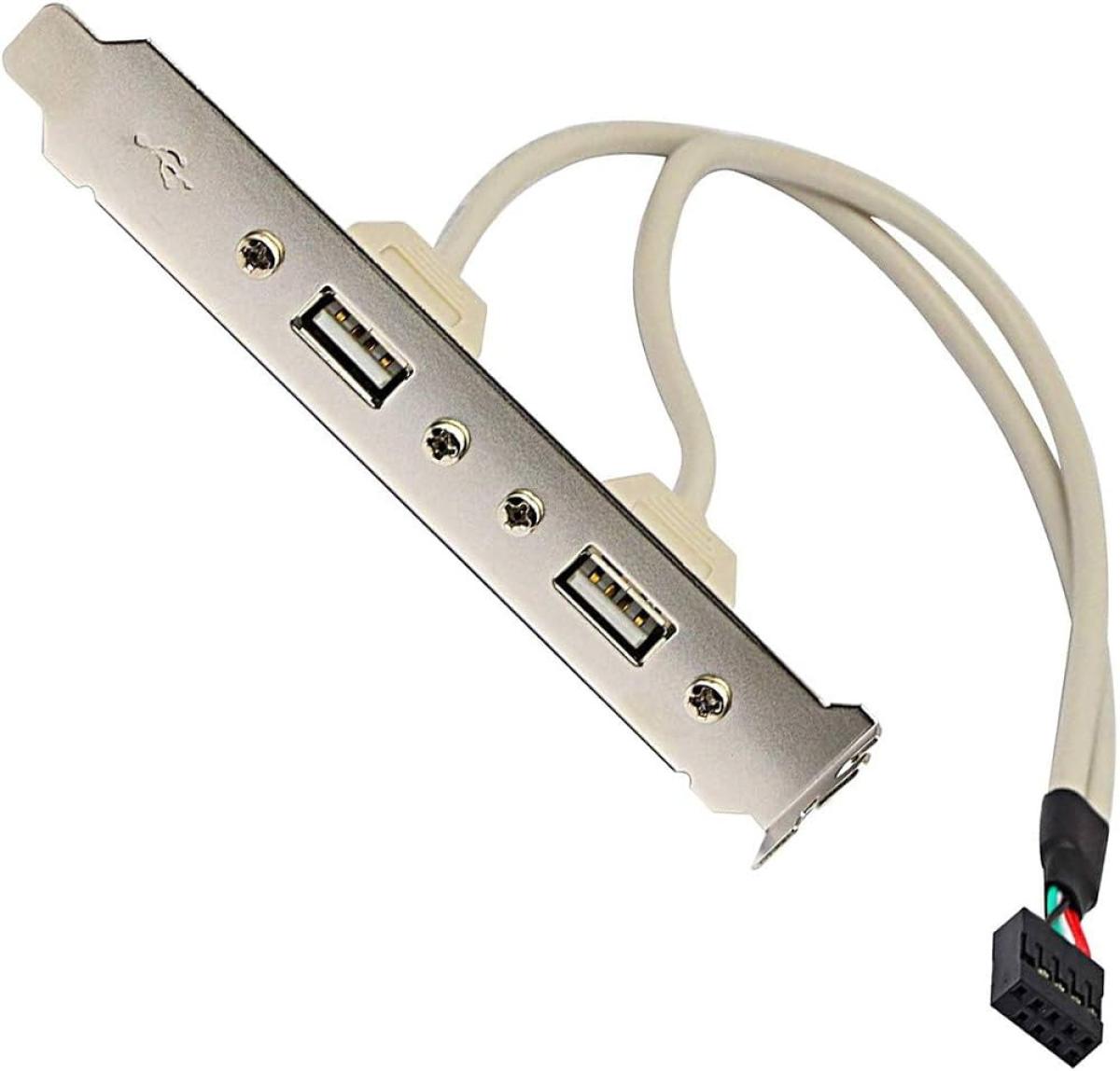

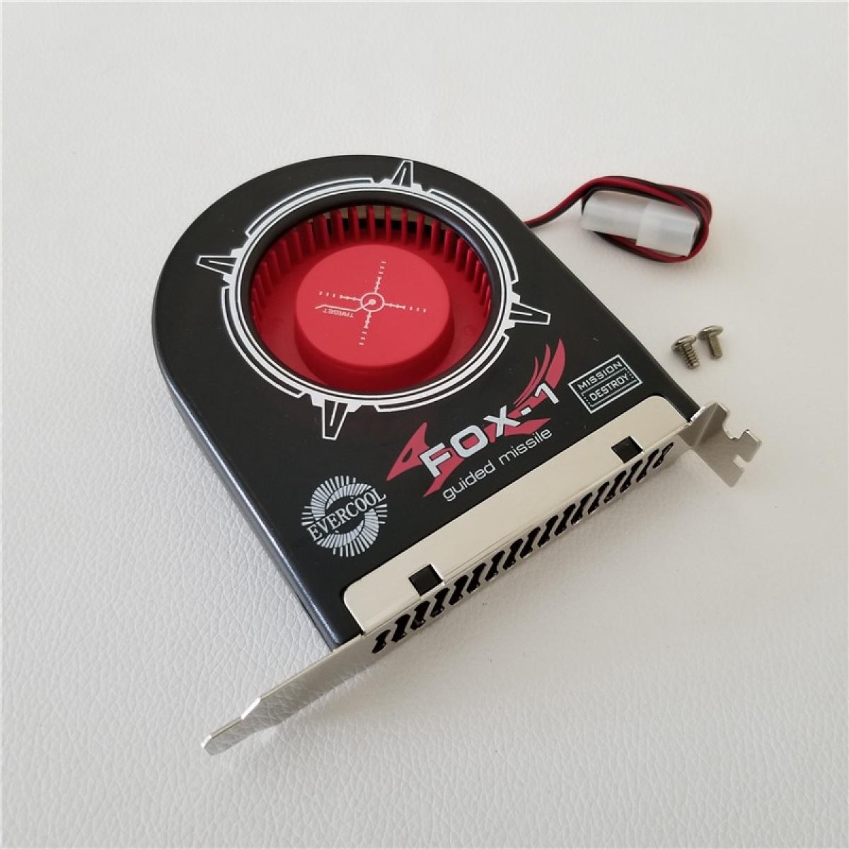

YouTube
Reply 255 of 255, by Irinikus
I'm going to have to order in one of these to draw the warm air off the GT 430, as they do get warm:
And one of these for the onboard USB:
