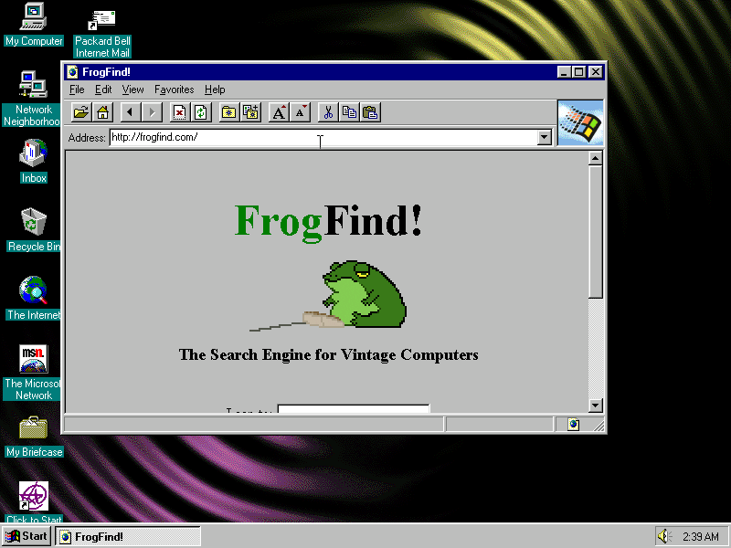

Updates! v0.8.0 is available on https://rust-dos.com
Here's a brief list of the most important new features:
v0.7.0
  • Windows 95 support
  • Improved Windows 3.x support
  • 3dfx in DOS and Windows
  • Pentium CPU emulation
  • Big performance improvements
v0.7.1
  • DPMI host implemented! This is still early and some games that work in raw mode may break, so it can be toggled off if needed
  • Windows 7 build
  • Improved compatibility with some popular games and scene demos

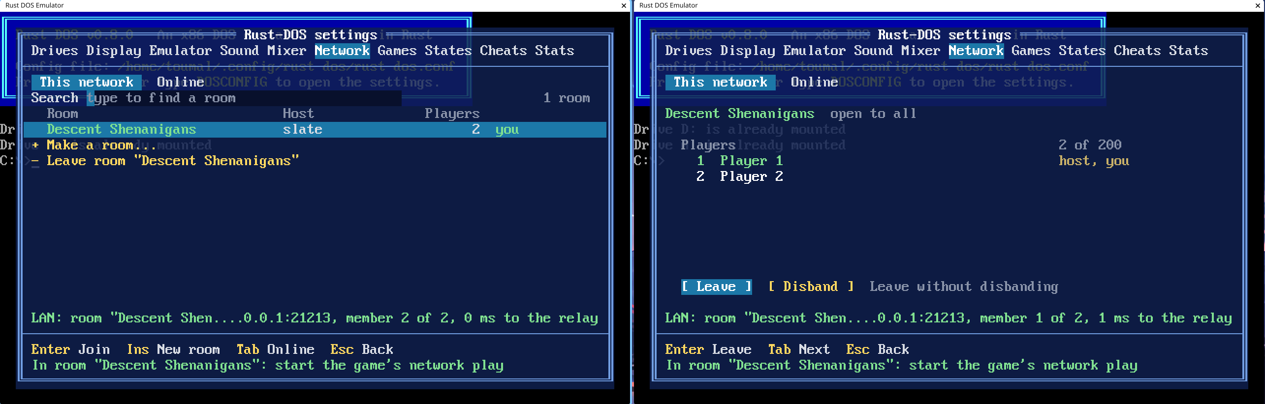

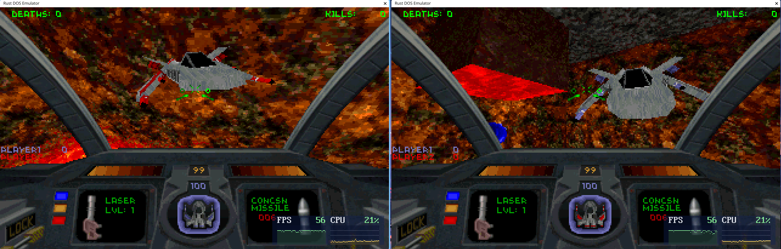

  • TCP networking and internet in Windows 3.x and 95
  • IPX networking in DOS via LAN and Internet
  • An online relay-service provides NAT traversal, and you can also run your own if you prefer.
  • Create and list lobbies with and without password protection
Trumpet Winsock on Win3.x support only covers the NE2000, not dialup.
I should note that the networking is not compatible with dosbox or physical PCs. I was never a fan of having to faff with promiscuous mode and special system libraries. On the plus side breaking compatibility means more features like password protection and internet lobbies without the need to do port forwarding. If you do need to network with physical machines or dosbox instances, I think Dosbox-Staging or Dosbox-X is the logical choice for that.
If you just want to play multiplayer games with minimum effort, create a lobby, have the others join, and start your game.
One last thing: traffic is not encrypted, even via the internet.

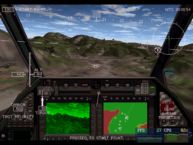

What kind of hardware is needed to do 486 + Voodoo emulation?
Reply 26 of 32, by Dividebysandwich
BinaryDemon wrote on Today, 15:32:
It's probably a bit more power hungry compared to dosbox-x since their implementation had a lot more time in the oven. There's also always a chance that specific games perform much more poorly because they use certain instruction sequences that kick the dynamic recompiler out of optimizations or are simply recompiled into long loops of inefficient code. For example I had the problem that floor rendering in Heretic caused a huge amount of overhead. Such cases then have to be analyzed and fixed for the particular game in question. Unfortunately there's no one size fits all solution, at least none that I know of.
I haven't really benchmarked Voodoo between Rust-DOS and Dosbox-X yet either - I was more focused on getting things working, optimization will come in the next step.

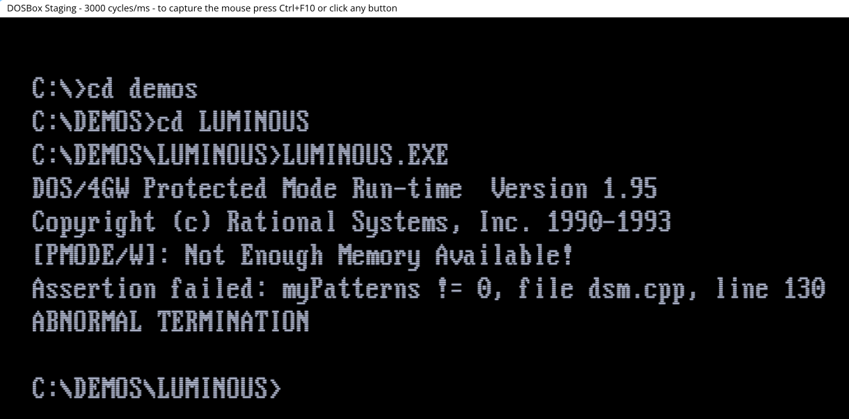

Which games?Dosbox doesnt need it, what makes rust-dos different?
Reply 28 of 32, by Dividebysandwich
gsos wrote on Today, 19:05:
I think I first encountered this with the demo "Luminous" by scoop (https://www.pouet.net/prod.php?which=6279)
Here's dosbox-staging also failing with the same error:
Again, if it causes problems, it can be disabled even without restarting the emulator, you just have to sit at the prompt.

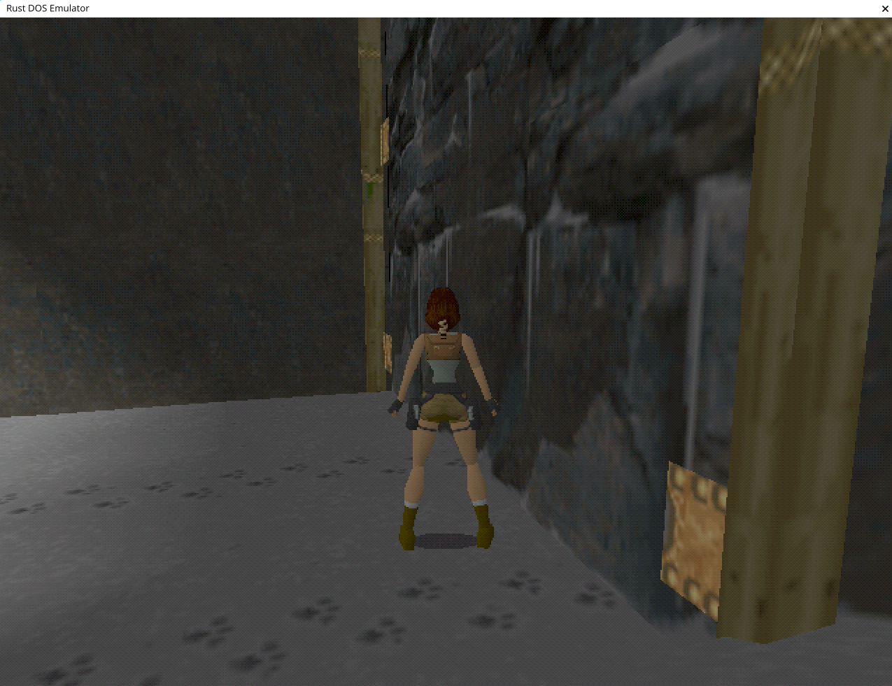

Tombraider, after the 3Dfx logo shows just a black screen, maybe it's just the blink video intro that breaks things.
In VMware (differently than Vbox) the black screen is a thing as well, but there just pushing ESC twice is enough to skip the invisible videos, and go straight to the game, which then works perfectly.
Here ESC does nothing, and a blinking cursor is the only sign of life.
Edit, the above applies to W8.1, retested from Win10 seems working perfectly.
Reply 31 of 32, by Dividebysandwich
@The Solutor: I also can't reproduce this on Linux. I downloaded the CD version and it seems to work fine. Looks like another windows version specific problem 😒
