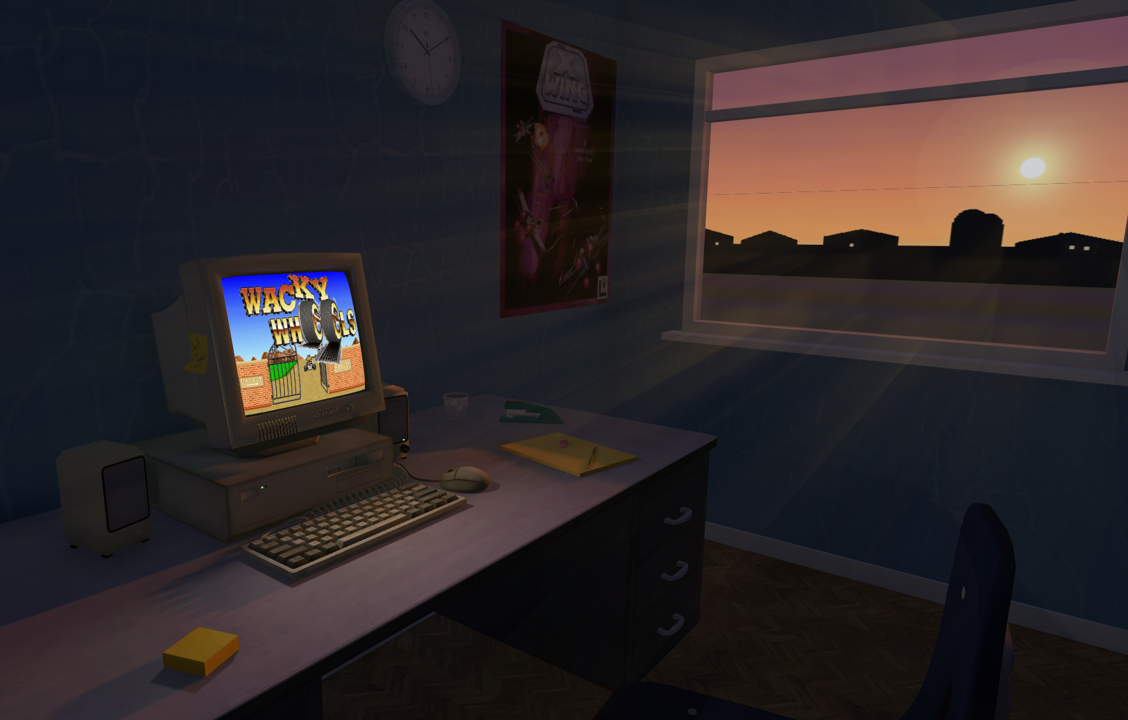

In other news, I got a Steam Frame in the mail and... well...
Would you like to play your DOS games in VR?
