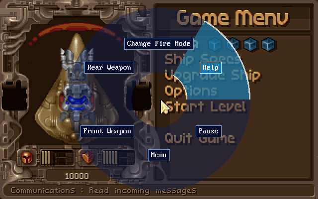

Gamepad mappings and new action wheel
* Games can now come with their own gamepad mapping: a `[gamepad]` section in the profile, or the `input_pad_*` / `input_wheel_*` lines of a package's DOS.YML.
* Each pad input (D-pad, A/B/X/Y, shoulders, triggers, L3/R3, Select/Start and the stick directions) can press up to four keys, mouse moves or clicks, or joystick moves and buttons, e.g. `start=leftctrl+f10 Open Menu`.
* An input bound to `wheel` opens a radial action wheel over the game while held. The left stick (or D-pad) picks a slice, and releasing the button triggers it.
* Mouse speed (`padmousespeed`, `mousespeed`, `mousexfactor`) and the host mouse wheel (`mousewheelup`/`mousewheeldown`) can be set per game.
* On desktop the first gamepad uses the game's mapping. In the libretro core, it applies to port 1 set to **Gamepad as keyboard**.
* **P** on the Games page lists a game's mapping.

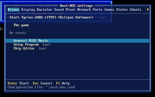

Launch configurations
* A `.dosc` file's launch configurations (`[Setup Program]`, `[Ship Editor]`, `[General MIDI Music]`...) are offered in a chooser when the game is launched. Tools like the setup program are marked.
* Combined options such as `[MIDI + German]` are picked with Left/Right on the game's row.
* When a tool ends, the chooser opens again. All launch configurations share the game's saves.
* Works with the keyboard and mouse on desktop and with the gamepad in RetroArch.

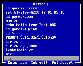

Clink-style prompt
* The DOS prompt now edits its line like clink: move and delete anywhere in the line, word keys, overwrite and undo.
* Colors for commands, programs, switches and arguments. `PROMPT` can use ANSI colors after `$E`, e.g. `PROMPT $E[1;33m$P$E[0m$G`.
* Suggests the rest of the line from history (Right or End accepts).
* Tab completes commands, PATH programs, files, directories and variables. Ctrl+Space lists the matches.
* History is kept between sessions. PgUp/PgDn/F8 search it by prefix, Ctrl+R/Ctrl+S search it incrementally, and F7 shows it in a window. The new `HISTORY` command lists or clears it.
* This feature is configurable in the new `[shell]` section of the config
* The settings window now has toggles for suggestions, colors and history - in case you prefer an authentic DOS experience over convenience

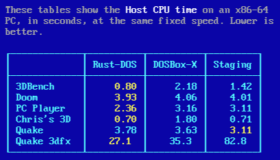

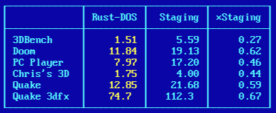

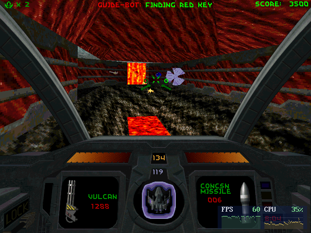

v1.3.1 is out -> https://github.com/dividebysandwich/rust-dos/ … ases/tag/v1.3.1
Big optimization push. The goal was not raw speed, but to lower the CPU effort needed for the same amount of work. Staging is still faster on some things like software rendered Quake, but overall Rust-DOS tends to be faster now.
On Raspberry Pi, Rust-DOS is now significantly more efficient. Note that specific games and programs might still use more host CPU - also RustDOS is still very young and some programs may not work at all. So don't uninstall your Dosbox-X or Dosbox-Staging 😉
Other changes:
x) Fast-FPU mode (trades f80 accuracy for speed)
x) Gravis Ultrasound patch corruption fixes

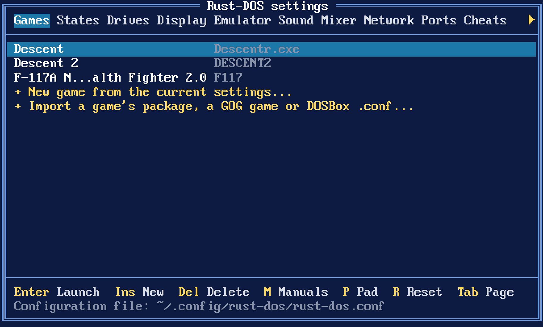

x) Settings UI tabs reordered - Games and States are now the first two tabs
