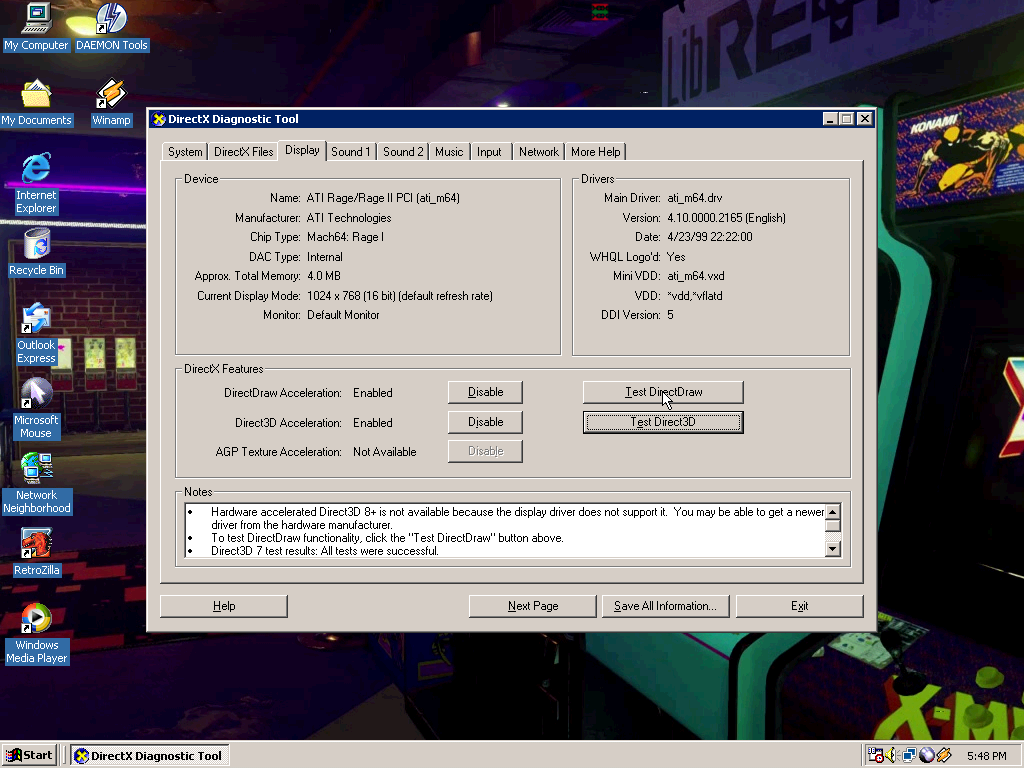

ATI 3D RAGE and 3D RAGE II
`machine=svga_ati_3drage` and `machine=svga_ati_3drage2` give you ATI's mach64 GT and GT-B, with the 2D draw engine, 3D triangles, the scaler and the video overlay. Windows 98's own driver runs the desktop, DirectDraw and Direct3D, and Wipeout for 3D Rage (the game ATI bundled with the card) runs through ATI3DCIF.

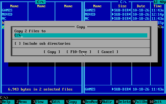

Rat Commander
Have a fresh installation of Rust-DOS but no Norton Commander at hand?
Type `RC` at the prompt for Rat Commander, a classic 2-panel file manager with the most importanat features built-in: marking, copy, move, rename, delete, view, edit, menus and mouse support. It can even work with `.ZIP` archives.
