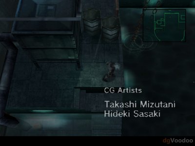

Metal Gear Solid Windows 10 x64 perfect with dgvoodoo
    83.46 KiB
    4994 views
    with dgvoodoo
    55.83 KiB
    4994 views
    without dgvoodoo

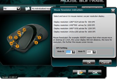

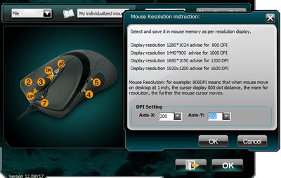

Shadowman windows xp sp2 compatibility mode perfect
Turok 1 crash with or without dgvoodoo
Turok 2 perfect more or less. 30 fps with several slowdowns especially with explosions, with powerarchiver perfect at 40 fps (AGAIN?). This on windowed and fullscreen mode. The mouse problem is caused (only fullscreen mode) by DPI setting. With 200 DPI is perfect but at 1600 DPI only the Y axis works.

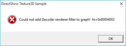

Metal Gear Solid 2 crash with dgvoodoo then black screen, without I have the same error but the game runs without problem. Dgvoodoo logo is not visible

    200 DPI TUROK 2 OK
    76.34 KiB
    4928 views
    1600 DPI TUROK 2 NOT OK
    11.16 KiB
    4928 views
    MGS2 Error
