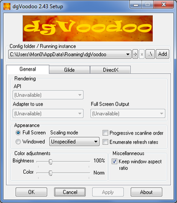

Reply 1755 of 3949, by SolivaN
Hi guys.
I've a problem with dgVoodoo 2
I've tested from the 2.43 to latest 2.51 version and this can't recognize my video card 😢
Look:
49.18 KiB
4022 views
My video card is a Zotac Geforce GTX 260 - 216 Shaders version
So, anybody knows if there is a problem with compatibility between dgVoodoo 2 and my video card?
Any sugestion?
Please! Halp! 😵
Reply 1758 of 3949, by leileilol
Uh...it says so right on the dege website. You can't miss it
(unless of course you're using it through someone's genius "win 7 game patch" that bundles it without notice/credit/etc)
Also DX10.0 cards are turning 10 years old this year!! An excuse to upgrade! 😁

Reply 1759 of 3949, by teleguy
SolivaN wrote:
Where can I find the documentation?
There are 3 Readmes included with the download. One of them contains this:
3. Requirements --------------- […]
3. Requirements
- Operating system: Windows Vista/7/8/10 with DirectX11 installed.
- Hardware: GPU supporting DirectX feature level 10.1.
