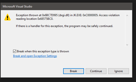

Hey guys,
I am trying to make Gog version of Jedi Knight and hardware acceleration to work with dgvoodoo. No matter the config I get crashes in DXGI while switching from game to pause menu (screenshot below). Main menu and the game itself work fine, but as soon as I press Esc key, the game stops working and I'm left with 640x480 desktop.
This happens on dgvoodoo 2.53 on Windows 10 AU and Nvidia GPU (with newest drivers, but it happend also on older ones) based on Maxwell and Pascal cores. The game doesn't crash if I switch to MS WARP renderer, but then the performance and graphics quality suffers greatly (for example, the HUD is blurred). Any help?

Reply 2919 of 3949, by Dege
Henrar wrote:
Hey guys,
If you have Visual Studio installed, you can download symbol files for DXGI.dll from MS symbol servers, to see the callstack, and, in what function it crashes.
Also, don't you have DX debug layer accidentally enabled? That can cause occassional crashes, if 'break on errors' is enabled. 😊
