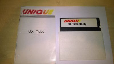

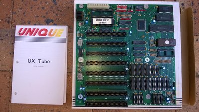

I've recently managed to acquire an XT motherboard, complete with an NEC V20 12 MHz CPU, the manual & utility diskette.
Unfortunately, the utility diskette (due to its age) has become unreadable with data reading errors.
I've attached a picture of the motherboard, manual and utility diskette.
I was hoping that someone might perhaps have (or know where I can find) the utility software that came with this motherboard.
The volume label on the diskette is "UX-UTILITY" and the main utility that is on the diskette is a file called "TURBO.COM".
I know that this is a small software utility that, when loaded, will enable a user to switch between normal and turbo mode by pressing either "CTRL"+"ALT"+"+" or "CTRL"+"ALT"+"-".
Fortunately, the motherboard can also be adjusted via a hardware turbo switch, but I would just like to obtain the software as well.
2.19 MiB
2089 views
UX Turbo Mainboard
1.52 MiB
2089 views
XT Turbo manual & diskette

Hey, that's a nice board! Congratulations! 😀
Sure the disk is hopelessly damaged ? It doesn't look too shabby.
From personal experience, even dirty disks can be partially saved now and then.
Sometimes this involves the use of a cleaned drive or a 360K drive.
Personally, I try to copy files manually first if I do enounter lots of read errors.
Sometimes lifting the floppy heads manually with the lever helps to find the sweat spot of maxium readibility.
I know, that sounds very amateurish, but it worked several times for me. 😊
Another trick is to use WinImage and try to re-try reading the disk on and on.
Sometimes I combined that with inserting an alcoholl (isopropyl) soaked spare floppy (dirty disk->alcohol disk->pause->dirty disk->alcohol disk->pause..).
That was only a last resort, of course. Doing so will damage the floppies (esp. the fleece) beyond repair. I don't recommend that.

Your board is the Juko ST.

Thank you for the advice.
I did try by cleaning my floppy drives (tried it with two floppy drives).
I even tried cleaning the disk itself, but no luck.

This is the kind of board i use in my Turbo XT build. Quite speedy for an XT. I've been looking forever for the 10Mhz 8086 version but that one is extremely hard to find.

I've since packed away the motherboard as I'm wanting to build it into another case but, when I tested it, Landmark 2.0 & Norton SI 6.0 did indicate it was running at 1.0x that of a 4.77 MHz XT (in "de-turbo" mode).
How "accurate" it runs at precisely the speed of a real IBM PC 4.77 MHz, I can't say.
However, I would guess that if you have an old CGA speed sensitive game, that only wants to run at 4.77 MHz, then it should be "accurate" enough to allow you to play such a game.

I did try to read it another floppy drive, but no luck.
Unfortunately, the disk has become totally unreadable (I'm getting the infamous "General Failure" error in DOS) and I therefore cannot look up the contents on the disk or their file sizes.
The manual indicates that you just run the "TURBO.COM" utility after which you can use the shortcut commands on the keyboard (as described in my original post) to either run the PC in "normal" or "turbo" mode.

No luck - I think the magnetic parts of the disk was too far gone.

No, it was definitely a 360k diskette.
With the help of Norton Utilities, I was able to "reconstruct" some of the files on the disk. I've attached a zip file with the files that were on the disk.
Initially, Norton Utilities just renamed every file as "FILE000X" and, by using the DOS editor, was able to deduce what each file was.
There are basically three utilities on the disk, namely TIME.COM (I assumed the extension was .COM), TURBO.COM & CDISK.SYS
The other two files appears to be text files and I just named them the same as the two utilities with a *.TXT extension.
The two text files appears to be "broken" (some "garbage" at the end of each file) and I'm not sure about the RAMDrive file (haven't tested it yet).
Maybe someone will have some of these Juko utilities somewhere.
