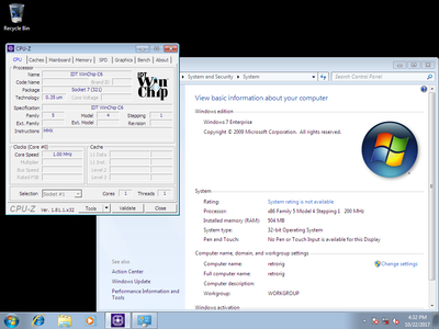

Reply 18 of 20, by lazibayer
BitWrangler wrote:
Anonymous Coward wrote:
If you want a stupid fast 486, just get a Winchip.
Also, if you want a stupid socket 7, just get a Winchip. 😁
Well... I would like to give it some credit... At least the earliest winchip can run Windows 7 but the earliest 6x86 couldn't... 😅
    129.11 KiB
    1478 views
Reply 19 of 20, by BitWrangler
Wow, surprising. I wouldn't have thought it ran on anything not PII up because of that PAE thing.
