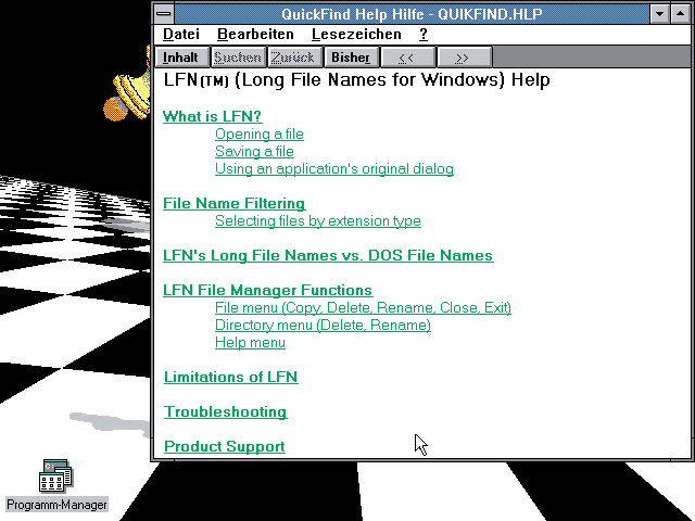

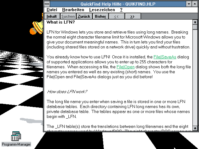

(PS: I recall seeing a fake LFN driver for Win 3.1 years ago.
It stored aliases of 8.1 files in a text file, I belive. Forgot how it was called, though.)
Reply 5 of 7, by Matth79
I think you have to switch to Calmira as the front end to be able to do LFN http://www.calmira.de/
Reply 6 of 7, by oeuvre
One time I killed an NT4 install cause I defragged that drive in MS-DOS. It renamed all the LFN directories and files to 8.3 format.
Reply 7 of 7, by Jo22
Update. I have no wish to inflame matters further, but I think I've found what I was talking about earlier..
The program is/was called "LFN(TM) (Long File Names for Windows)".
