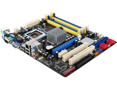

Newegg has some of these
ASRock G41C-GS R2.0 LGA 775 Intel G41 + ICH7 Intel Motherboard for - $65
or this one has AGP.
ASRock 775I65G R3.0 LGA 775 Intel 865G + ICH5 Micro ATX Intel Motherboard - $50
http://vi.raptor.ebaydesc.com/ws/eBayISAPI.dl … 927511000&ver=0
https://www.ebay.com/p/ASRock-775i65g-R3-0-LG … 5.c100009.m1982
https://www.ebay.com/itm/301701096084

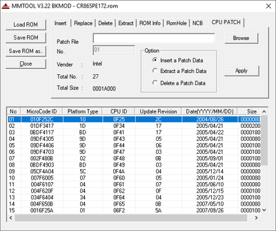

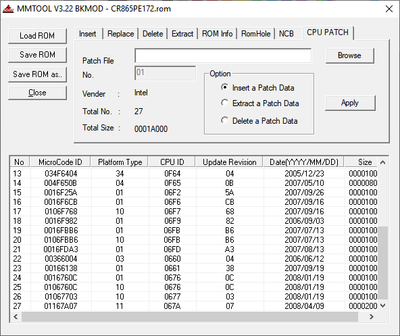

Reply 27 of 67, by Nemo1985
Thank you both for the quick answer, I try to download the bios and see if the microcode can be added\updated.
Edit: Those are the microcodes into latest bios
25.58 KiB
4338 views
26.17 KiB
4338 views

Reply 31 of 67, by Nemo1985
That would be interesting, I'm trying to update the microcodes but mmtool claims that they are not valid since the file size is different... any suggestion?
About the cpu i'm actually undecided between E7600 and E5800, the first supports the sse4.1 but it has a lower speed and according to your suggestion E5800 seems better.
Edit: I̶ ̶u̶p̶d̶a̶t̶e̶d̶ ̶e̶v̶e̶r̶y̶t̶h̶i̶n̶g̶ ̶e̶x̶c̶e̶p̶t̶ ̶t̶h̶e̶ ̶c̶p̶u̶0̶0̶F̶4̶8̶_̶p̶l̶a̶t̶0̶2̶_̶v̶e̶r̶0̶0̶0̶0̶0̶0̶0̶E̶_̶2̶0̶0̶8̶-̶0̶1̶-̶1̶5̶_̶P̶R̶D̶_̶0̶E̶1̶5̶8̶E̶1̶0̶ ̶a̶s̶ ̶a̶ ̶s̶i̶d̶e̶ ̶n̶o̶t̶e̶,̶ ̶I̶ ̶w̶o̶n̶d̶e̶r̶ ̶w̶h̶a̶t̶ ̶m̶i̶c̶r̶o̶c̶o̶d̶e̶s̶ ̶a̶r̶e̶ ̶t̶h̶o̶s̶e̶ ̶s̶i̶n̶c̶e̶ ̶g̶o̶o̶g̶l̶e̶ ̶g̶i̶v̶e̶s̶ ̶n̶o̶ ̶r̶e̶s̶u̶l̶t̶s̶ ̶w̶i̶t̶h̶ ̶i̶t̶.̶
Every microcode has been updated, there is one microcode fewer because intel merged the platforms for CPUID 10676.
CR865PE172MC.7z
306.44 KiB
369 downloads
There are no microcodes for 771 but apparently they can be added without issues, the total number of microcodes goes up to 33, if anyone is willing to test it I can upload that file too.
