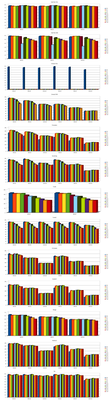

Just like my driver performance threads for the Rage 128 and TNT2. The card I used is a Creative Geforce256 (SDR 120/166).
The test setups I used were: P3/800EB on an OR840 board with 512MB of 800MHz RDRAM and a K6-3 450 in an Asus P5A-B with 128MB of PC100@CL2. I used a sound blaster live in both, using the VXD drivers.
I'm going to update these threads with some 1999 game results later. I split up the tests like this because it takes a while to run these tests and didn't want to do it all at once (the heretic2 timedemo takes something like 15 minutes for just 1 run.. and that is 3 runs for each resolution and driver). I could also post some pics of these setups if anyone is interested.
P3 results:
The attachment gf256drv93800.png is no longer available

The 1999 driver holds up surprisingly well.
What's causing Unreal to not function on anything else?

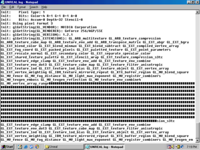

I think unreal was crashing because there are too many GL extensions. After a crash it would always show this in the log file:
The attachment unreallog.png is no longer available

Ah yes, the good old extension string overflow.
NVIDIA appears to employ extension limits for certain old applications automatically in their modern drivers. Haven't been so lucky with Intel.

No big loss as Epic's own OpenGLDrv was a very feature incomplete and buggy mess anyway. No overbrights, no volumetric dog, no detail textures, etc. D3DDrv was preferred for nVidia then.
Nvidia's extension wanking in 2001 broke a lot of stuff including some professional applications.

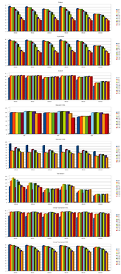

Here are the 1999 game results on the P3/800:
The attachment 99gf256drv93800.png is no longer available
