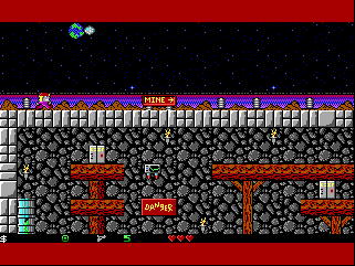

Finally got some time to work on this one. Not enough to make the entire thing working but I've tried Qbix's suggestion. Anybody cares to test and comment this one? The border will only work in surface/fullfixed modes were you actually have an overscan area. This is not a replacement for my previous patch, I am still working on the full patch.
Reply 46 of 101, by ykhwong
It worked only with fullscreen 640x480 / surface. But so strange.
Look at the screenshot below.
Reply 47 of 101, by Qbix
Rank DOSBox Author
DOSBox Author
probably a 320x200 game then.
Water flows down the stream
Reply 48 of 101, by vasyl
Yup, Crystal Caves is 320x200. But it worked with other resolutions as well. Did you set fullfixed=true?
Reply 49 of 101, by ykhwong
fullfixed value does not exist in the latset cvs. 😀
Reply 50 of 101, by vasyl
Doh! Good timing. So, how do I get the effect of fullresolution=1024x768 and fullfixed=true with new implementation?

Updated to current CVS (that patch still should work), tried fullresolution=1024x768, and got the expected -- small image in the middle of the screen surrounded by very thick (all the way to the edge) red border. Probably need to limit the width of that border to 100 pixels or so -- it gets too distracting.
Reply 55 of 101, by vasyl
I've uploaded new version to SF. This one has limitation that it works only with surface rendering. It also requires fullscreen mode to be bigger than the game video mode (it is actually ovescan), works just fine in window mode by extending window accordingly. Very cheap performance-wise, looks quite good, easy to maintain unlike the old version.
I am planning to extend it to other rendering modes. I don't want to reimplement blending ovescan inside the image, it was too hacky before, it's really ugly with new renderer. Maybe some stippling hack like the one I had in paletted modes but that's not a priority.
