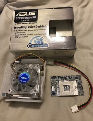

Reply 8 of 18, by Katmai500
Warlord wrote:
I searched for about 3 years for one of those adapters they never come up for sale.
Whats a good PCI-E Graphics card for windows 98se that doesn't have comptibility problems with older games like directx 7 and 8
One just sold on ebay yesterday with the original cooler and box. I wonder if someone here got it. 😳

Reply 12 of 18, by Katmai500
Warlord wrote:
That sadens me honestly because it must of been a buy now and not an auction so I missed it. I have searched at least a couple days ago. Any clue how much it sold for?
$57.50 + $7 shipping. I would have jumped on it as well had I seen it. It sold buy it now within a two hours of posting.

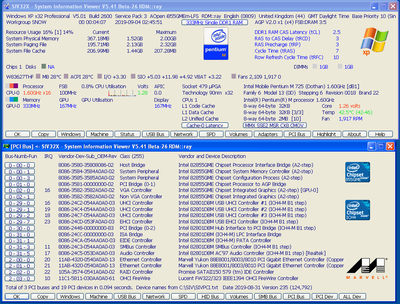

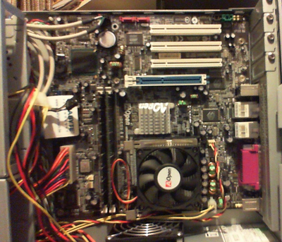

Reply 14 of 18, by red-ray
an81 wrote:
red-ray wrote:
My AOpen i855GMEm-LFS has an AGP Version 2.0 slot, but I am not using it at the moment. It's also got mobile chipsets
Is yours the black or green pcb version?
It looks dark green to me, what is the difference apart from the colour please?
    87.98 KiB
    1838 views
    i855GMEm-LFS chipset
    956.82 KiB
    1838 views
Reply 16 of 18, by red-ray
Warlord wrote:
that should be an agp 4.0 at least it is keyed that way. perhaps the onboard graphics is only 2.0 electrically.
No, it's as I said AGP V2.0 which supports x4 + x2 + x1. On the 2nd line there is AGP V2.0 x1 (x4) which has a tooltip that will say:
The System has AGP V2.0
AGP Bridge operating at x1 (Maximum is x4)
and the System Bus to Memory Clock Ratio is 3 to 5
[Chipset MCH] <- SIV32X - System Information Viewer V5.41 Beta-26 RDM::ray
Intel 82855GME Chipset Processor Interface Bridge (A2-step) - Vendor ID 8086-3580-35808086-02 size 0100
AGP Version 2.0 Current x1 Supported Speeds x4 x2 x1
AGP Mode V2.0 Support for FW Transfers Sideband Addressing Command Queue 32 (Maximum)
AGP Disabled Current state Command Queue 1
AGP V3.0 supports x8 + x4 and after checking https://en.wikipedia.org/wiki/Accelerated_Graphics_Port I expect there is such a thing as AGP V4.0, which chipset has it?
