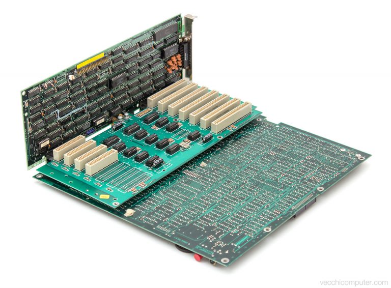

The M24 is similar: It's a motherboard on the bottom, an 'ISA backplane' on top, joined by the video card. I like it because it's weird. Als has the advantage that the leaking battery will not leak a lot on the PCB but on the case!
Source: https://www.vecchicomputer.com/2017/07/olivetti-m24-1984/

That looks very familiar.
We had an M24 in the house when I grew up. I was born and raised in the Netherlands and my dad used to work for the bank (ABN, later ABN-AMRO) and in the late 80's they "modernised" the bank and employees were able to buy a computer through work for use at home. So, in I think it was 1987, we got the M24. No hard drive. Two 5.25" disk drives. A CGA color display. It was an 8086 running at 8Mhz. I spend a lot of time with that thing. My first computer. 😀
I think years later, when I had upgraded to another "better" PC, my parents tossed it. 🙁
