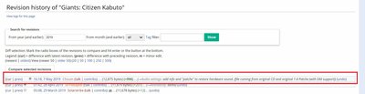

Reply 341 of 408, by Johnny Rico
-edit- Yes, it was updated about one month ago and I think I checked the page just before that...lame...
