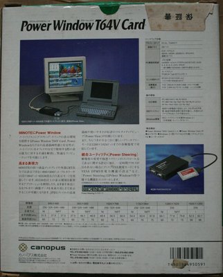

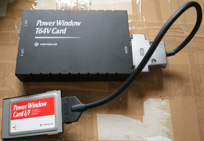

So, the only PCMCIA graphic card I know of is the Canopus PowerWindow T64V Card, powered by a S3 Trio64V+ and 2MB of RAM.
It has drivers for Win3.x and Win9x.
Website: https://web.archive.org/web/19970522083958fw_ … og/webt64cd.htm
Drivers: https://web.archive.org/web/20020214180356/ht … /pwt64vcard.htm
It's important to note that it doesn't work in DOS, the card gets activated by a driver in the autoexec.bat, but the video out displays nothing before Windows is loaded, and at that point the main screen remains blank.
The memory check utility is a DOS program that displays patterns of colours on the screen connected to the T64C, so there might be a way to send all the video data to the card...

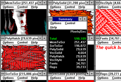

The Speedy results:
13.09 KiB
9840 views
VGA driver
13.18 KiB
9840 views
C&T driver
36.77 KiB
9840 views
T64V Card in 800*600 256
Speedy speedmarks
vga 5.90
CT LINEAR4 7.38
T64V
640x480 256 19.13
640x480 32k 13.76
640x480 64k 13.76
640x480 16M 8.56
800x600 256 21.60
1024x768 256 23.76
1024x768 32K 16.58
1024x768 64k 16.63
The card is fast but useless for DOS games, any Win3.x games you'd like me to test, let me know!

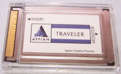

The Appian Traveler has 4MB of RAM and is compatible with DirectX 7.0, it works under Win9x and 2000.
It can handle resolutions from 800*600 upto 1280*1024 in 8, 16 and 24bpp.
Website: https://web.archive.org/web/20020716103935/ht … /traveler.shtml

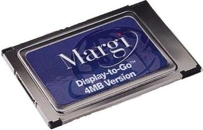

The Margi Display-to-Go exists in two versions, with 2MB or 4MB of RAM.
It has drivers for Windows 98/ME/2000 operating system or Apple OS 9.0.
It features a 64-bit graphics engine, and supports resolutions up to 800 x 600 at 24bpp, 1024 x 768 at 16bpp, 1280 x 1024 at 8bpp for the 2MB card and up to 1280 x 1024 at 24bpp and 1600 x 1200 at 16bpp for the 4MB.
Website: https://web.archive.org/web/20010331121137/ht … isplaytogo.html
https://web.archive.org/web/20010331074711/ht … aytogo_4MB.html
Drivers: https://web.archive.org/web/20090225051507/ht … /sup_dtg_sd.htm

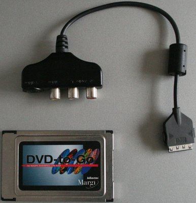

Thanks for this! I knew that there were sound cards and DVD decoders but not actual video cards. The T64V is an especially fascinating item.
I own one of the Mari DVD-to-Go cards. Here is a link to the drivers (from Dell) and a technical article:
http://www.dell.com/support/home/us/en/19/Dri … driverId=R20715
http://www.dell.com/support/article/us/en/19/SLN49395
Due to contractual obligations, Margi never distributed the drivers; they could only be obtained by the OEM who resold it.

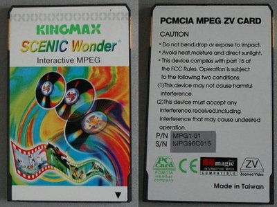

MPEG1 decoders too, those are even more rare than the MPEG2/DVD-to-Go cards that you can get dozens on ebay at any time, I bought the Scenic Wonder on taobao, only place I could find one.

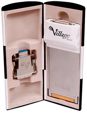

I uploaded some VillageTronic VTBook 3D content to YouTube.
Half-Life 2: https://www.youtube.com/watch?v=wPdUs1cJU_c
Mortyr: https://www.youtube.com/watch?v=1lpmeI3otM0
Quake 3 Arena: https://www.youtube.com/watch?v=3YDONuJXfV8
For some reason I only get 274 Marks in 3DMark 2001SE on default settings (1024x768x32). My laptop is a MAXDATA 6000T, Northwood P4M, 1GB DDR333, 60GB HDD and S3 PROSavageDDR integrated. 2 PCMCIA slots on left side.
I also tested Half-Life 1 which runs well, Max Payne runs too, but power is not enough.
Sadly 3D mode doesn't really support windowed games (freezes the system), and there is no 640x480 either, so it is really tricky to use the Trident for gaming, except in Max Payne. That game allows you to select GPU.

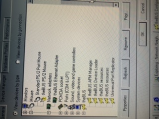

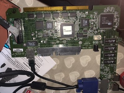

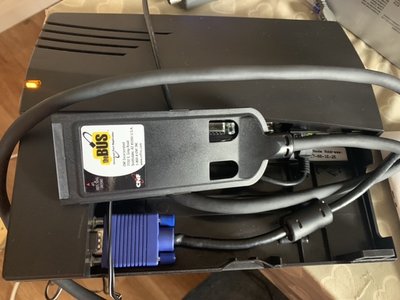

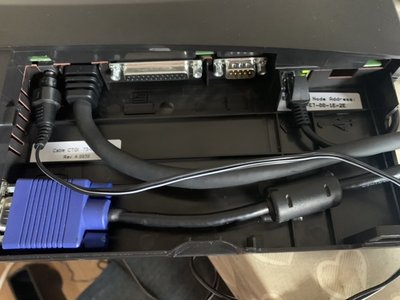

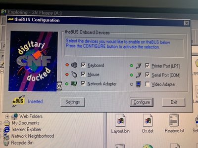

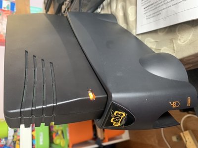

Hi all, sorry I’m reasonably late to this conversation however I would very much like to source the Canopus power window T64V card. I have got another item to add to this list however it’s not a stand alone video card but it’s a universal docking station made by CNF called “the bus” it has a pcmcia card interface it runs with Win 9x and also integrates, network, vga (4mb on board), parallel, serial and mouse / keyboard connectors.
I bought it with a hope it would work with the IBM PC110 but no matter what combination I try I’ve never got the video card to work with the machine. Though I’m sure with the right machine it would function. I paid a lot of money for delivery from the US more than the item cost itself a few years ago.
I’m quite the enthusiast when it comes to the pc110 and I’m currently restoring some with destroyed screens using an interface designed by a friend I have in Japan for it to work with a modern LCD as most the screens on the machines have perished due to the atmosphere in Japan.
So this article caught my imagination and I just hoped I could find one for sale. I keep checking yahoo auctions but so far no luck.
Happy to provide pictures and more details of CNF the bus but can’t show it operational with the pc110 though I do have an old xp machine that I maybe able to load windows 95 onto to test it further.
So if anyone has the t64v card and would be willing to part with it then please let me know!

Reply 13 of 77, by Mike1978

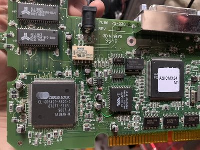

Hi just had the bus out of storage, it’s actually a 2mb video card. I managed to fry the power supply as forgot to put it through a voltage stepper luckily though I had a suitable replacement.
I’ve had this running today and can confirm with the pc110 it works for the network, keyboard and mouse. But still can’t get the vga output to work. I suspect it maybe a hardware conflict or the pc110 isn’t up to it. Being a 486sx rather than the recommended minimum spec of a pentium processor.
Seems to be a Cirrus chipset for the video I took off the cover and took some pictures.
Hopefully I’ve figured out the website enough to add some images:
89.21 KiB
7410 views
73.11 KiB
7410 views
136.74 KiB
7410 views
139.49 KiB
7410 views
82.13 KiB
7410 views

Few more pics showing the software
104.77 KiB
7398 views
27.65 KiB
7398 views
You’ll note by the indicators on the first pic that I don’t have the mouse and keyboard attached.
Seems the green indicates the network added fine and this corresponds in control panel.
I’d only fallen across this by accident on eBay one time so I think they’re pretty rare.
