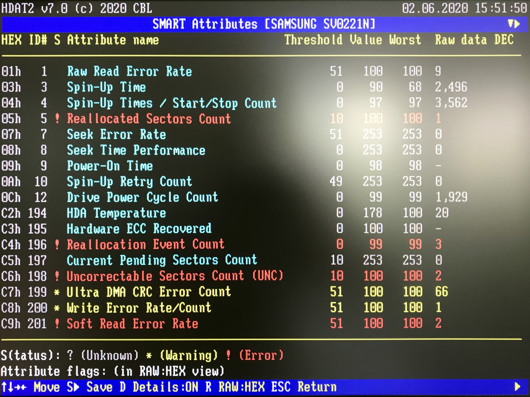

First post, by appiah4
I have a 20GB IDE drive working on a Socket 7 system that I think may be going bad. It has started making intermittent clicking noises which is never a good thing, but it has also caused system hangs once in a while and has once failed to be detected by the BIOS for a few cold boots for no apparent reason. Hence, I am trying to figure out how much life it has.
So what is a good DOS or Win9x tool to test IDE hard drives? And what is a good tool to image said hard drives on a Win7/10 system if I can get the drive hooked up via USB?

Reply 2 of 20, by TheMobRules
I use HDAT2. It has a lot of diagnostic features, can read SMART info and fits in a bootable floppy or USB flash drive.

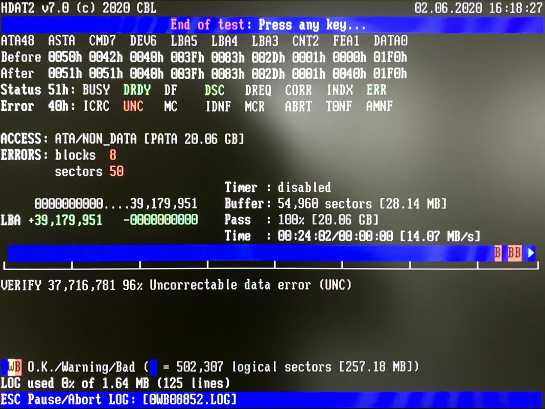

Reply 14 of 20, by appiah4
Thanks for all the suggestions. I started out with HDAT2. Here is what the SMART attributes and a VERIFY surface scan revealed:
I guess it's indeed dying. I can't seem to do any WRITE to this drive with HDAT2 though, trying a VERIFY/WRITE/VERIFY Fix returns an error about the controller. Regardless, it seems to be on its last legs, so I will just order a cheap USB2.0B/IDE device, delete the unnecessary stuff and image its contents. I believe I have another 20GB drive lying around somewhere, maybe and hopefully it is in better shape..
In the meantime, any further suggestions?

Reply 17 of 20, by appiah4
The 20GB Samsung died on me while recovering the files, though I got most of what was crucial. It's now well and truly dead and in the bin, and I seem to have dodged a bullet. I seem to have run out of viable HDDs for this system, even the hacked BIOS can only handle up to 32GB in LBA mode and the only HDD I have is a Seagate 7200.10 80GB. Fortunately for me, Jumpering 1-2 limits it to 32GB and in this manner the BIOS actually detects it.
And it is in MUCH better health:
Currently doing a VERIFY surface scan now.. If that check out, I'll reinstall Windows 98 on it.
EDIT: And it has finished the surface scan with zero errors. Huzzah. Thanks to everyone who helped out here, I learned a lot 😀
