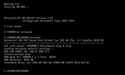

Reply 180 of 849, by root42
JazeFox wrote on 2020-07-17, 19:36:
The version is 0.72b, I made a mistake editing the post title. […]
root42 wrote on 2020-07-17, 19:21:
I tried using Unisound with my GUSar light, which works fine with IWINIT, but it keeps failing. Says no PnP cards are detected. Any ideas? I downloaded the 0.72b from the first post -- the header says 0.72c, but can't seem to find that one...?
Any help is appreciated!
The card should be detected, but only if it has the EEPROM written and if its contents are OK. If there are corruptions in the header zone and the checksum does not match, it won't be detected.
Does Intel ICU (or other PnP manager software) detect the card properly?
The only software I have is the one from the GUS PnP, so IWINIT, which works fine. I can stick with that, but I thought I could switch to UNISOUND and get rid of EMU386S. What's Intel ICU and where can I find it?

Reply 181 of 849, by MJay99
Interesting. My card is recognised perfectly fine by unisound.
Which file / setting did you write on the eeprom? Before writing it, my Gusar couldn't be detected by unisound (since there's no PNP information) - maybe your issue lies there?
EDIT: I simply used this one, to flash it (i.e. the GRAVNOCD.rom):
http://vogonsdrivers.com/getfile.php?fileid=7 … menustate=47,36
Reply 182 of 849, by root42
Yes, I flashed the GRAVNOCD.rom as well. Otherwise IWINIT won't detect a card either.

Reply 186 of 849, by JazeFox
Update time! 😀 A lot of bugfixes and some new features this time.
Tool updated to v0.75b

Didn't need to do that. Even without any options, the GUSar now worked without a hassle. See attached screenshot.
EDIT: The RAM detected is wrong, but, well, you can't have everything right...
The attachment Bildschirmfoto 2020-07-25 um 21.02.24.png is no longer available

Reply 196 of 849, by 640K!enough
root42 wrote on 2020-07-25, 19:03:
Is the RAM configuration wrong only with UNISOUND, or is it also wrong with IWINIT? If it's consistently wrong only with UNISOUND, then there may be a bug; if "iwinit -v" also reports the wrong amount, one of the DRAM ICs or solder joints may be questionable.
Reply 197 of 849, by root42
The RAM is reported correctly as 1024KiB by ModMaster XT. Let me check with IWINIT (gotta reboot and load EMU386S again).
EDIT: iwinit -v also reports 4MiB of DRAM. Which I think is nonsense. AFAIK I have 2x512KiB. So yeah, there might be something iffy still with that card. However: It works with ModMaster XT and Pinball Fantasies, which was my main goal. I will test it at a future date with a 486 board, and see if some games run with it (Jazz Jackrabbit, Epic Pinball, ...) as well as some 386 demos (2nd Reality). So, yeah, I am not going to touch it again. 😉
YouTube and Bonus
Reply 198 of 849, by MJay99
root42 wrote on 2020-07-25, 20:28:
I've been getting 4MB in iwinit, 4MB by unisound and 1MB on ModMaster.
Reply 199 of 849, by 640K!enough
MJay99 wrote on 2020-07-25, 20:32:
I haven't kept up with all of the recent developments with ModMaster, but I don't think he is using InterWave enhanced mode (yet). In compatibility mode, no more than 1 MiB will ever be available.
Is 4 MiB the correct amount you actually have installed on-board?
