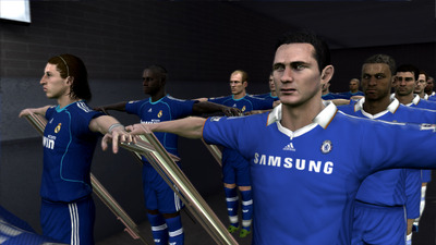

Reply 83 of 474, by Maarcis12
Dege wrote on 2020-08-12, 20:14:

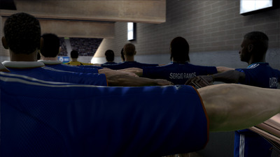

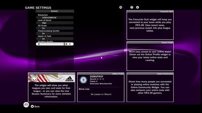

I did a quick try with FIFA09 demo but everything worked as expected. Do I need the full version? Or some special in-game settings, or mod?
That's weird, i tried the demo myself, but it has the same issue as with the full version. Here are my settings below and the bug itself (although the final version has more options to choose):

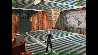

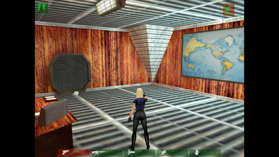

Question: why in Splinter Cell (1) Fast Memory Access can boost so much the performance with the D3D12 wrapper (GeForce 4800 Ti profile of course - 256 MB)?
QHD, AF 16x (thirteenAG patch)
no FMA -> 54 FPS
FMA -> topping the refresh rate, 75 in my case but can be higher
Of course in the same spot (second part of the training yard)
Reply 86 of 474, by Dege
Maarcis12 wrote on 2020-08-12, 22:21:
Could you attach your dgVoodoo config plz? It shouldn't matter but who knows...

Reply 88 of 474, by Maarcis12
Dege wrote on 2020-08-13, 12:14:
Here you go.
    dgVoodoo.conf
    15.16 KiB
    35 downloads
Reply 89 of 474, by Maarcis12
If i can add to it, Lowenz is onto something with PhysX because my laptop has Intel HD Graphics 520 integrated GPU which doesn't support PhysX, i tried play the game through Win XP, Vista and 7 virtual machines (i have Win 7 myself, but i wanted to test if the VMWare driver could do it) and all 3 ran game fine, it's just natively with 1050Ti the game has some weird issues with it.

lowenz wrote on 2020-08-13, 12:15:
I have the V-Sync enabled, the question is why *without* FMA is 54 :p
UE 1 reacts very bad to FMA (Unreal 227i + original dx renderer goes from 550 to 100 FPS), UE1.5 (Splinter Cell 1/2, Thief DS, Deus Ex IW) on the contrary really well !
Man, you're saying something! I profiled UT99 (DX7 renderer which constantly updates a lightmap texture in-frame) with FVMA and it turned out that it ran on a path always doing an unnecessary GPU-readback.
I optimized it out and now FMVA runs at the same (or little higher) speed as with no FVMA .
It even seems to fix the notoriously terrible frame rate in Grand Prix 3. 😁
No idea for SC1, maybe the renderer continuously (partially) updates a texture by the CPU at that scene and that's what FVMA is better at.
I'm on another machine now and I can repro the issue. No difference between dgVoodoo and native d3d9. For the time being, I have no a clue why it is.

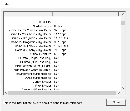

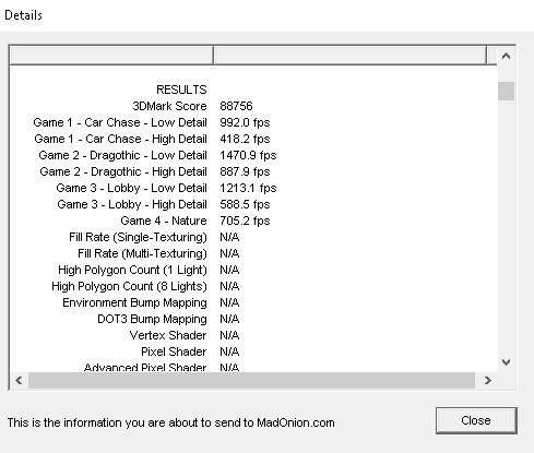

RX 570 - 20.7.1 - 3DMark 2001 SE (standard benchmark options - 1920x1080) […]
D3D8
D3D12
Simply awesome!
Now pixelshader-heavy test (Nature) result is better than the one with the native driver!

Reply 98 of 474, by Maarcis12
Ok, thanks for the answer. But will it be tackled in future?
