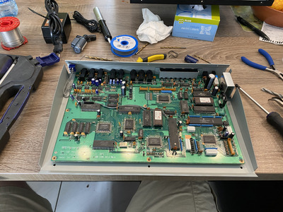

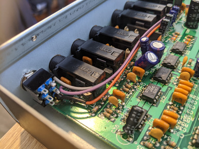

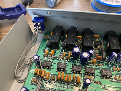

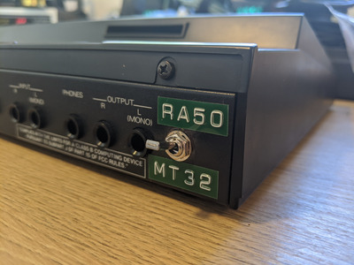

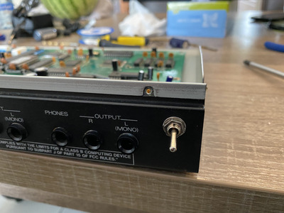

Reply 25 of 81, by SmokeMonster

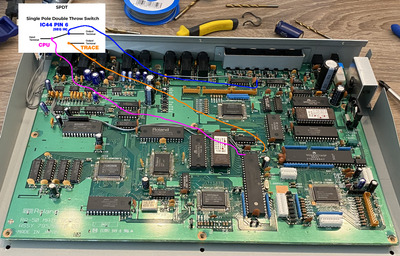

This is an awesome mod, thank you for documenting it. You can simplify it by using a SPDT switch and using CPU (IC28 / pin 1) as common:
1.53 MiB
4738 views
I took MIDI from SEQ IN (IC44 / pin 6) as suggested by Cloudschatze:
1.92 MiB
4738 views
1.3 MiB
4738 views
1.32 MiB
4738 views
1.65 MiB
4707 views
I used a DPDT switch because that's what I had on hand. Using one row of a DPDT is the same as using a SPDT switch
CPU (purple) is common
Thanks to Keropi for the help with this

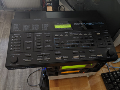

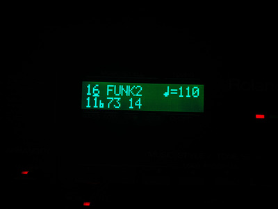

Reply 28 of 81, by Salient

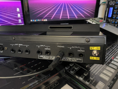

I just converted a second one !

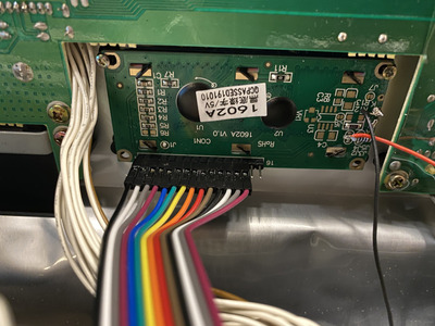

And also couldn't help myself to change out the display again to get rid of that dull standard one..... 😀
Reply 29 of 81, by pc-sound-legacy
Thanks to this thread, Cloudschatzes documentation and SmokeMonsters draft I successfully modded my RA-50! I am very happy that I came to a very cheap MT-32 this way. If you like to see the result, in this video I show some footage and the unit playing Gabriel Knight music here:
https://youtu.be/tN1sGnOoEIM
I also like to change the display as well but I have to find out where to connect the wires at first so this will be done sometimes later.

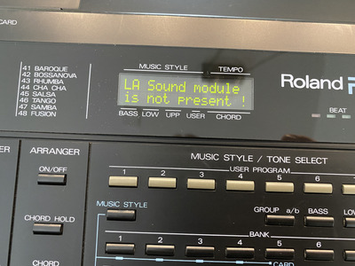

Got mine yesterday but its not starting, lcd lights up with a faint top bar but does not react any further.
It sounds like the unit isn't loading its program code. If the RA-50 Program EPROM (IC34) in your unit is socketed, pull the chip, splay the legs of one side slightly outward, and then re-seat it.

Just to clarify, it is exhibiting the following behavior, correct?
If so, do you have the ability to burn a new EPROM? Of the multitude of things that could yet be the culprit, there's a chance you might just be dealing with bit rot. I'll attach a known-good dump of a version 1.02 EPROM (rename with a .BIN extension), in case that helps.

Wow, yes thats what is see, when I connect the speakers or headphone it outputs a lot of noise.
(Edit: maybe some extra info but without the ra50 eprom it looks and sound the same)

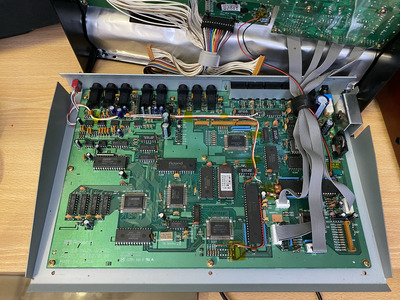

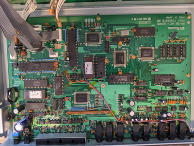

[Edit] Removed de RA50 and CM32L eproms, same behaviour. Placed them back and measured all eprom pins, seems getting signal. Measured all IC's operating voltages according to schematic, +5V/+6V and -6V seems all ok.
Maybe someone has some pictures of the solder side of the pcb? Mine seems to have some modifications.
