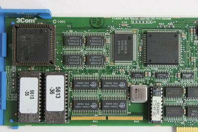

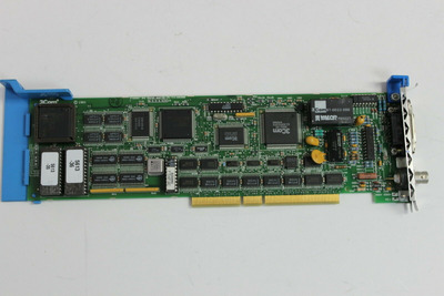

I'm talking about the F54FAC. I have a 3COM ethernet bus master adapter with that chip missing.
It looks essential but what is it?

That chip seems to be the SAPROM, the station address PROM that contains the MAC address for the card. The printed label "F54FAC" most likely is the last three bytes of the MAC address contained in this chip, and the smaller 02608C is the vendor part of the MAC address. According to the IEEE OUI database, 02-60-8c is indeed assigned to 3com. This makes me wonder, because as I know it, the bit with value 02 in the first byte indicates a "private", "self-assigned" MAC address (just like the 10.x.x.x or 192.68.x.x IP addresses), so addresses like this should not be in the database.
You can possibly use the card without that chip (unless card detection fails), and might be able to force a valid MAC address using a driver option. A likely model number of that chip is (results of a google search for dip-20 PROMs by phillips) is 82S135.
