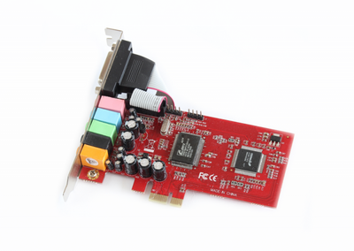

First post, by sangokushi
I am looking for a PCI-Express sound card with gameport. I found one image on internet but I cannot find the model no.
Does anyone know where can I buy one? Thanks.

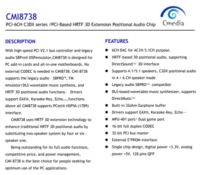

You can google "PCI-Express Soundcard CMI8738-LX" and the product link is on top of the 1st page.
It seems to be a soundcard for AmigaOS, using CMI8738-LX.
334.14 KiB
4631 views
Interestingly, CMI8738 is a PCI bus based chip with "SBPro" compatibility. I suppose the 2nd square chip sitting right next to 8738 handles PCIE <-> PCI conversion.
CMI provides Win XP, 2000, & 7 drivers, but I'm not 100% sure the card works on Windows.

Indeed, this card is pretty basic - it's only a CMI8738-LX sound chip with ASM1083 PCIe to PCI bridge. I already have a similar PCIe card, same chips and everything, the only difference is the lack of gameport. It works fine in Windows 7, and, from what I heard, even in 10.
holy mother of sweet god...
So... hypothetically, I can install one of these cards and plug a gameport joystick to my ryzen build? 😮

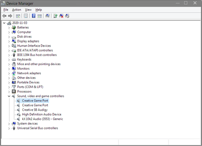

I followed the instructions in the 2nd link and installed two Creative Game Ports (of two Audigy cards) in Win 7 x64. Attached is a screenshot from the Device Manager.
Another driver included in Audigy Support Pack 7.0 (same version but slightly different size) also fits this way.
However, I don't have a joystick to test if it really works.
P.S. I can confirm that the corresponding MIDI ports are available and work fine even without gameport drivers.
