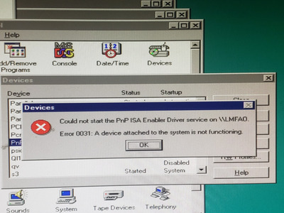

There are no options like "Plug-n-play OS" in the BIOS. Also, I got this error when trying to start the PNP ISA Enabler Driver under Devices, but I'm not sure it's related:

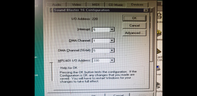

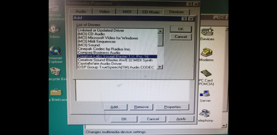

I finally got it working by removing the SB16 device in the Control Panel's Multimedia Properties, rebooting, then adding the "Creative Labs Sound Blaster 1.X, Pro, 16" from Multimedia Properties:
372.17 KiB
429 views
In the configuration popup, I left the default resources:
467.7 KiB
429 views
The second DMA channel is 5, whereas the "found new hardware" install that didn't work had the second DMA as 3 (and wouldn't let me change it).
The only issue from here is the "found new hardware" box every startup that I have to cancel. But that's the least of my worries as the sound is now working... and yes, I repeated all of the above at both 33 mhz and 40 mhz with the same results. Now I still can't get the damn mouse to work on this mobo. It seems the 4DPS uses a non-standard serial header pinout. But I have an ISA serial card on the way, so I'll see if that lets me use a mouse.

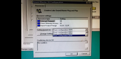

The "Creative Labs Sound Blaster 1.X, Pro, 16" driver quit working yesterday. I tried again to install the CT4170 through the "found new hardware" popup, but it still wouldn't play any sounds.
Even though using the latter method wouldn't let me change either of the the two DMA settings at first, I did notice that there were different "basic configuration" settings that I hadn't messed around with before. I chose "basic configuration 0005" instead of "basic configuration 0000" since it only had one DMA setting. I then manually set "Direct Memory Access" to 01 from 00. When I clicked OK and rebooted, the sound was working again!

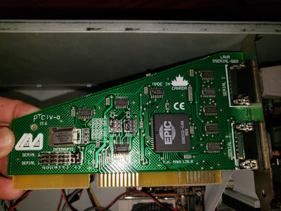

As for the mouse, I got an ISA serial card off Ebay, and at first the mouse would only work in NT 4 but not 98. In 98, the mouse would be detected (no error, cursor appears) but wouldn't move or click. I disabled the on-board serial ports and jumpered the ISA card to COM1 and COM2, but that didn't help. I then checked the IRQ's of COM1 and COM2 in the device manager (this is tricky to do w/o a mouse, but possible using Alt+letter keyboard shortcuts); they were set to 4 and 3 respectively (and couldn't be changed). I then swapped the jumpers on the ISA card from 3/4 to 4/3; the mouse finally works under both 98 and NT.
These ISA cards are still readily available on Ebay, just search "lava isa serial"
