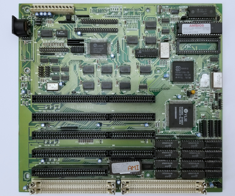

Not far ago a conversation about 286 motherboards built on 386 VLSI SCAMP chipset piqued my interest, so decided to check one of them myself.
Unnamed 286 motherboard with printed 2016XXVB-V1 on it. There is a small sticker on the back clarifying the release date - mid 1993.
Soldered 20Mhz Harris CPU, on-board IDE controller.
386 BIOS. Exactly the same as the one in Biostar_MB-1220VE (another SCAMP based 286 board).
Basically no jumpers. All perf settings are in the BIOS.
Came with 1Mb RAM, 60ns chips which is pretty rare.
Can take up to 32Mb of RAM.
2 Jumpers control which type of memory is used.
Inserted IIT 20MHz rated FPU for the tests.
All settings adjusted for maximum performance.
The on-board IDE controller stopped working under that configuration. Swapped it with external one and all was good.
Was thinking initially to swap the CPU to 25MHz one, but then decided to test it as is, compared to the very fast VLSI system from the first page, clocked to the same frequency.
The usual set of stats:
benchmark results
Performance is pretty bad.
Not sure what was the business logic behind releasing this motherboard in year 1993 with such characteristics.
Decided not to bother with swapping the CPU with 25MHz rated one.
In another thread was discussed the possibility of SCAMP potentially offering best perf in the 286 class, but it looks like VLSI produced just one good chipset - 16QC.

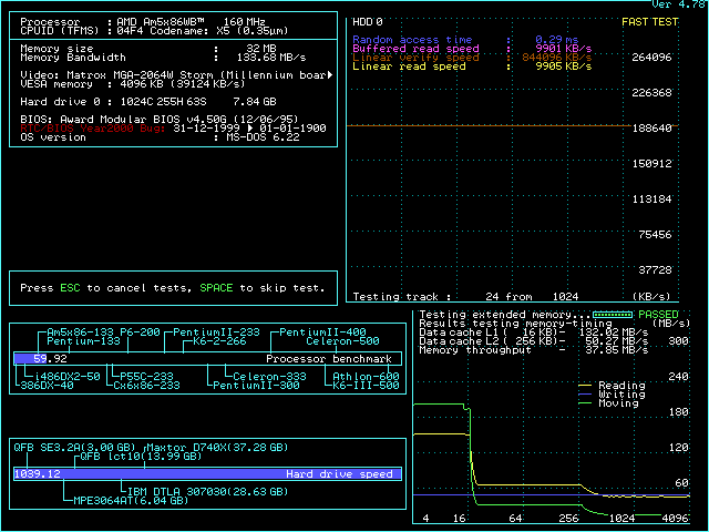

Abit PB4 revision 1.3, based on ALI M1487/1489 chipset (Acer).
Recently i spent time to check couple of late/good 486 motherboards with POD100 CPUs.
One of them was Abit PB4. It didn't work with the POD100 at all - couldn't get half way through POST.
Tried hard, jumper settings and everything, but to no avail.
While this was a bit disappointing, the motherboard is actually pretty good, so worth sharing some info about.
Very late design. Compact layout. Fast and stable. Works really well with AMD 486DX5 ticking at 160/40 MHz.
The easiest jumpers setup i have seen so far on a 486 class mobos.
All BIOS settings on max (for best performance) with one small exception for the 3D rendering tests - cache timings had to be set to 3-1-1-1 (down from 2-1-1-1) for complete stability.
Temporarily upgraded the BIOS to the latest available version, but to my surprise it was less stable with maxed out settings.
Downgraded shortly after to the original BIOS the board came with.
Tested with 32MB FPM RAM, 256Kb SRAM (maximum supported), Matrox Millennium PCI VGA, on-board IDE (requires DOS/Windows drivers), CF card.
--- Am5x86 at 160MHz (4x40)
IDE I/O is great.
benchmark results
Numbers are so-so.
PB4 does pretty well in Wolf3D and Doom.
A bit behind in Quake 1 and PC Player Benchmark.
Scores well in WinTune2 (accelerated Windows GUI).
Weak in compute (3D rendering tests).
--- Am5x86 at 180MHz (3x60)
Quick check online reveals that its clock generator supports 60/66MHz (datasheet).
The PCB does not implement the full table of frequencies, but the mod is very simple to make.
Tried it and ... nothing - falls back to 33MHz.
Experimented with different voltages supplied to the corresponding pin, including some silly things - no luck.
So, no 180MHz for this guy.
Checked online to see if others tried and/or succeeded with the clockgen mod, but didn't find any relevant information.
Anyone ?
While Abit PB4 does not win in any discipline it is definitely in the fast line with the rest, which is expected for a late 486 motherboard.
I don't have a lot of experience with Abit and Acer hardware, but they got this board just right for sure.
