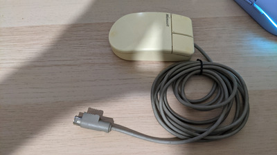

I bought a bunch of stuff on a local advert and I thought it would be a serial mouse but when I went to pick the mouse it has a connector I didn't recognise.

That’s a bus mouse. We’d have to have a look at the rest of the device to tell you more.

Oh ok! Never heard of that. Here is the rest of the mouse. No PC included sadly...

It's a Microsoft InPort mouse.

Is the sticker still on its belly? If so, are texts on it readable?
Reply 5 of 17, by Almoststew1990
Nope, no sticker. It looks like the end user can open the mouse by design though...

That was pretty normal in the olden days because the rollers needed a clean once in a while. All ACORN Risc systems use that type of mouse connector up until the A7000s.
