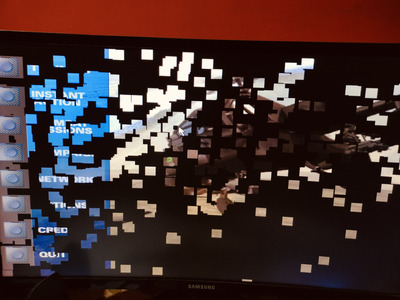

Team Apache works on my Intel igpu. The menu issue with Rready where the screen becomes black and mouse has to be moved to refresh it, still remains there as in my nvidia card.
Reply 1274 of 3485, by sharangad
BEEN_Nath_58 wrote on 2024-05-04, 18:22:
That's actually shocking. The menus and videos don't work on any of my Intel based systems.
Front buffer writes are poorly supported on Intel systems because they're tile based renderers.
@BEEN_Nath_58 are you sure you have an Intel based system?

Reply 1275 of 3485, by BEEN_Nath_58
sharangad wrote on 2024-05-04, 19:22:
That's actually shocking. The menus and videos don't work on any of my Intel based systems. […]
I didn't even need DxWnd for it. Also I attached the remaining problem with the game. The missions run as well
Reply 1276 of 3485, by sharangad
BEEN_Nath_58 wrote on 2024-05-04, 19:36:
Ah this is on Win7. I don't have a Win7 based system to test on.

Reply 1278 of 3485, by sharangad
BEEN_Nath_58 wrote on 2024-05-04, 19:46:
sharangad wrote on 2024-05-04, 19:43:
I don't think it's related to Windows. On general the OpenGL compatibility was quite same on both OS wherever I testrd
Edit: which other games had issues?
ANything with front buffer rendering (vhexen II loading progress bars, Team Apache come to mind. There was one more, I forget which). The SPD3D stuff Tomb Raider's cutscenes for instance will have problems.
I've made dosbox and Dosclient higher than normal priority, which is why I thnk ICR2 was having issues. I'll roll out an alpha tomorrow with all that removed,
Developer of RReady - Rendition Verité Wrapper.
