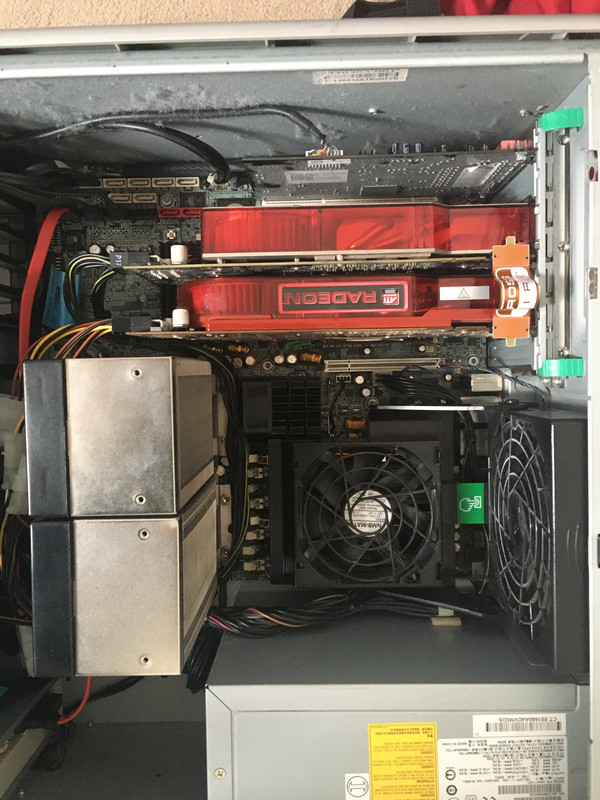

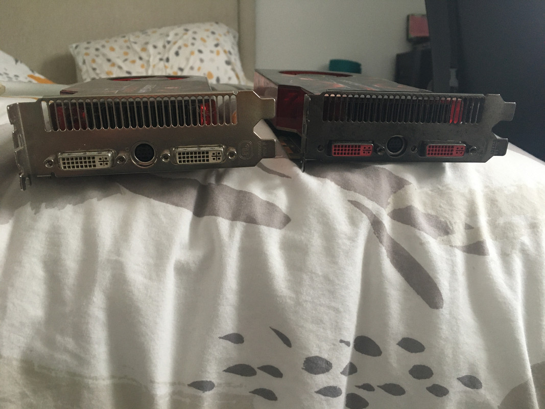

Reply 27 of 28, by chinny22
So what does a PC that does no gaming need? Crossfire of course!
Not only does this not have a single games installed, I don't even own any games that support crossfire.
but sex appeal has gone up especially with that transparent red cooler
Cost me just under £20 inc shipping so not a big deal, even came with the original box. I was only looking for XFX trying to get an identical pair but they are slightly different.
my "new" one doesn't have a red PCB or DVI ports, ah well close enough
So now I've got a 2 GPU, 2 CPU, 8 thread workstation and still useless for mining, guess I'll gave to start gaming on this now
