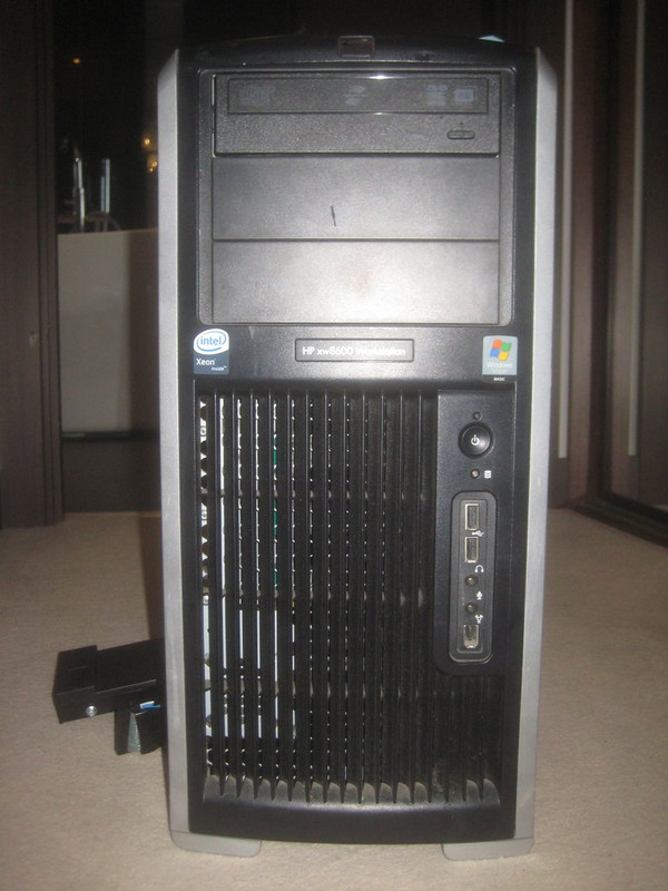

So I went about building a more basic PC out of spare parts, and got distracted. What I ended up deciding on is dusting off one of these
A HP XW8600 with build date of 2008, I've actually got 2 this been the faster with a X5450 3GHz CPU and the "high performance" heatsink.
They came from a Industrial Printer's and either used by CAD or ran a printing press. I suspect the later as both had crappy (and dead!) Quadro NVS 295 cards.
The things are filthy as is everything from that place. Industrial printers are NOT dust free environments not to mention forklifts whizzing around and massive printer's needing lubrication, inks and whatever else.
I know graphics will be a XFX Radeon HD 4890 the best PCIE card I have in my spares list which I got for free few years back. Thing is that 's pretty much period correct for this Vista era workstation. hmmmm

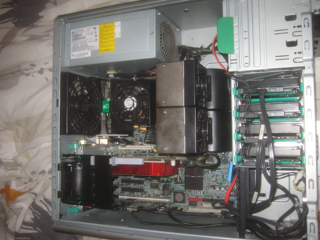

First things first was giving it a bath, I'm just letting it dry out now, not after spotless but don't want to need a shower myself every time I work on it.
I've some upgrades in mind. Either cannibalising the other workstation or from a ML350 G5 that I spent good money on last Christmas to fully upgrade only for the onboard VRM to fail.
Let's see how much I can NOT spend on this, the fun begins

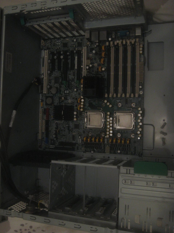

I decided it was time to have a Win7 PC in my gaming line up and thought this could be it. Only reason I need it is for Ion fury and C&C Remastered, neither are particularly demanding by todays standards so with that in mind I went with the following hardware.
Upgrade the CPU from the X5450 to a pair X5460's. For such a small jump I'd normally just get a second X5450 but as I had purchased the X5460's for the server that died on me I was damn well going to use them somewhere!
As I was running Win7 I went with the more memory the better mentality. I dug though my stash and managed to find 4 matching sticks of 4GB and 4 sticks of 2GB. 24GB should be fine 😉
GPU is the XFX Radeon HD 4890 I got few years ago in a freecycle lot
Audio is a Dell SB0770 X-Fi I salvaged years ago without knowing what it was.
HDD I went with 2 stipe arrays just for the fun of it
Array 1 is the 2 original SAS drives off the onboard LSI controller
Array 2 is a SATA array using 2 WD 500GB Black drives I've salvaged from an industrial PC from the same company off the Intel chipset controller.
DVD I replaced with one pulled from a HP PC from the same era, just out of pure chance.
so costs
CPU's £0, They did cost me £17.80 a year or so ago but as that was for another system I'm not counting it for this.
Heatsink: £34.95
Everything else free 😀
That's pretty good for me who tends to like to upgrade everything as far as it can go.
That said I am on the lookout for matching HD 4890 to crossfire, again just for fun not for performance so not prepared to spend more then around £30
And maybe more ram if I can get it cheap after I see how this goes as the graphics card does hold it back a little but not upgrading that unless it's free.
Just installing Windows now but so far I'm liking how this is going.
