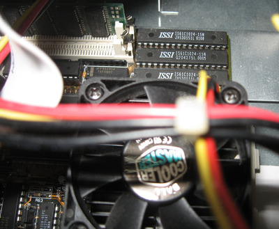

I think, maybe my TAG-module of 12 ns is the problem here.
Today I will test if the L2-cache can be recognized at lower FPS (33/40 MHz).
There is a misunderstanding on your side.
Your tag RAM is most likely faster than the data SRAMs, because it is a 12ns type.
Your ISSI61C1024-10 are either 15ns or 20ns - depending on luck - types.
The ISSI61C1024 5volts 32pin dip, existed in 3 variants 12ns, 15ns and 20ns. So 10ns is 100% re-labelled.
I never have seen a 12ns type of this chip, therefore I assume all that "10ns" chips are either 15 or 20ns.
On the other hand, one faces the same problem, when buying Chinese 15ns types, they can be re-labelled as well, so it's fine to buy the 10ns ones.
That is the reason also why rasz_pl wrote above:
its already active, you would need to experiment with 10ns SRAM chips, cant get those in DIP, requires making SOJ-DIP adapters.

I once thought like rasz, but am more in pshipkov's camp now. The kicker for me was when I ordered some modern Cypress branded 32kx8 SRAM at 12 ns. This was maybe 5 years ago. I started doing some testing on my UUD board with tight timings and the Cypress chips weren't up to the task. I grabbed some random UMC 32kx8 chips, rated for only 15 ns, and everything just worked. Thinking maybe there was a dud in the Cypress batch of 8, I swapped them for another Cypress batch of 8, but the issue of system crashes at tight timings remained.
Next I started swapping SRAM modules around, some old 15 ns Winbonds, UMCs, ISSI - some were stable, some were not. I needed to keep swapping until I found a good batch. This issue only occurs at tight timings. Go down to 33 Mhz FSB, and all the SRAM chips work fine.
Later down the road, I ran across the same issue with TSOP and SOJ SRAM chips on my M919 1024K module. I had to swap the chips around to get reliable operation at 60 MHz and 2-1-2 timings, 1ws/0ws. Some of the questionable China sourced modules were the best, while legit looking US/European sourced chips were the worst (3 out of 4). Same situation, if I ran the board at 33 MHz or even 40 MHz, all modules passed at 2-1-2, 0ws/0ws. It is not until you get into the edge of stability that special SRAM curation is needed.
What is the cause of this curiosity? Does it all boil down to response time? Or are things like tiny variations in input/output impedance and transmission line reflections causing it?

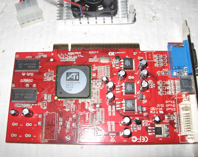

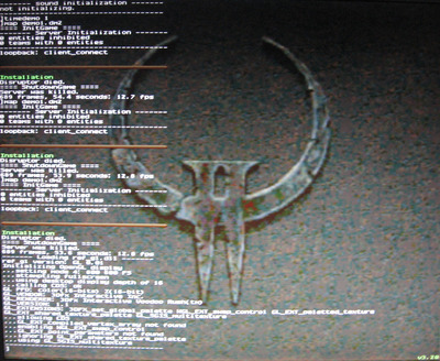

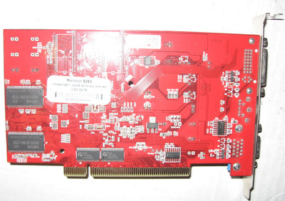

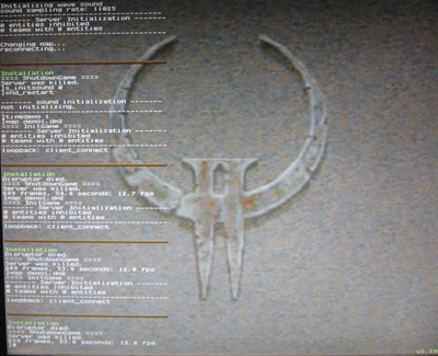

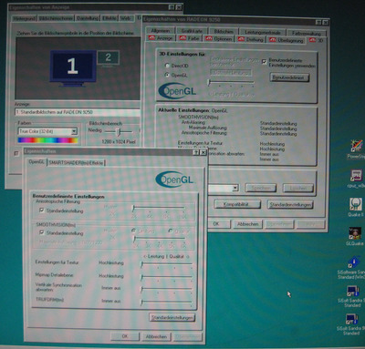

2. RADEON-VGA
Yes, a Radeon 9250 can work with this board, too. This is the only Radeon-VGA I have at this time for testing.
Catalyst 4.3, 4.7, 5.2, and Omega 2.6.29 could be installed.
With Catalyst 4.3 and 5.2, more than one loop in Quake I are possible.
With Catalyst 4.7 and Omega 2.6.29, there is a full freeze of the 3D-picture in Quake I at the first or second loop. Sometimes in 2D the picture disappears complete (black screen). Reducing the LDEV# Sampling Point from1 to 2 in BIOS does not help.
The pictures attached are from Catalyst 5.2
The FPS in Quake I and Quake II are for all drivers more or less very similar (+/- 0,2 FPS, a little better with Omega): Quake I: 15,7 FPS, Quake II: 10,8 FPS.
So the performance is much lower compared to the Geforce 2 MX-400 from above.
All test are done without L2-cache (empty sockets), but there is no difference to the Geforce-tests above (because they are done with inactive L2-cache, too).
Maybe I will try Windows 2000 (to be honest I do not like it for a retro-system) the next days, if I found some time.
Just for reference – are they some other 486-systems running a R9250, and are they any Quake-results?

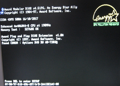

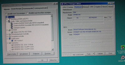

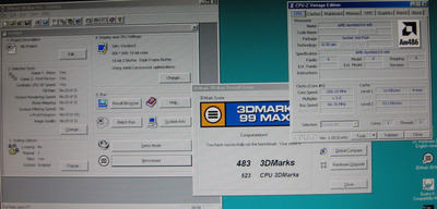

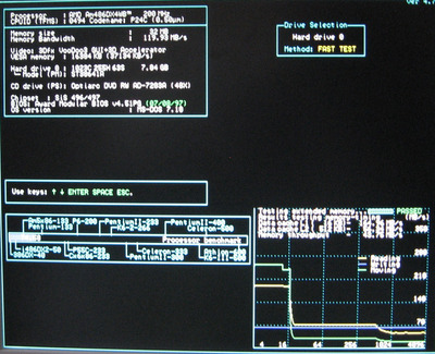

Reply 2096 of 2521, by gonzo

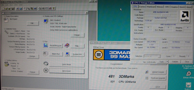

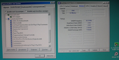

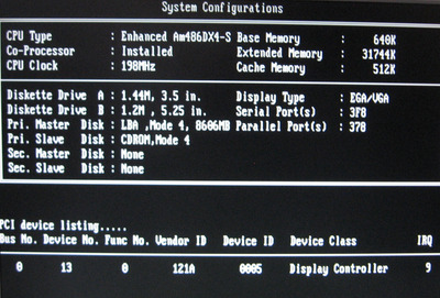

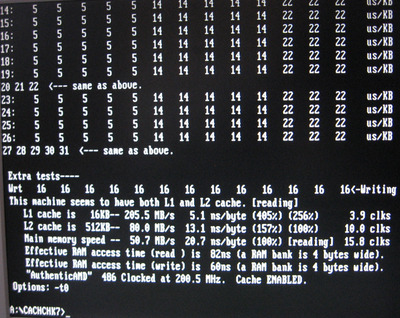

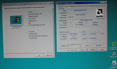

BINGO NUMBER 2!

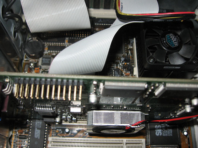

Today I dig out another PC of mine with a rock-stable 486-board with SiS-496-chipset (Zida 4DPS Rev. 1.0), shown and explaned well in this thread: Modern graphics on a 486
And it works with the AMD-486 @ 200 MHz/5V at FSB 66 MHz rock-stable and excellent!
No one hang-up, no one freeze, no one performance-drop of the CPU in Windows (as this was the case until now at FSB 60, too)! As in case of the SYL8888-board, the northbridge of this board is made in 1997,too. Maybe this is the only important thing for stability in both cases, I don‘t know...
I had only to change the installed stable-running AMD-486--CPU @ 180 MHz/5V with the above CPU, and to adjust the DRAM CAS Precharge Time in BIOS from 1 (for FSB 60) to 2 (now FSB 66). That‘s all!
For a CPU-frequence of 200 MHz, compared to the SYL8888-board without L2 at FSB 50 it can be seen, that this system does not take a big advantage from the 66-MHz-FSB, at least not using L2-cache at 3-2-3 (sadly, faster timings lead to system-crach during the booting, so the modules installed here are the limitating factor in this case).

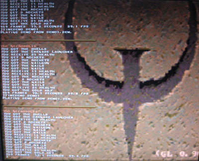

And, it can be seen, that the Voodoo 3-2000 used with the SiS-chipset is not faster in Quake compared to the GeForce 2 MX-400 with the UMC-8881-chipset (maybe faster or no L2-cache on the Zida-board can do something better here).
Therefore, in the nest steps I will try to run the Zida-system:
- without L2-cache
- with L2-cache at better/faster timings, if I can found some appropriate chips
Other results in DOS (no pictures):
Quake I: 20, 7 FPS
DOOM (demo 3): 73,51 FPS (1016 realtics)
3Dbench 1.0c: 101.5
PCPbench /VGAMODE: 28,9
BTW, I was not able to run the Zida-board stable with more than 32 MB of RAM (as the 512 KB of L2 suggest using of 64 MB, too).
