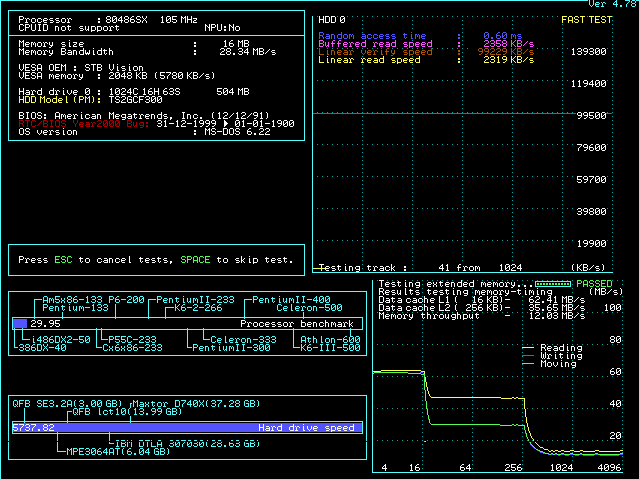

Reply 2315 of 2476, by feipoa
Following pshipkov's lusty reporting on the SIIG i540 and Advansys ABP-5140 ISA SCSI controllers, I decided I would test them for myself. I'm using a PEM-4036YB motherboard with an 85 MHz crystal oscillator. The first thing I noticed was how my SIIG card came with a 40 MHz crystal osc, while the ABP-5140 has a 50 MHz crystal osc. That is strange. The photos provided by pshipkov show both cards having a 50 MHz crystal.
My ISA is at 10.6 MHz, unless specified otherwise.
I ran some Coretest baseline measurements:
AHA-1522B in coretest: 3870 kb/s
AHA-1542CP: 2899 kb/s (5 mb/s DMA)
AHA-1542CP: 3713 kb/s (6.7 mb/s DMA). 8mb/s hard hangup.

Reply 2318 of 2476, by pshipkov
Ran a quick test.
DTK PEM-4036YB
Default bios settings (F6)
66mhz crystal
Cyrix.exe -i1 -i2 -m, no clock doubling
Win3.1 no SIIG driver, dos 6.22
These most conservative parameters should be very easy to match on your side.
retro bits and bytes | DOS media library
