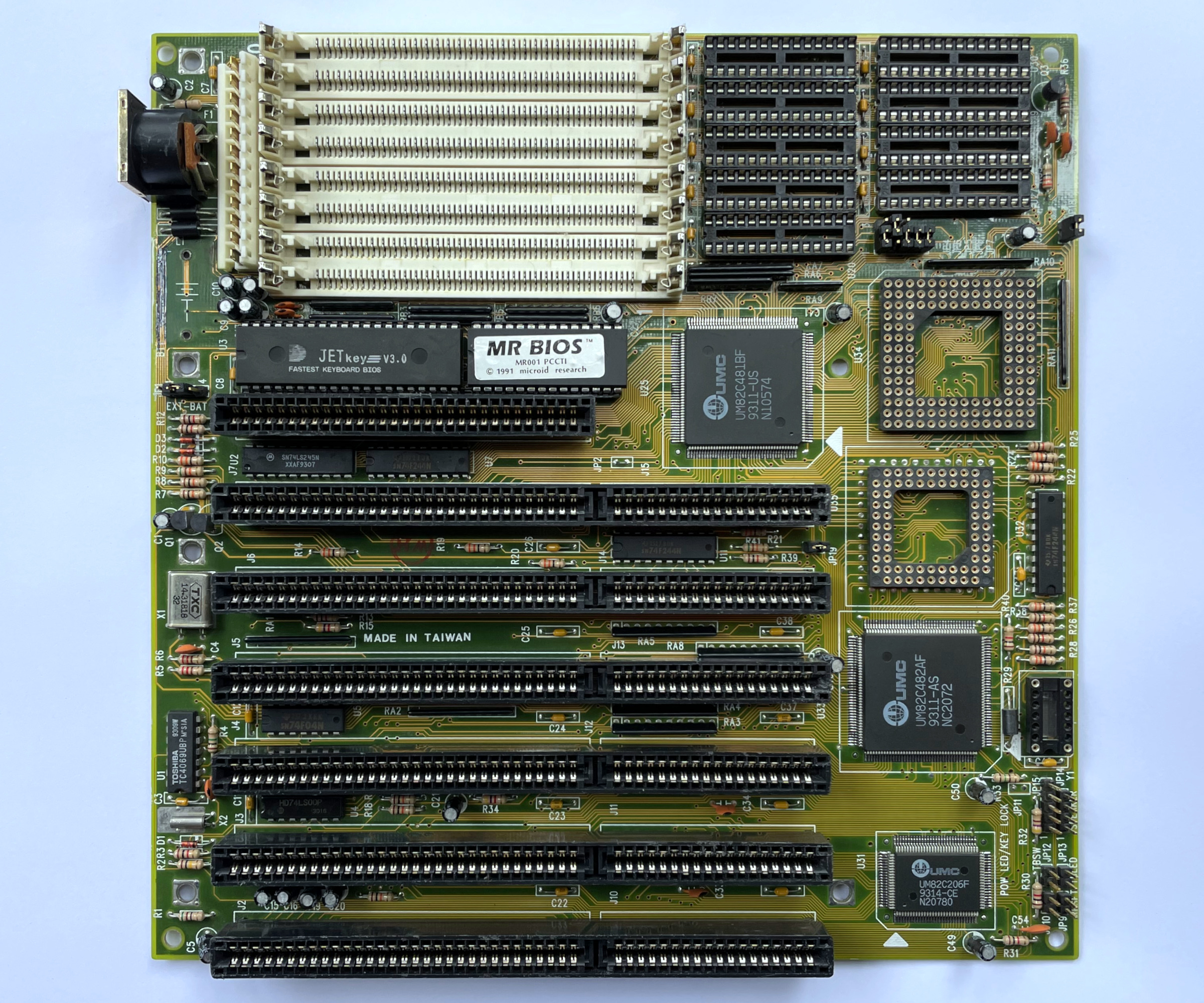

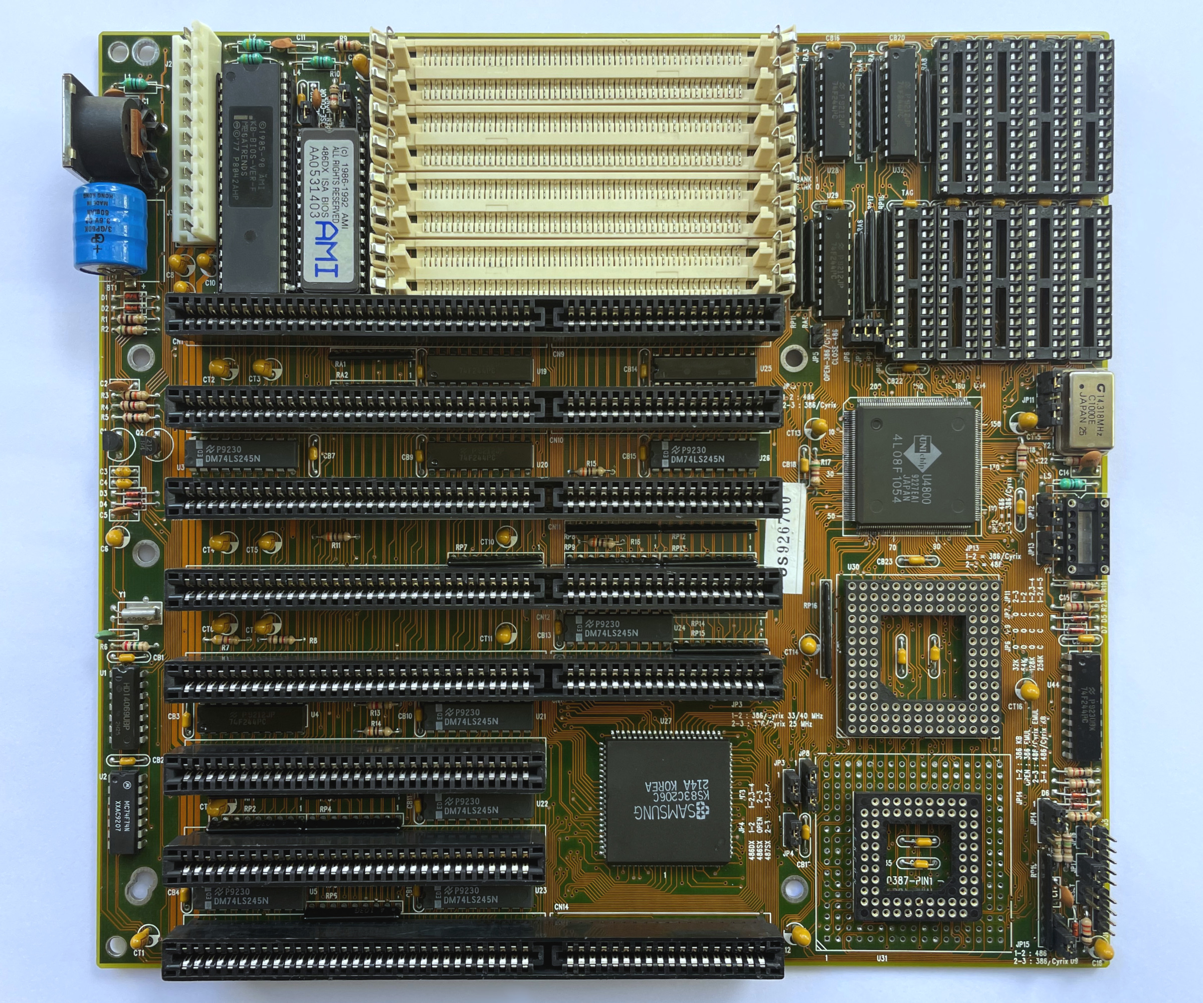

Several 386 motherboards based on Unichip U4800 passed through here, but none of them was worth talking about.
They were those compact PCBs with 128Kb level 2 cache only, clock generators limited to 80MHz (40MHz FSB) and very slow BIOS microcodes.
Finally managed to obtain a motherboard with the right characteristics.
Target Micro Typhoon 486-386/ISA based on Unichip U4800 chipset - a hybrid 386/486 assembly.
Had no idea what to expect from it, so curiosity was significant.
Unfortunately it came dead. Or so i thought.
The drama started with me inserting an 80MHz crystal and trusted CPU, RAM, VGA.
Hard no lights.
But i was desperate to get this guy up and running. Such boards with this chipset are extremely rare. Unlikely i will be able to find another.
Probed all over the place with multimeter and oscilloscope - everything came out clean and as expected.
Went over jumper settings countless times. Tried any other configurations, including random ones.
Desperation gradually ramped up. More and more invasive methods for reanimation were applied.
Endless swapping of components, reflowing joints, pins, pads. Bending.
Twice baked in the oven.
Heating with hot air gun sections of the PCB - blindly trying to fix eventual cold joints
At some point legs of the main IC started separating from the pads underneath. This resulted in even more soldering work around them.
4 level 2 cache sockets completely melted.
And so on.
Eventually i gave up and threw the motherboard in the pile of broken components.
2 weeks later i impulsively grabbed it, put it back on the test bench, inserted a 66MHz oscillator - it lit up right away and booted to DOS.
My jaw was on the floor.
Inserted an 80MHz oscillator - hard no lights.
No lights with 70, 80, 90, 100.
But worked right away with 110MHz one.
What the heck.
Over time, don't ask me how i arrived at it, i realized that with 70-100MHz crystals i must switch JP3 from 1-2 to 2-3 or back during POST.
Despite this nasty quirk i felt very guilty for all the abuse this motherboard went through for no reason.
The really surprising thing is that the PCB survived my Emergency Room, but hey, i take it.
With all the drama behind us (me and the board) i spent good time to heal it properly and finally moved onto testing it.

Unknown brand/model, based on UMC UM82C482AF, UM82C481BF, UM82C206F chipset.
As mentioned above, couple of boards based on this chipset passed through here and one of them (Elitegroup US 3486) showed sign of real potential, but didnt scale well past the 45MHz.
This unknown motherboard seemed to have the bones to show what UMC 481/2 is capable of, so decided to give it a spin.
Old battery leak damaged 5-6 rails in the upper left corner.
That was fixed promptly. System lit-up right away with the fixes in place.
The assembly was no drama at all. Stuff just works. Nothing more to add really.
For testing used STB Nitro graphics card (Cirrus Logic GD-5434) and standard IDE controller (UMC chipset), 256Kb level 2 cache, 16Mb 50ns RAM (4x4).
--- IBM BL3 at 110MHz (2x55), ISA bus at 13.75MHz
System cannot be fully stable, especially with FPU present, regardless of BIOS settings, even the most conservative configuration.
It was established in previous posts that no 387 grade FPUs scale past the 50MHz (natively, meaning - no clock doubling).
Things are ok in DOS only. Captured few numbers with DOS interactive graphics tests:
Wolf3D: 66.8 fps
Superscape: 50 fps
Doom: 26.5 fps
Not bad at all really, but that's pretty much it.

benchmark results
Look for "Unknown UM82C482".
One of the best 386 class motherboard based on the UMC 82C481/82C482 chipset that i have seen so far.
But this statement applies only when BL3 processors in use.
Performance is impressive with that processor, even at “mere” 90MHz (2x45):
- number 2 in PC Player Benchmark
- number 1 in Quake 1, along with DTK PEM-4036Y
- number 3 in the complex offline graphics tests
But looking at the 386DX tests, there is a chance that Elitegroup US 3486 is actually the better system. Unfortunately i sold that Elitegroup mobo before gained access to SXL2 and BL3 CPUs, so this is only a presumption at this point.
