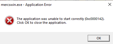

Reply 372 of 563, by Khoidoan1@hotmail.co
Windows update must have broken something because I keep getting
Getthreadcontext error = 5
Reply 373 of 563, by Khoidoan1@hotmail.co
As additional information. I get the error everytime I try to run Dxwnd and launch the mercswin.exe. It doesn't seem to matter what version of Dxwnd is used.

Reply 375 of 563, by Khoidoan1@hotmail.co
BEEN_Nath_58 wrote on 2024-12-14, 21:08:
Khoidoan1@hotmail.co wrote on 2024-12-14, 18:45:
Try running the game without DxWnd and let me know if you get a 0xc000005 error
I get some other kind of error running it without dxwnd
Reply 376 of 563, by BEEN_Nath_58
Khoidoan1@hotmail.co wrote on 2024-12-15, 03:01:
https://cdn.imgchest.com/files/4z9cvqrk667.png […]
Yes that's what I meant. This is an error, which comes from what's on your computer and not the game. Previously, some game gave me this error upon having the Logitech Control Panel, since which I never had the issue. Unfortunately I can't control or comment on what error is causing this
Reply 377 of 563, by Khoidoan1@hotmail.co
BEEN_Nath_58 wrote on 2024-12-15, 05:37:
I have no clue. I haven't installed anything new. Only thing that's happened is windows updates

There is a very little I can control from Windows updates, since it is not reproducible either. Another user here tried MechVM to launch the game in the same fashion, but failed
myne wrote on 2024-12-15, 07:16:
I think someone has to figure out dxwnd properly.
I'm puzzled because I played it through a year ago without these issues.
Windows break something?
Its not a dxwnd bug if the error isn't coming from here.
