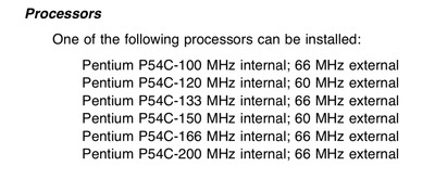

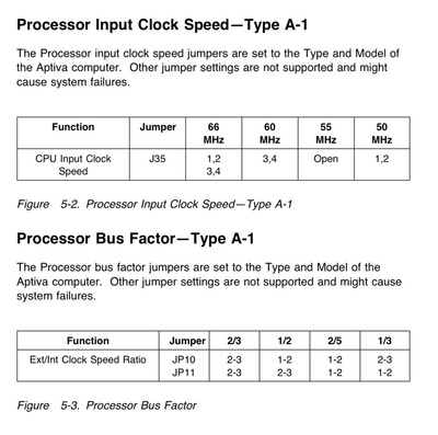

It is an aptiva 2144-351 (SL-A), chipset 5511/12/13 with integrated vga SIS5598, sorry, i was pretty convinced that i already wrote this.
Jumper jp10 and jumper jp11 in positions 1-2 supossedly set the cpu to 150mhz, but i think jp10 must be 2-3, i need confirmation. I'm searching some, if i find it i will post it here.

I can't find it in this link, but i have seen this here. Supossedly i should can have a pentium 200 in this computer, but...
P.D: jumpers are all rigth placed.
file.php?id=86480&mode=view
Reply 49 of 165, by dionb
Señor Ventura wrote on 2025-12-11, 01:49:
You already wrote 5511/12/13 with integrated vga SIS5598 and we already concluded that was incorrect...
Is this the board? https://theretroweb.com/motherboards/s/ecs-si … 8p-vio-rev-1-0b
It certainly seems to correspond to the diagram you posted and the other specs. And clearly shows you have a SiS5511/12/13 with SiS6205 chip in UMA, as we had already discovered earlier. No 5598...
Jumper jp10 and jumper jp11 in positions 1-2 supossedly set the cpu to 150mhz, but i think jp10 must be 2-3, i need confirmation […]
According to that documentation JP10 and JP11 gives a 2/5 ratio, i.e. a 2.5x multiplier, so if the bus is set to 60MHz, you get 2.5x60=150MHz. So that's correct.
Señor Ventura wrote on 2025-12-11, 15:14:
What do you call "rigth placed"? Please be clear:
- which position(s) is J35 in?
- which position(s) are JP10 and JP11 in?
A P200 should be configured with 3.0x66MHz. According to the documentation you posted there, that means J35 should have both 1-2 and 3-4 jumpered to give 66MHz bus speed; JP10 should be set to 2-3 and JP11 to 1-2 to select 3.0x multiplier (or as IBM has listed it, 1/3 ratio).
If this is not stable, the first place to look is the RAM. 66MHz FSB requires 60ns EDO or FP DRAM. 70ns RAM sometimes runs OK but sometimes doesn't. What is yours? (look at the chips on your SIMMs, the identifying line will usually end with -6 or -7, if -6 it's 60ns, if -7 it's 70ns)
Another thing to check is the BIOS version. You say the CPU speed isn't reported correctly. That could indicate the BIOS is older than your CPU. The Pentium 200 was released in June 1996. On TheRetroWeb two BIOS versions are listed, with the older being from the summer of 1996 and the newer from early 1997. It might be worth upgrading to the latter if you're not already running BFLUK4L.

dionb wrote on 2025-12-11, 16:26:
All this time i thought never was a third jumper, so the fourth conmutation was driving me to think that it was "auto detecting mode" or something like this, but now i see that setting up to "P150" enters into conflict with "j35" jumper, which is not near of "JP10" and "JP11".
I meant the douglar's commet about if i putted wrong some jumper, and all are well contected.
Jumpers are:
-JP10 (2-3)
-JP11 (1-2)
-J35 i don't know if reading "same oriented" as JP10 and 11, or in the same orientation as its name (J35).
I almost there, then... the only thing right now is how to consider the pin positions 1, 2, 3, 4 of J35 (from up to down, or from left to right).

Reply 53 of 165, by bertrammatrix
Looks like you just have to put the one jumper on jp35. 3&4 are already connected 1 &2 is all that is left to connect for 66 and you should be good to go
You don't have to worry about setting the multiplier "too high" - it is always locked upwards on Pentium cpus, meaning you can always set a lower multiplier of choice, but anything higher then the chip supports will have no effect
Reply 54 of 165, by Señor Ventura
bertrammatrix wrote on 2025-12-11, 18:28:
So, i only have to connect the one wich is alone to the unused pin, not changing positions, or whatever.
I was so lost... j35 was hide under 3 boards near the riser ^^u
Thanks to all!
Reply 55 of 165, by dionb
Also, there is no higher multiplier than 3x for P54C, so you couldn't set an unlocked Pentium non-MMX higher regardless
