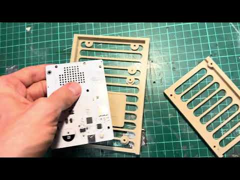

Reply 69 of 82, by MaverickUK
Thanks to everyone who has completed the beta testing survey form, I shall be in touch during August or September
Part of the beta test will involve providing people with 3.5"/2.5" drive bay mounts, to ensure they work as intended
Watch demonstration of HDD Synth drive bay mounts
The 3.5" version has a space to fit an optional larger speaker, if you really want to have a loud HDD!

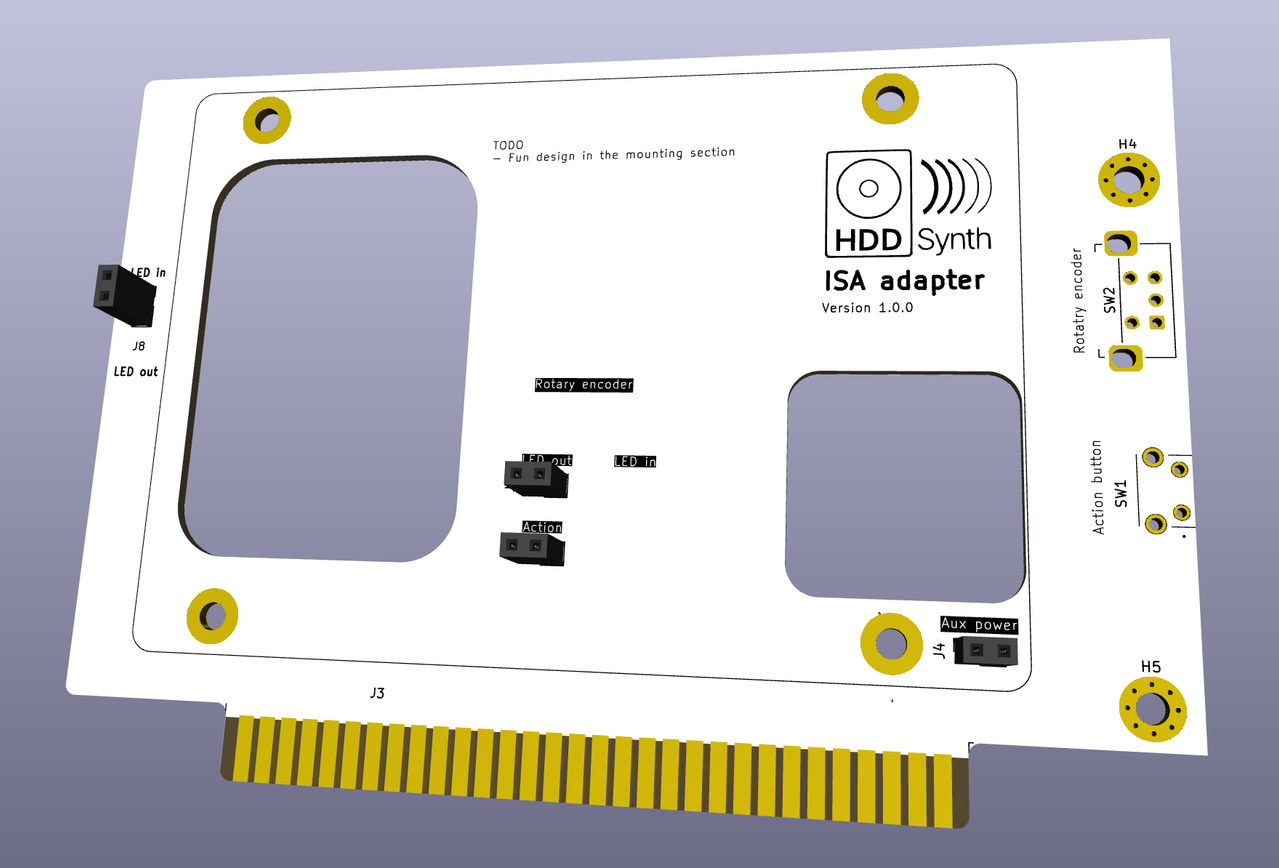

I'm also going to create a prototype ISA & PCI adapter card slot which will supply power to the card and provide physical controls out the back. Mainly because I really like having some physical controls! 😀

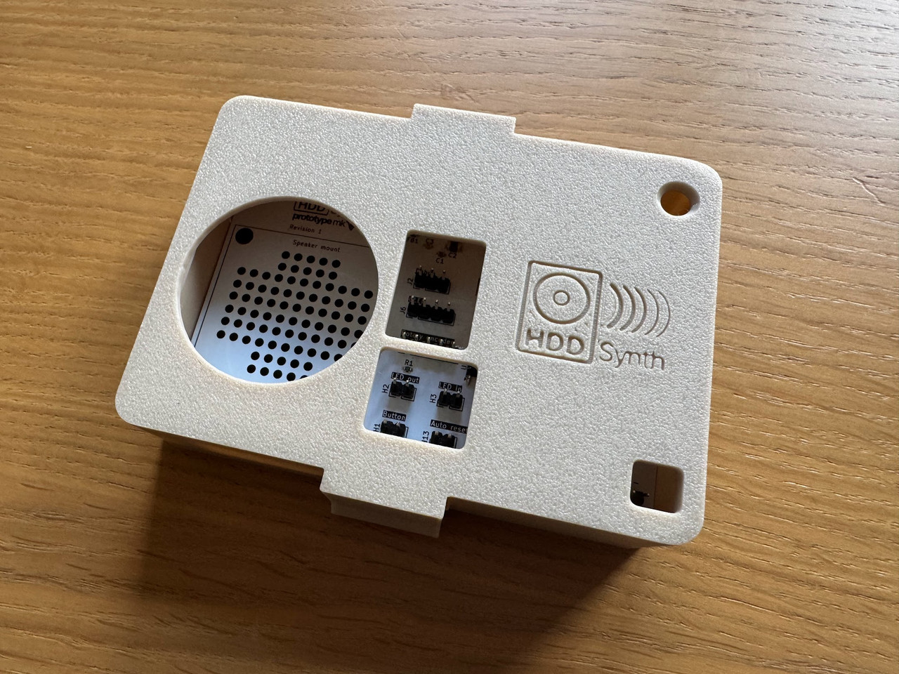

Also prototyped is a case that enables the HDD Synth to be used externally in a more attractive way or allows the device to be safely put into a computer, which worry about short circuts
Finally a early version of the ISA adapter. The HDD Synth connects to this using it's male header which then slot into the female headers on this board. It provides controls via the back panel and extends the LED headers for easy access. Creating PCI, Zorro and other adapters is just a case of changing out the slot in the design.

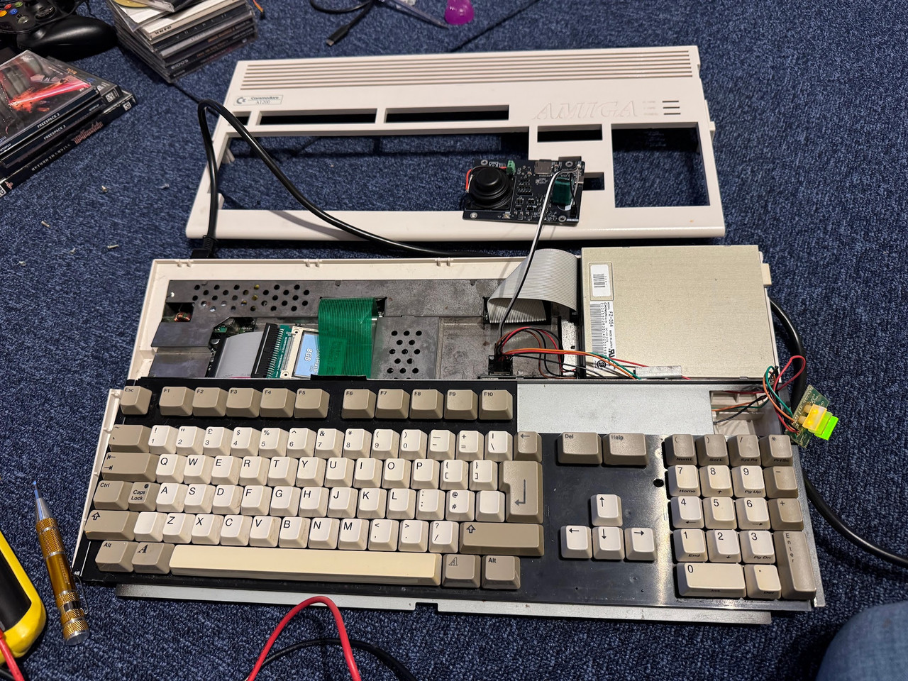

Reply 74 of 82, by MaverickUK
Ahead of sending the HDD Synth to beta testers I was checking it in my Amiga 1200. Unfortunately it didn't survive this experience, so I'm doing some additional investigation to determine the reason. I'm using a modern PSU with stable lines with my 1200, so more likely to be due to power complications caused by the 1200 itself being in the equation.
This will result in another revision of the board to add an eFuse whilst also improving the super cap charging/discharge circuit to use an IC rather than the current basic design. I'm also wanting to improve the regulators that will improve the spin down time, for anyone wanting a really long spin down 😁

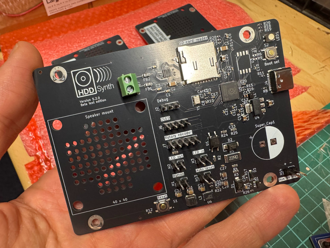

Reply 75 of 82, by MaverickUK
The beta testing board is ready !
I will be emailing the selected beta testers today to offer them an oppotunity to beta test the device, before it goes into production which would ideally let it be available for Christmas 2026.
YouTube video of the beta test version
I've also updated the project website with accurate information and new photos
