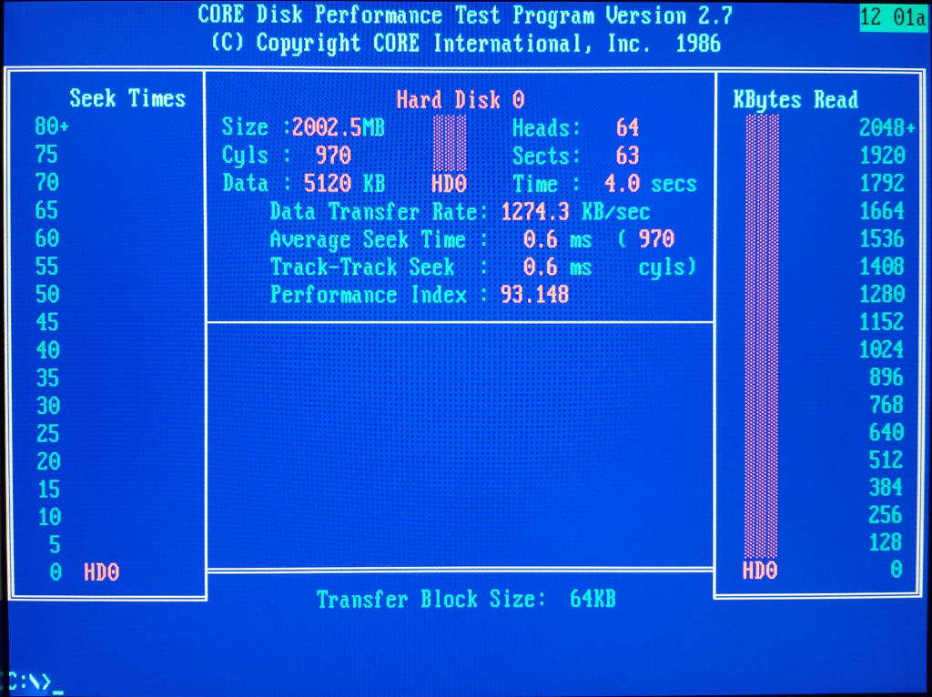

Reply 988 of 2351, by pshipkov
Shared in previous posts about that XT PC that i have been slowly setting up - here and here.
Finished the job recently.
Pretty satisfied with the outcome.
Figured i should share the result.
As mentioned in the linked above posts - Tandy 1000 SL is used as the basis of the rig.
Had to overcome the initial resistance to use branded assembly because they are weird, but Tandys are actually pretty ok - they have good bones and only thin layer of "stain" on top.
Initially it was supposed to be more of a Tandy flavored setup but that didn't bode well with my aspiration for top performance, so things quickly resolved into an XT - or better - an XT BEAST.
Still thinking how to name the contraption.
Maybe XTandy or perhaps Mandy - for Modern Tandy ...
--- Assembly
base: Tandy 1000 SL
cpu: 16MHz rated NEC V30 HL
fpu: 10Mhz rated Intel 8087
ram: 640Kb 80ns rated Hynix
vga: Western Digital WD90C00-JK 512Kb / Tandy video adapter
hdd: XT-CF-lite rev.2 + 2Gb CF card
sound: ESS 1868F + SC-88 Pro MIDI brick / Tandy sound system
modem: unknown brand - discarded, read below
ram card: Acculogic RAMpAT! - discarded, read below
keyboard: Tandy XT
mouse: MS 2 button COM1
joystick: Tandy (2 axis, 1 button) + adapter
OS: DOS 6.22 (started with DOS 4.01, but 6.22 has smaller memory footprint)

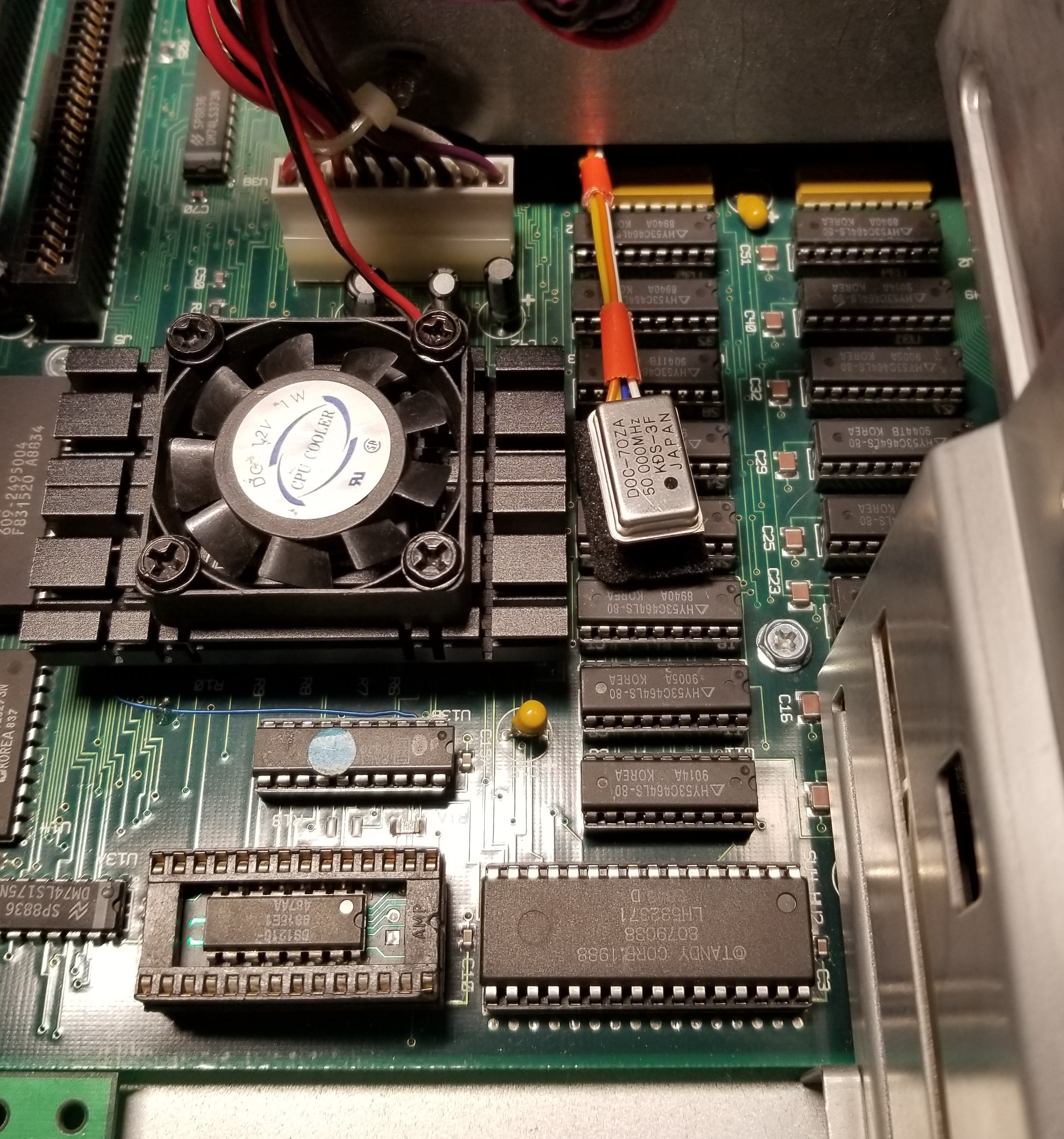

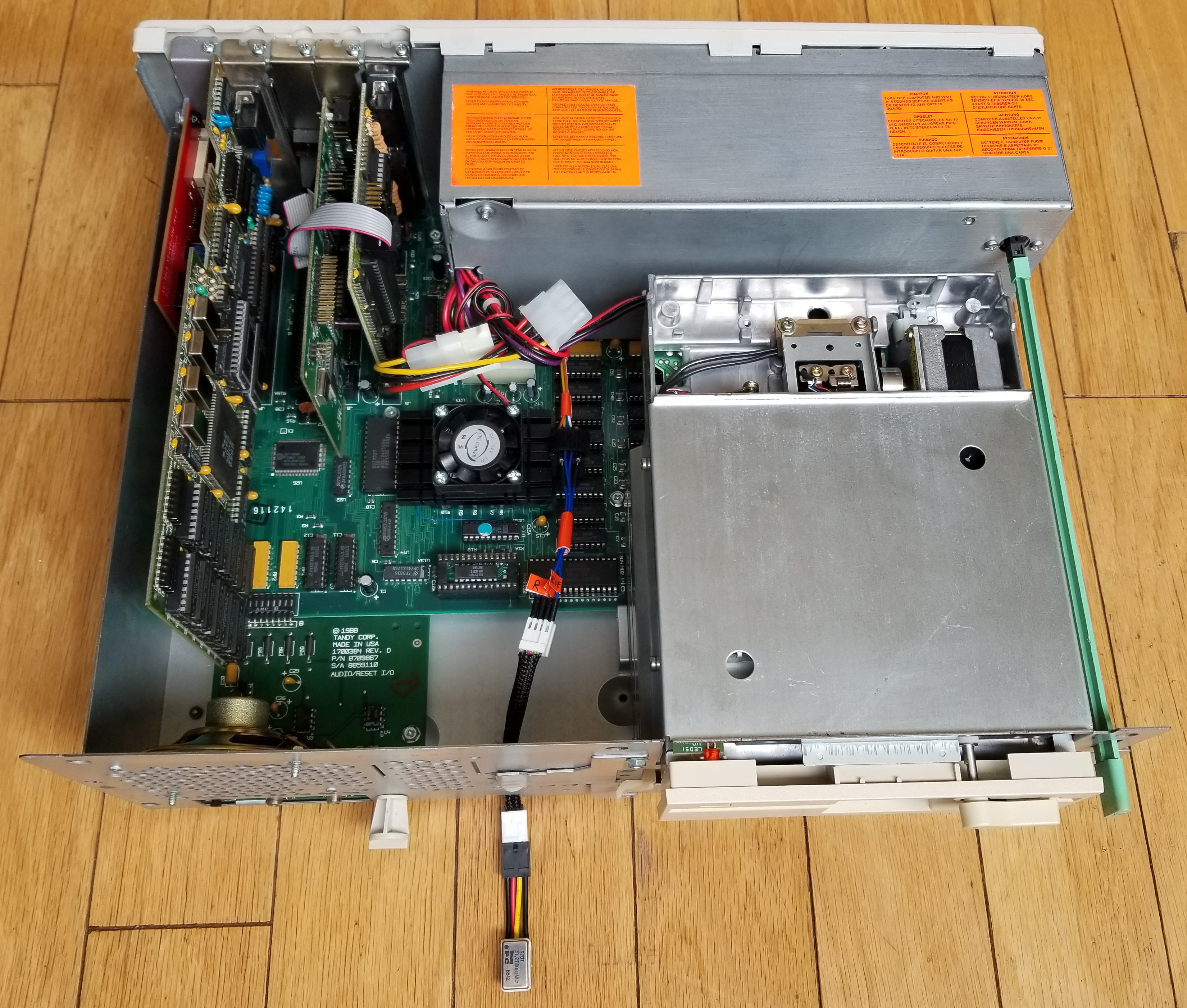

Assembly on the inside:
FPU gets quite hot.
Decided to slap heatsink + fan. Just in case.
CPU got coverage too.

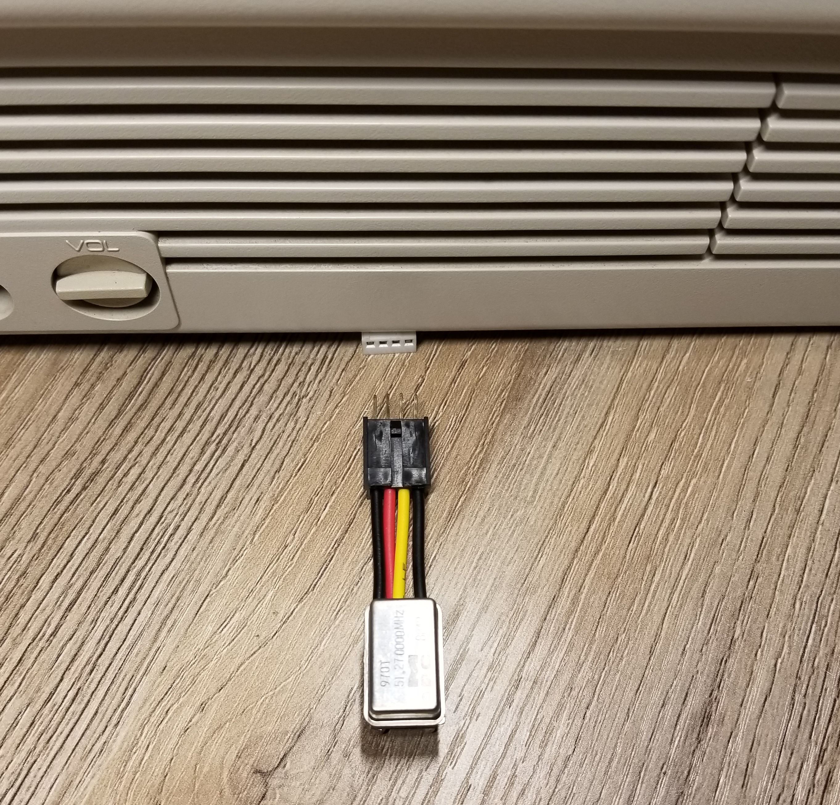

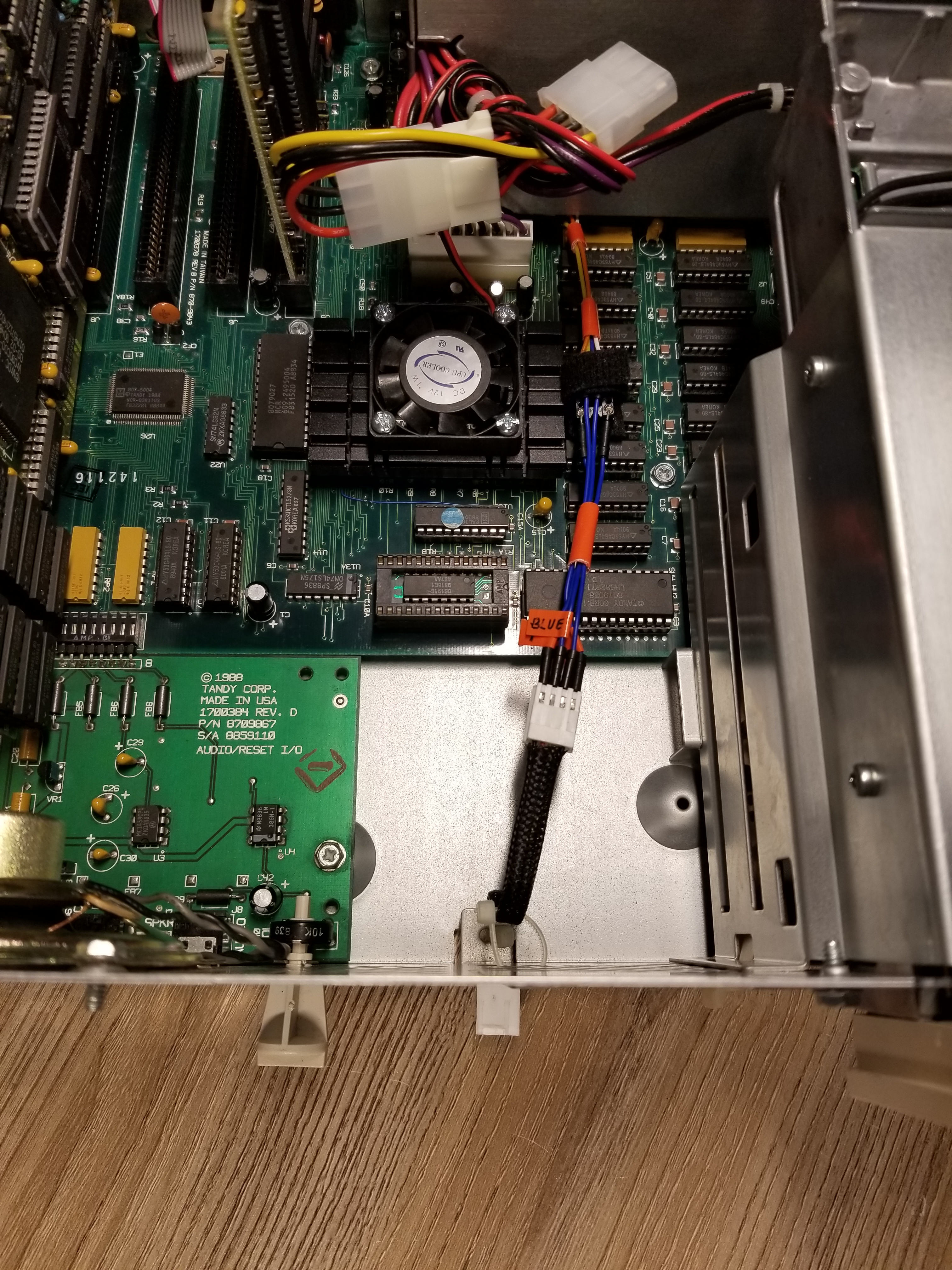

Crystal oscillator is located under the PSU module which makes it inaccessible - a deal breaker for overclocking.
Solution in 2 stages.
First is a small non-intrusive contraption for easy access inside the case:
Extension of it for external access.
Modular - velcro piece holds a second oscillator socket that plugs into the base one.
Easy to add/remove if needed.
Shows up outside discreetly under the front panel without preventing the case to be opened by pulling the front panel - slash - cover.
The external oscillator module (socketed).

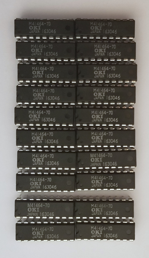

Started with 120ns rated chips that couldn't overclock very well.
Moved to 80ns Hynix, but knew that there are 70ns rated chips of the same type as well.
Not far ago tried to switch to 70ns OKI, but surprisingly they don't scale as well as the Hynix ones.
After a lot of testing went back to 80ns Hynix.

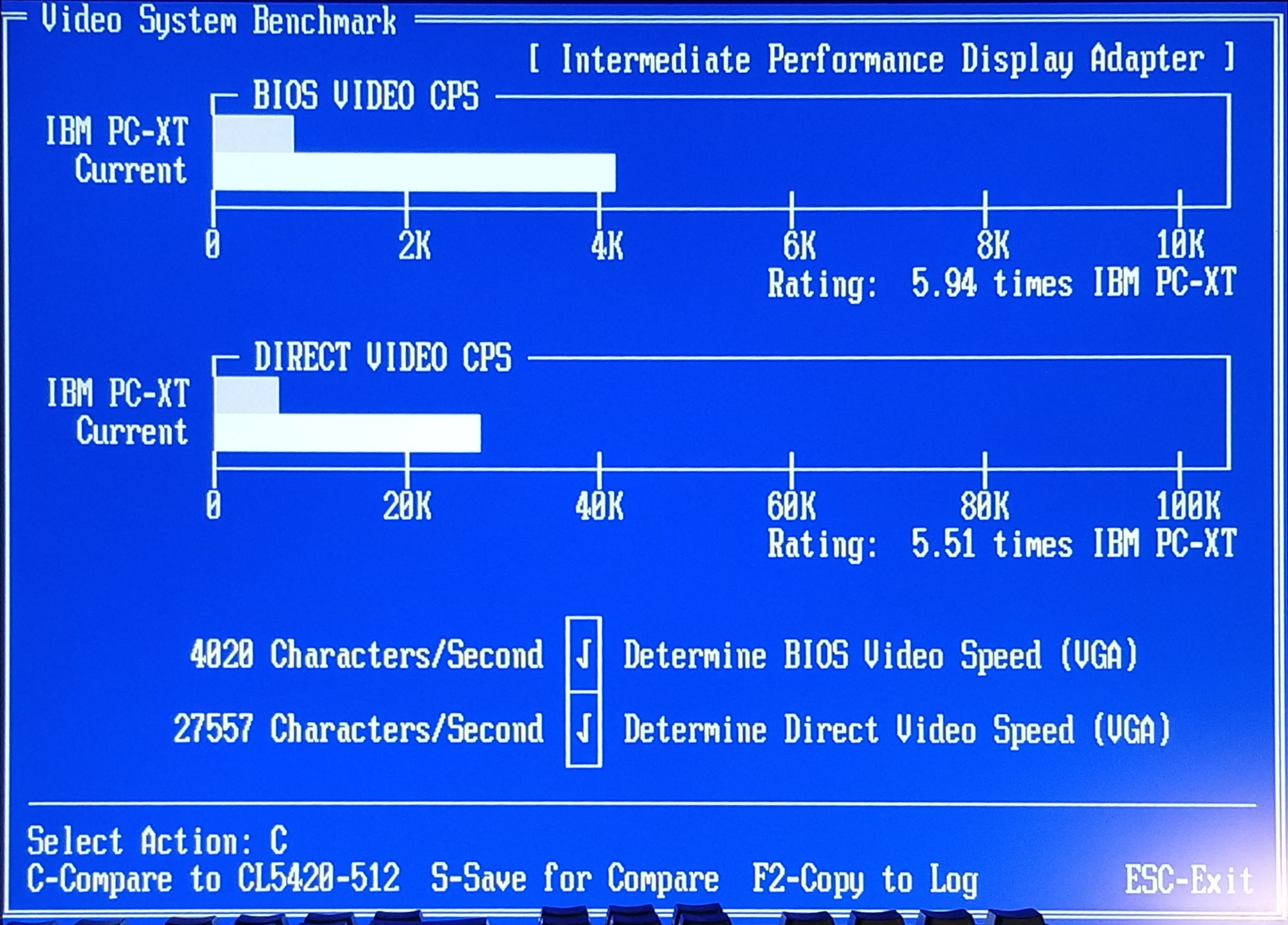

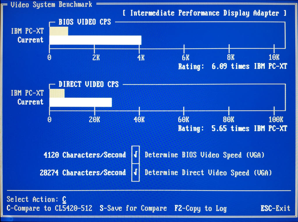

Tandy video adapter is cool and everything but lets be real - VGA is cooler.
Started with latest revision Diamond SpeedSTAR 24 as it is one of the fastest things for 16-bit ISA but had a nagging feeling that i should not be so confident in it for the 8-bits.
Tested over 30 ISA graphics cards. Most of them listed one way or another in previous posts.
Turns out the fastest thing for XT machines is Western Digital WD90C00-JK 512Kb with close second Diamond Flower VG-1000 rev.2.
The Diamond SpeedSTAR 24 and other fast cards didn't do that well - apparently they moved on and focused on 286/386 class hardware.

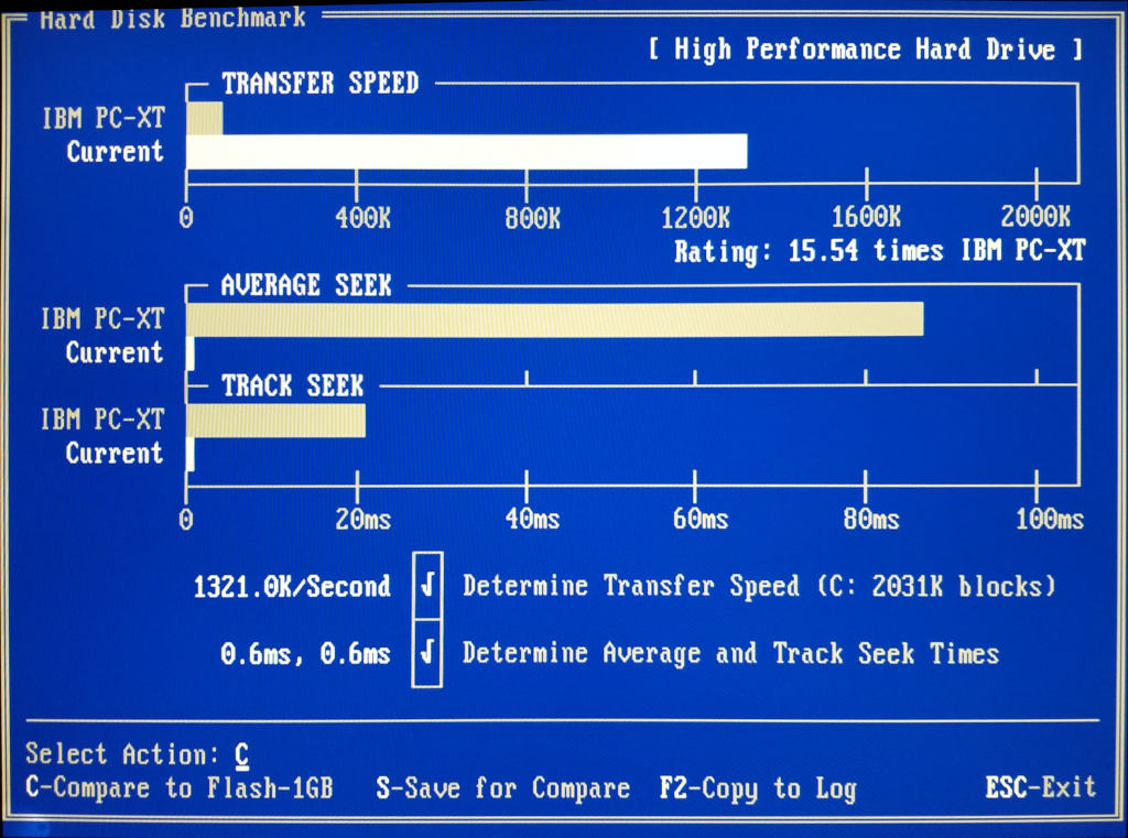

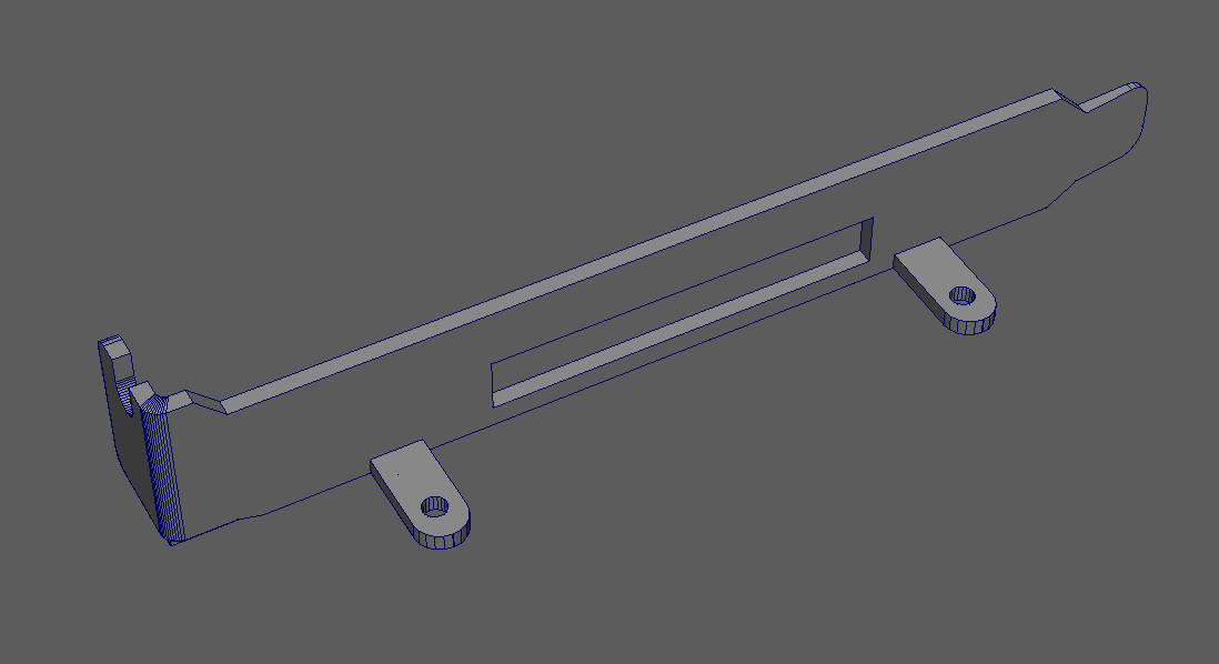

Lo-tech XT-CF-lite rev.2:
with custom 3D printed bracket:

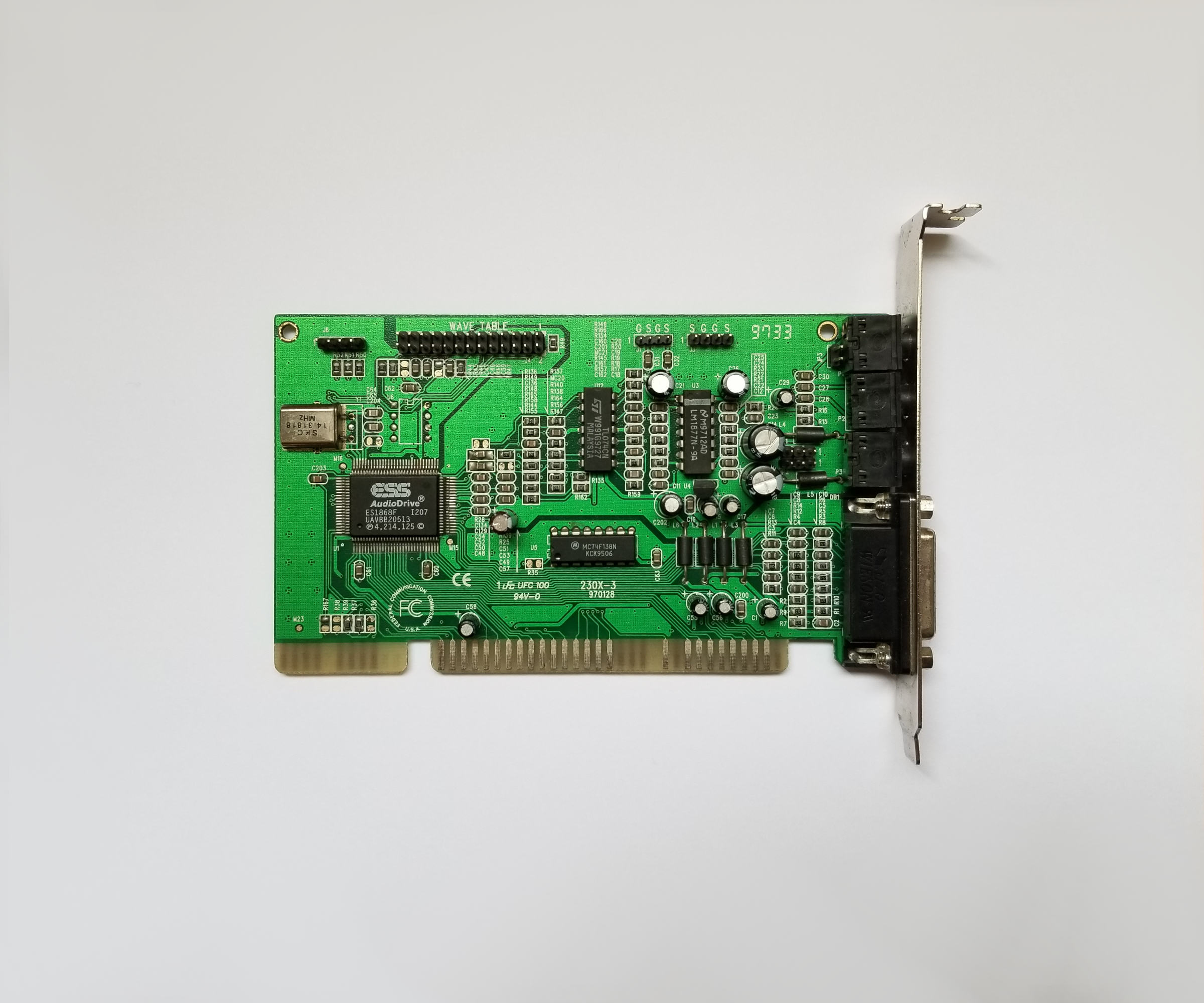

Tandy has a cool buzzer (for its time) but more appropriate sound option is needed as well - ES1868F.
Actually thinking to swap the ES1868 with TexElec's SAAYM/GameBlaster clone, or maybe Snark Barker.

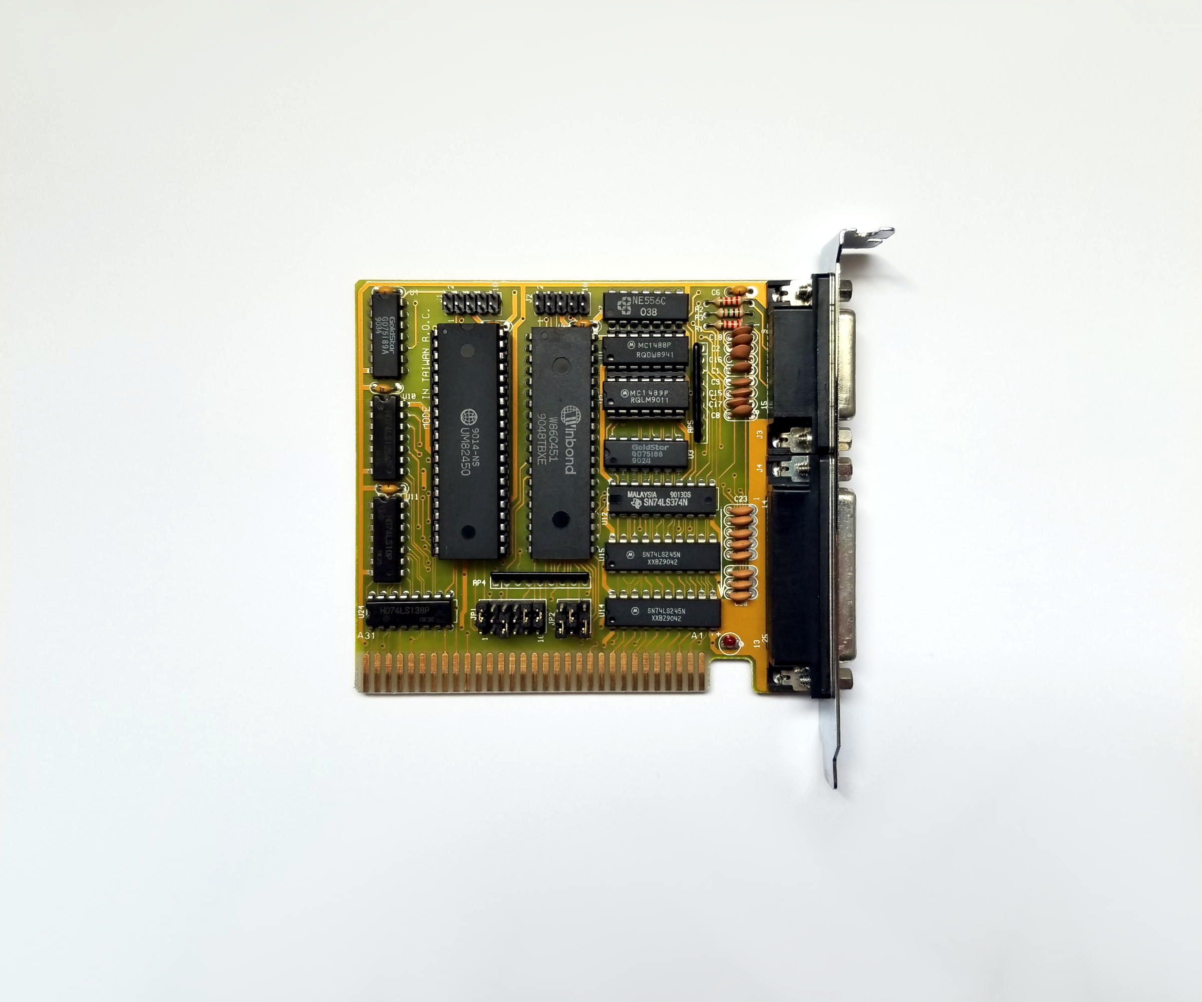

Unnamed COM/LPT card:

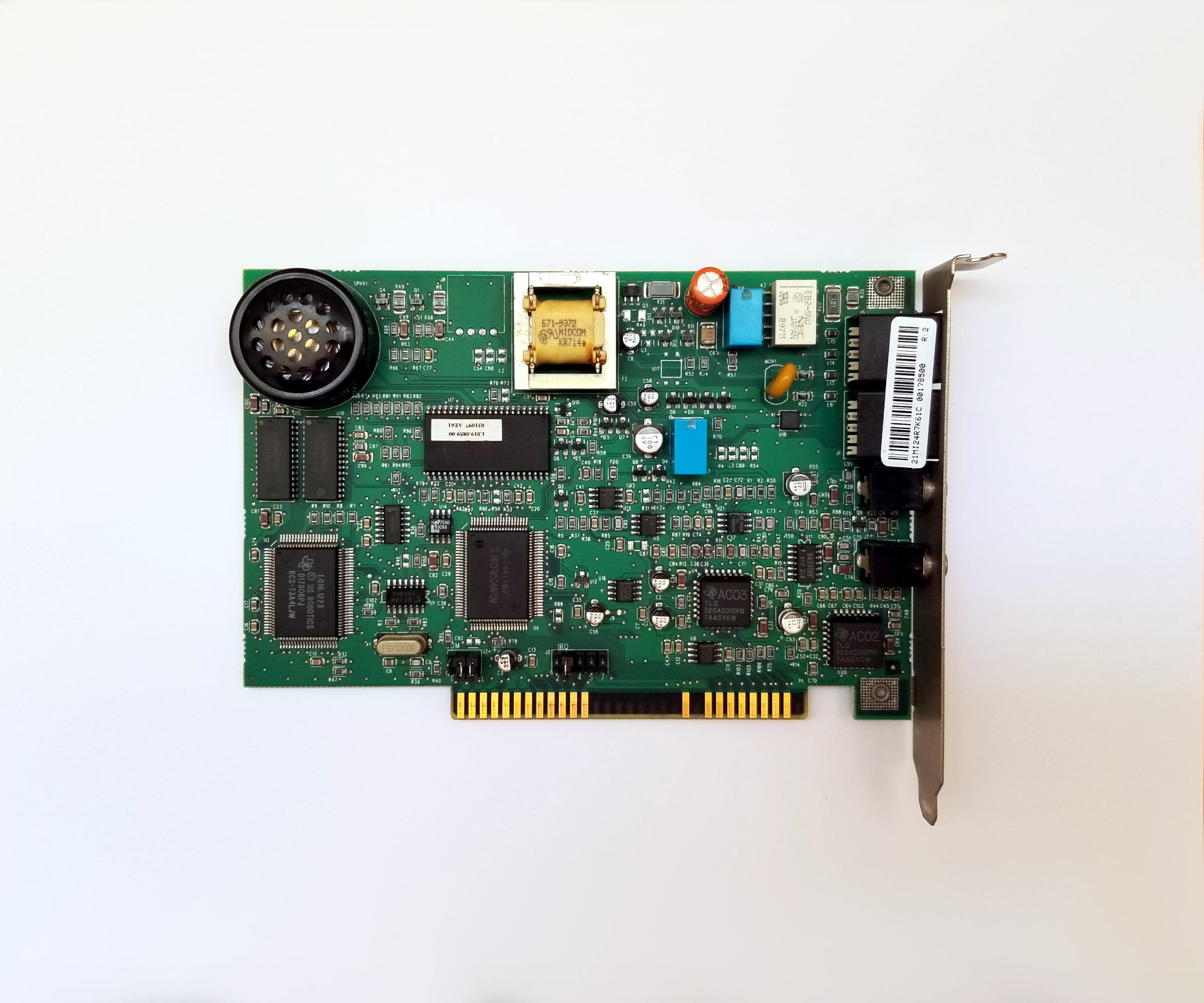

Plan was to fill it with modem card like the one below, but that was not meant to be. Which is ok - it is not like i have a land phone line anyway.

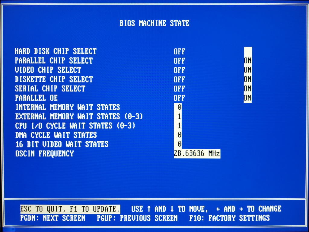

--- BIOS setup
Used Tandy's setupsl.com with /A parameter for advanced settings.
Disabled DeskMate - that desktop makes no sense to me.
Booting instead from XT-IDE into MS-DOS.
All BIOS settings on max except two parameters.
They need to be set to 1 otherwise BOOT to MS-DOS does not complete every time and there is graphics corruption.
Thought it is memory related but after enough go-rounds with different chips and other components i am pretty sure it is a chipset limitation.

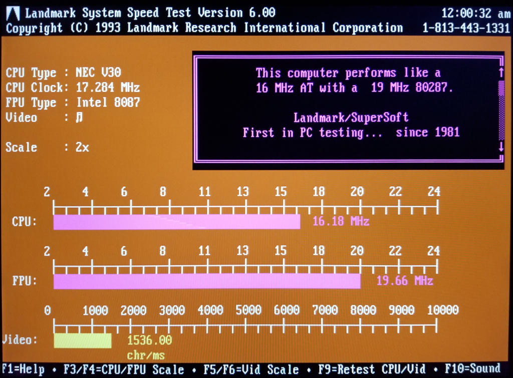

--- Performance

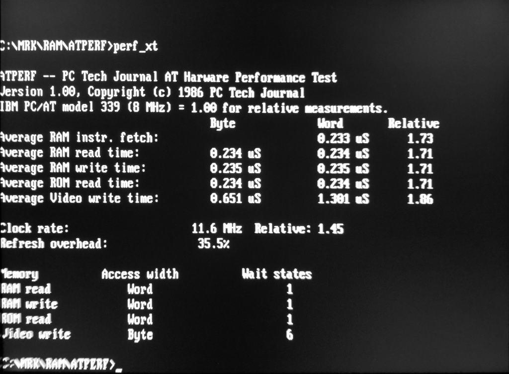

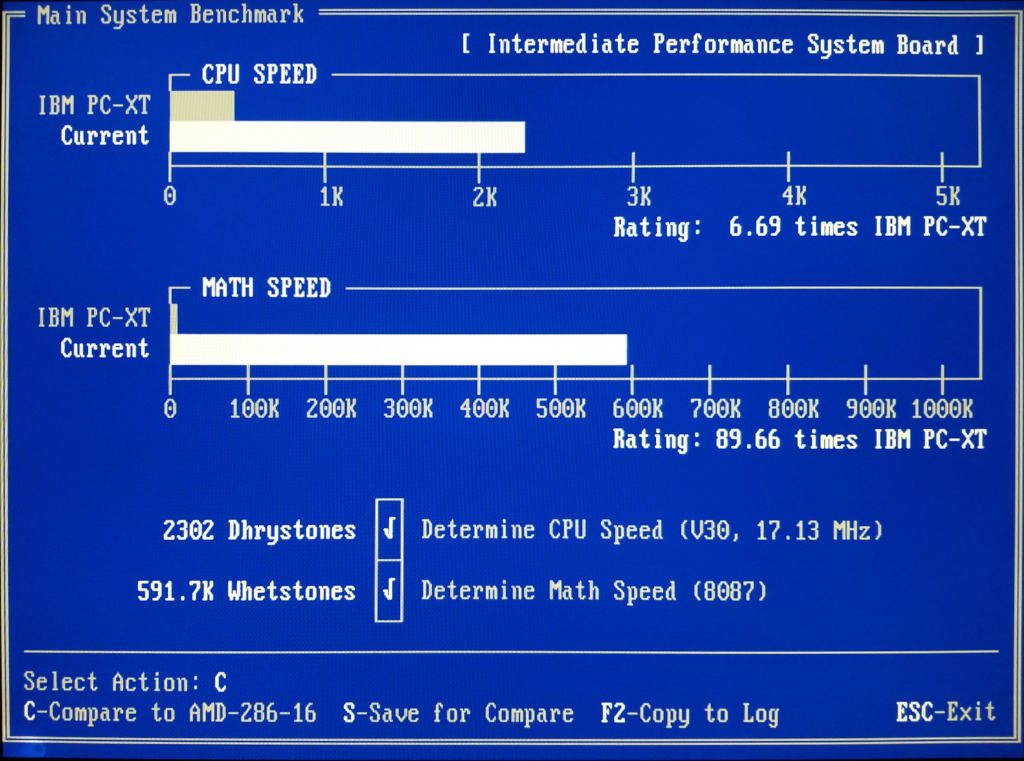

Everything works pretty well at up to 17.13MHz. That is a 51.27MHz crystal oscillator.
Took quite an effort to get there.
Anything above that results in no lights.
Here is what happens at 17.13 / 51.27 MHz:
And a test run video with Dune 2, Monkey Island, LHX, Wolf3D, Autodesk Chaos, Deluxe Paint 2 (demonstrating high 8-bit art with mouse from uncomfortable pose), LM6, CheckIt3.
Wolf3D has corrupted graphics. This is not related to overclocking but the 8086 hack itself seems to be flaky.
Had to restart with mouse driver turned off - it affects some of the tests - hardware is that weak. 😀

Reply 989 of 2351, by maxtherabbit
If you are going to remote the oscillator, you should really use mini coax
Reply 990 of 2351, by BitWrangler
Fun machine! My Turbo XT project is very much back burner until more parts accumulate.... where accumulate means they get together in a staging area rather than being in parts unknown of basement and storage. I might not buy anything, but that XTIDE CF card looks tempting. Possibly going SCSI route, but it remains to be seen if I have enough parts for that to be viable. For RAM all I care about for XT class is getting a few UMBs available for shunting drivers into, all the action happens in the lower 640.. though I might try those mods/tricks to shove base ram up to 704 or something. You can get a genuine EMS card and it will be useful for some apps, and one or two games take advantage, but in general it's a huge PITA once you try to run stuff past about 1991, because then it all goes, "Oh, you have an EMM driver, it must be EMM386 **CRASH**"
Reply 991 of 2351, by pshipkov
@maxtherabbit
Give me more details please.
@BitWrangler
I am going to simplify your statement about RAM cards - they are PITA for little gain. Period.
retro bits and bytes
Reply 992 of 2351, by maxtherabbit
The high frequency signal from the oscillator can quite easily couple into other things. I would suggest running 2 normal wires (+5/gnd) and also one length of mini-coax with the center conductor connected to signal out and the shield tied to ground.
Something like this:
https://www.showmecables.com/by-category/bulk … c-sub-miniature

Reply 994 of 2351, by pshipkov
Thanks Max.
So far i don't notice any difference between the 3 sockets for the crystal oscillator - the on-board one, the inside the case one, or the external.
Still, adding a note to my to-do list.
