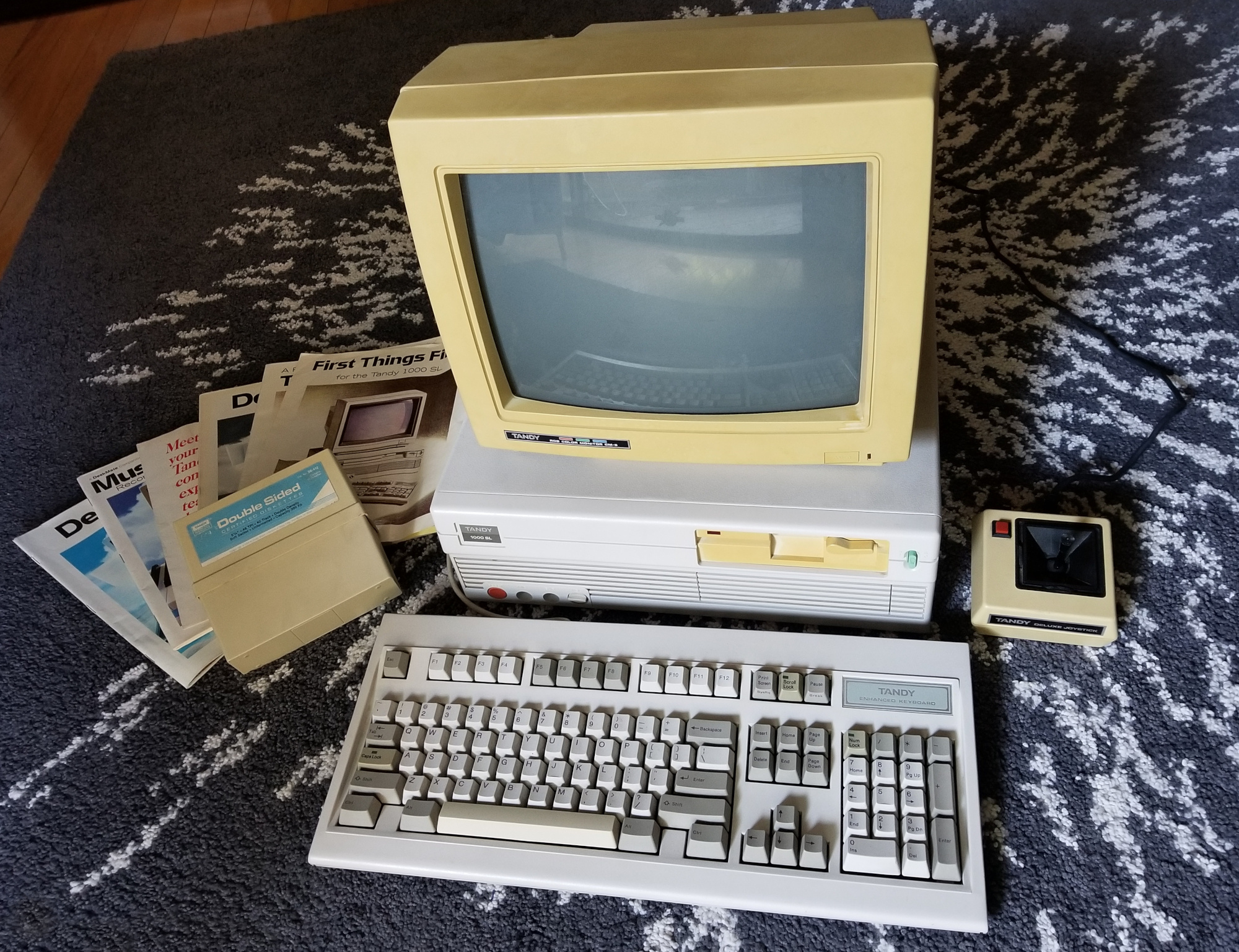

Managed to obtain the full package not far ago.

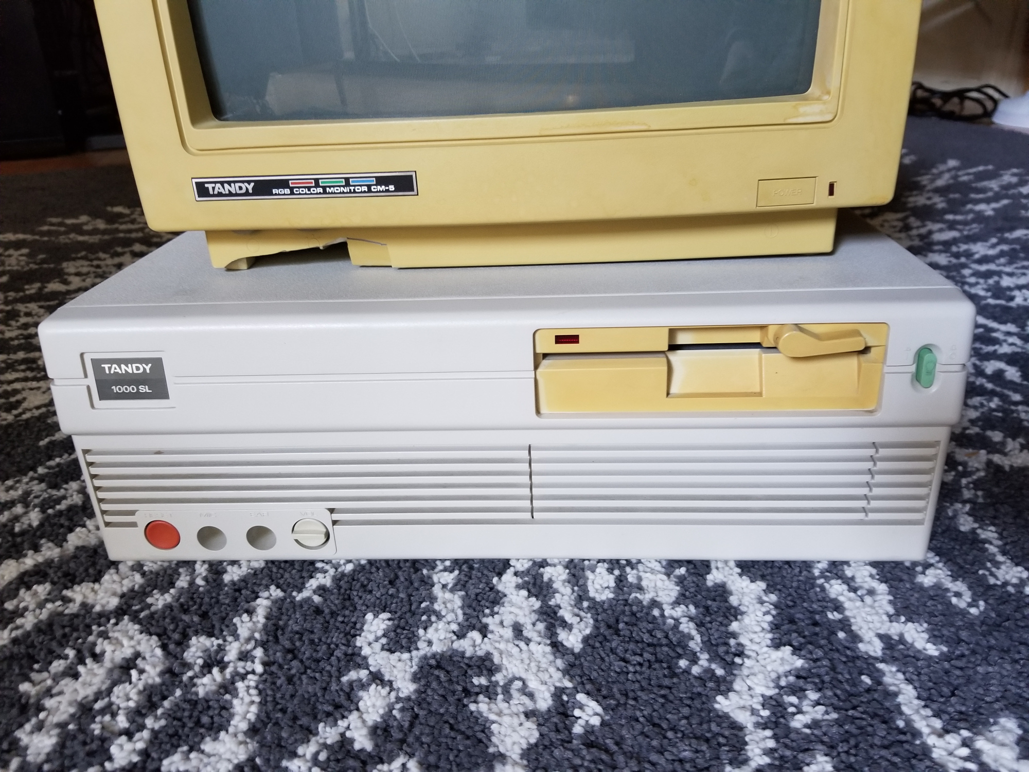

On the outside (before whitening - covered in following posts):
Monitor damage during transit to here. 🙁
(Fixed it later with custom 3D printed pieces and matched paint color.)

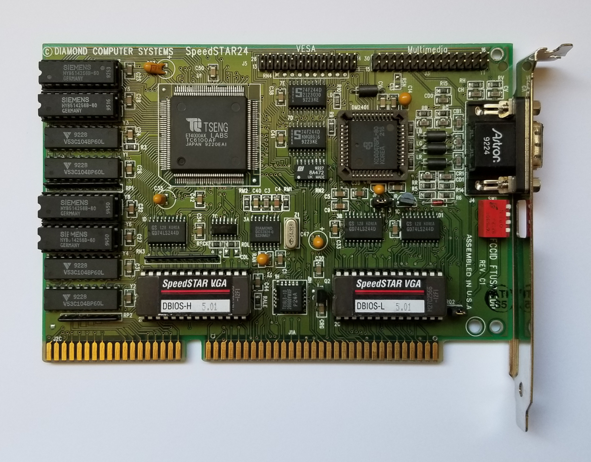

Latest model Diamond SpeedSTAR24 - with those surface mounted components. This one is with 8-bpp RAMDAC.
Grossly overpowered for the host machine. May downgrade to something more appropriate.
Have several pre-90 ISAs. Will see which one fits best.

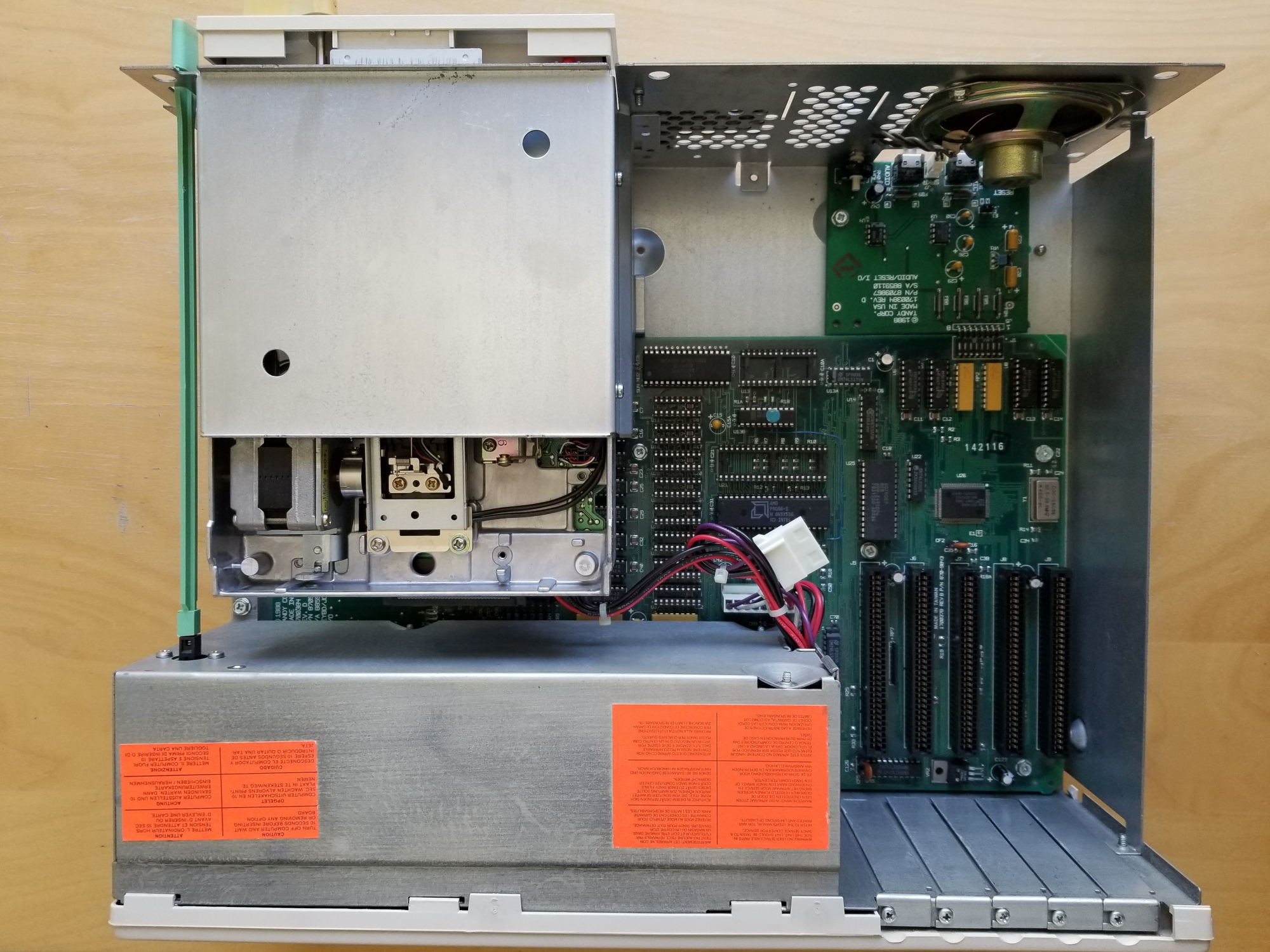

On the inside - barebone - leaves a lot of room for improvements, which is great since journey is the mission.

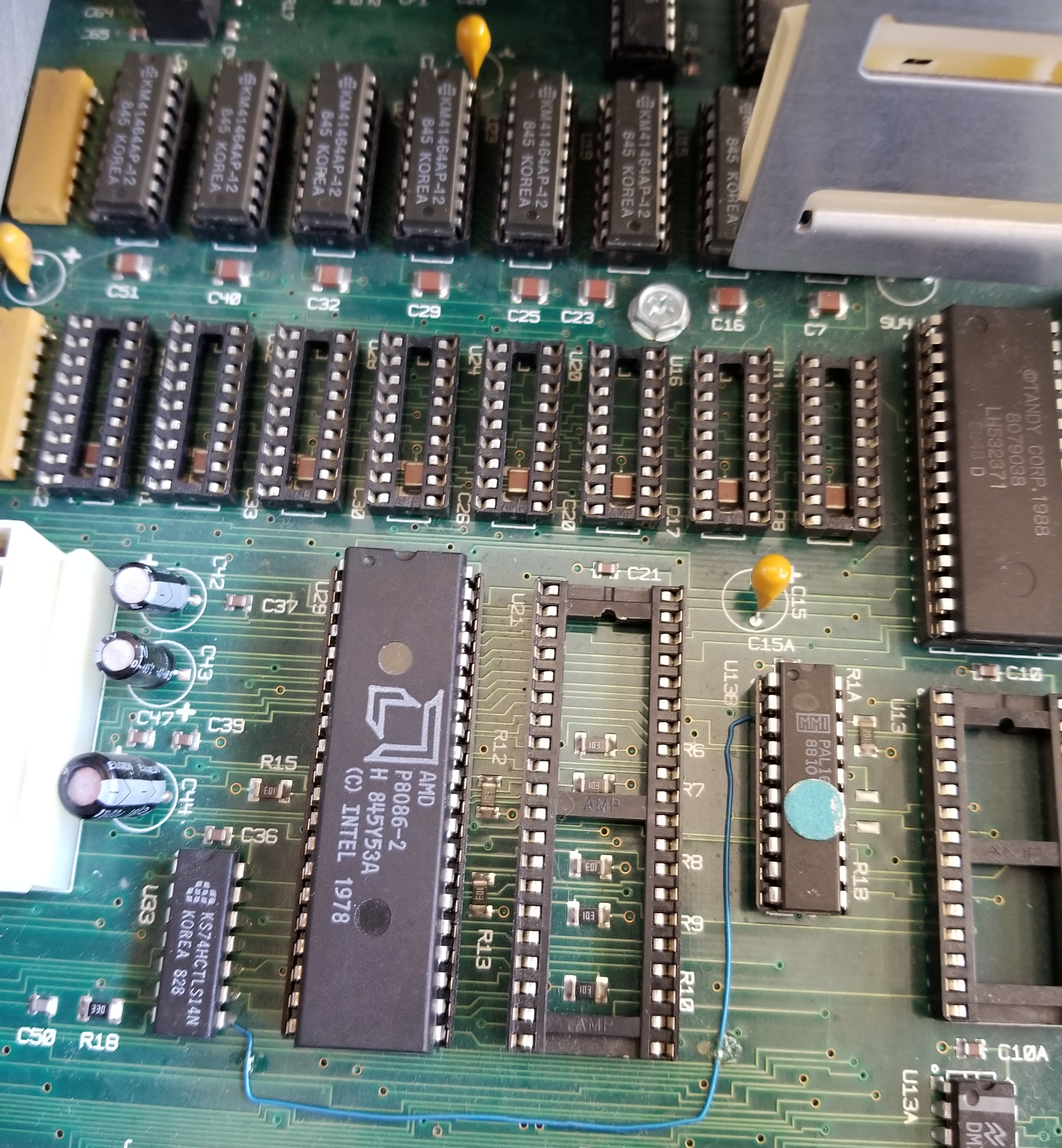

All PCBs have this factory fix with the blue wire.
Needs thorough cleaning. Did it later.

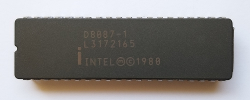

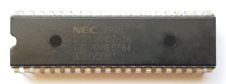

CPU: 16MHz rated NEC V30 HL:
FPU: 10MHz rated Intel 8087:

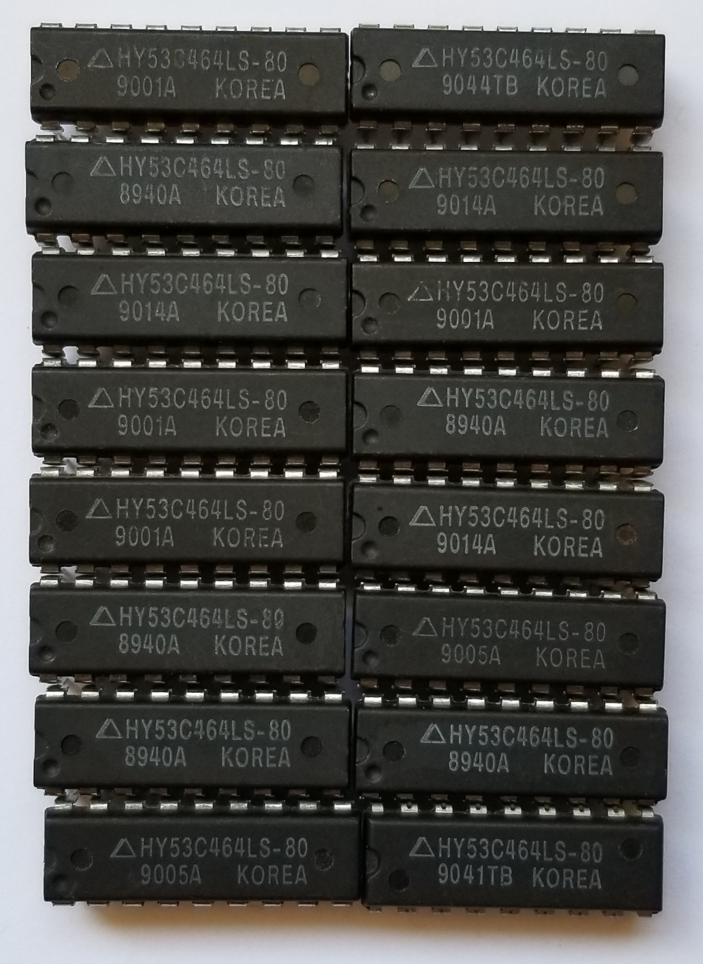

RAM: 80ns rated 640Kb:

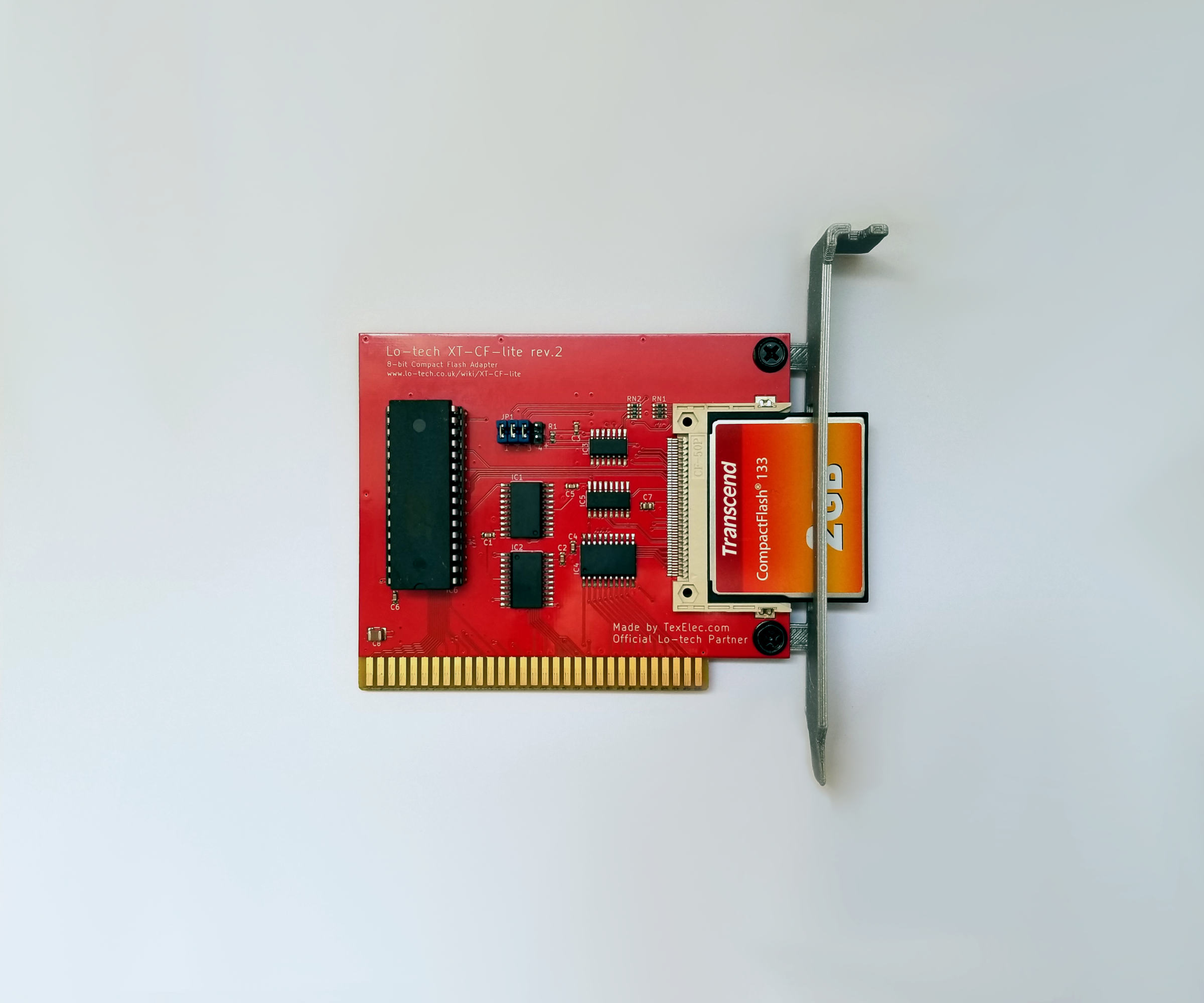

HDDs are inconvenient now-a-days, especially "standard" stuff like Tandy's hard card.
Lo-tech XT-CF-lite rev.2 takes the lead.
Not sure about the red color ...

While the PC case is sustained its color, the monitor and floppy have this Tabaco shade that may need treatment.
Tried briefly last night the XT-IDE card - BIOS menu does not show up on screen.
Verified the card is functional in 486 PC, so some issue with memory addresses.
Will be looking at this over the weekend.
Probably need to switch the boot from DISKMATE to MS-DOS.

Soldered Crystal Oscillator sockets.
Swapped the memory chips, CPU and FPU.

Disabled Deskmate. Switched BIOS to boot from HDD into MS-DOS. XT-IDE adapter worked right away.
Few minutes later the system was ticking at 16.7 MHz - "brutally fast". I'll take it.
Can boot with 55MHz oscillator but with 320Kb RAM only. Need to curate the chips as well.
