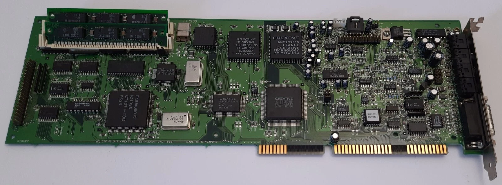

This is my hardware
• Cirrus Logic. CL-GD54M30-I-QC-A.
•PENTIUM 1 166MHZ MMX
•32MB RAM EDO.
•SOUND BLASTER VIBRA 16C CT2960 (working)
•PLACA BASE P5V30-B4 V2.1.
I recently installed an awe32 and it is not recognized by win95 or win98 with their drivers and apparently not even by the hardware. This was used years ago on another PC and worked without problems.
When i touch the EMU8000 chip it is very hot, but it does not burn.
I restored the default parameters of the BIOS, installed the drivers from the original win95 cd, changed the jumpers in all possibilities, disconnected the ram as well. On the first start with win95, already installed, win95 detected a port but never installed sound drivers.
Thanks
Example image
Reply 2 of 10, by PD2JK
I had the same problem with this card.
All I had to do was to clean the ISA contacts with some alcohol. I think you can use contact cleaner like deoxit as well.
The Emu8k chip gets hot, I added a heatsink just for longevity of the card. But it's not necessary.
Hope you get it to run!

Reply 3 of 10, by georgel
Some actual pictures of the problematic card instead of "example" picture might have helped more. Most people here know how CT3980 looks and probably we have it too.
Reply 4 of 10, by ux-3
Did you get the card to run in DOS first? CTCM/CTCU?
